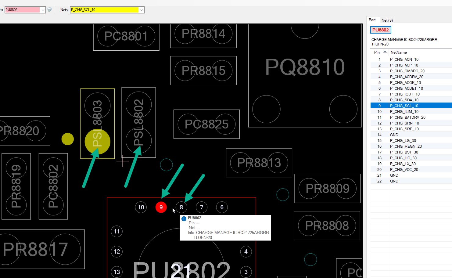

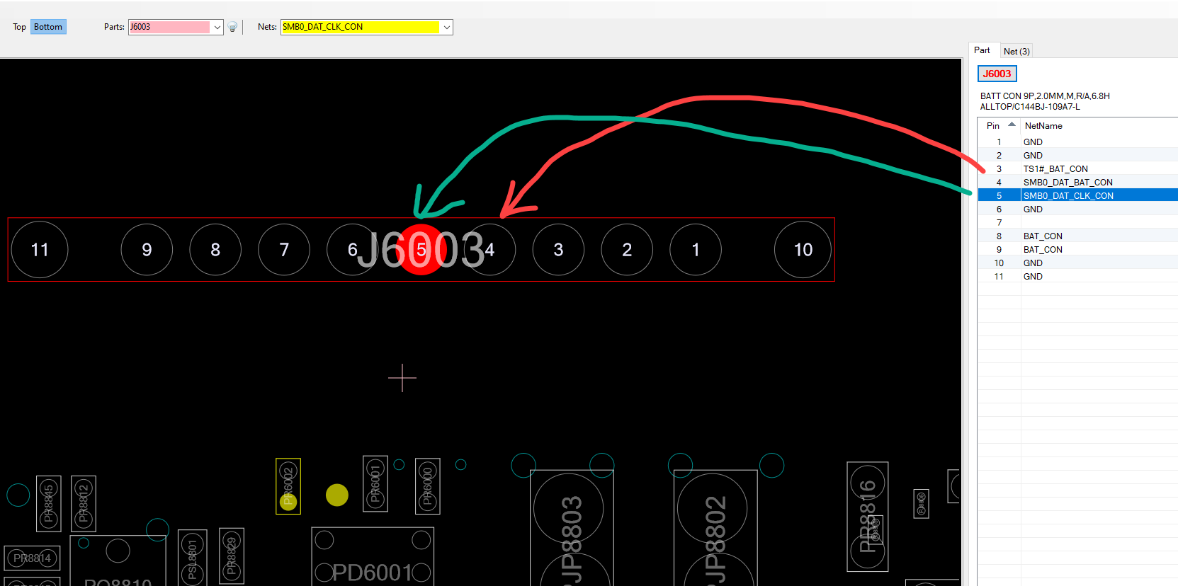

        but it is stuck at 71.2%
        This value does not go down with normal use of the battery and also does not increase while the ac adapter is supposed to be charging ?
        If you see the charging graphic then the charger IC is being instructed to perform this task - that is a good sign.
        If you remove the ac adapter, the charging symbol changes to normal battery graphic ? That is expected and again a good sign. Confirm this.
        We can check the mosfets after the SMBUS interface review...
        Review immediately the voltage on pins # 8 & 9 of the charger IC PU8802.
        You can measure at the points showing in the attachment. It is important that the charger IC be properly soldered so the connection is being made to this charger IC.
        Next, remove all power & no battery. Meter in resistance mode.
        Check the resistance between (SCL) J6003 (pin # 5) & PSL8803 (pin # 1) - this should be ~330 ohms. Confirm it.
        Repeat with (SDA) J6003 (pin # 4) & PSL8802 (pin # 1) - should be ~330 ohms. Confirm it.
        Is PD6001 soldered on your logic board ? This should be a 6 leg SMD ESD diode array component.
        Confirm the voltages on pins J6003, pin # 4 & 5.
