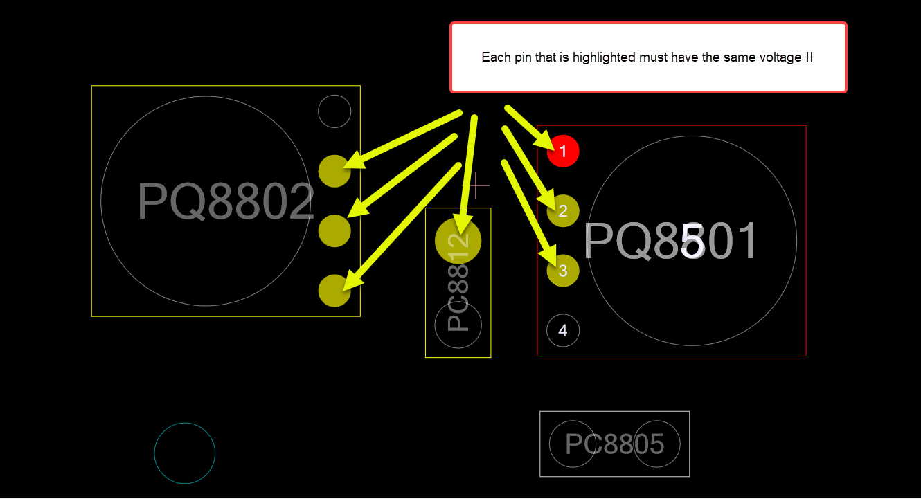

    See attached.
    Interested in the voltage reading at the yellow arrow & with black meter probe to ground.
    Then check again at the PU8802 IC to be sure the voltage is the same.
    When the external power adapter is connected, a safe voltage should be present at the yellow arrows to inform the charger IC that the adapter is connected.
    Only then will the MOSFETS turn on through the gate voltages of each.

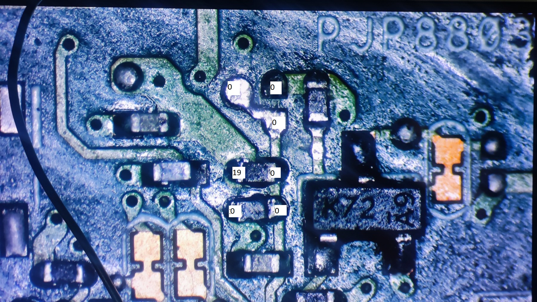

      Did what you asked again.
      PIN - 6 in PU8802 still 0.00 voltage.
      Also i am attaching photo of the voltages around the parts you toldme .

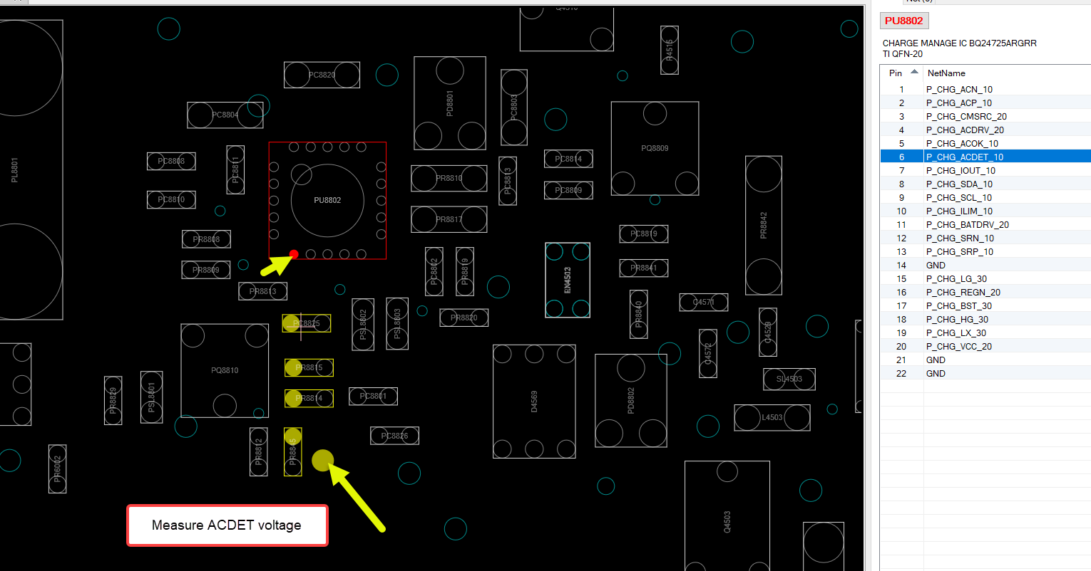

        See attached.

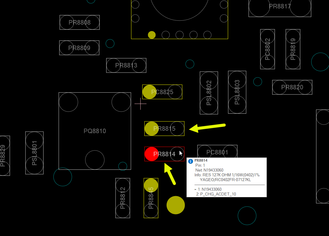

        Believe that PR8814 & PR8815 are the ACDET resistors.
        Carefully apply the ac adapter and measure the voltage on PR8814.
        What voltage reading do you see on each side of the pin ?
            if you don't mean that.
            Then you can see above in the picture the exact values i get to those resistors. I have image attached in my last message.

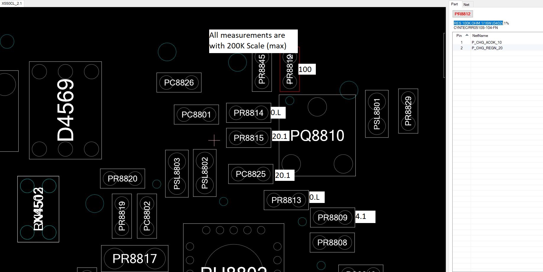

              Ok.
              No injection. I meant for you to power up the board with the normal power adapter for this laptop.
              Remove all power.
              Meter in resistance mode (200k or higher scale).
              Measure the resistance of PR8814. What is the measurement ? This resistor is the one where you show 19v on one side and 0v on the other side.
              Then check the resistance of PR8815.
              Post each measurement. No power while you measure resistance.
              I think that PR8814 is defective.

                Done.
                See the attachment below.

                  PR8814 is defective. It should measure to be 127K in resistance. That is the value showing in the boardview file. It should not be OL on the 200k scale of your meter.
                  Locate a 127K 0402 size 1% tolerance resistor to replace PR8814.
                  Carefully flux and replace this resistor on your logic board.
                  Then test again. If all goes well, you should measure 19v on one side of PR8814 and ~2v6 or so on the other side, not 0v like you have now.

                    Can you confirm if the charger IC has been replaced or is it the original?
                    If replaced, how is the soldering?
                    Confirm the resistance to ground of pin #6 (ACDET) of the charger IC.
                    Remove all power. Meter in resistance mode.
                    Check pin #6 to ground resistance.
                    Post the measurement. This extra test is to confirm the charger IC is not shorted on pin #6 which then implies that PR8814 is defective and has to be replaced.
                    You should also desolder PR8814 off the logic board and check it's resistance while off the board. If you measure 127K then the fault is still on the logic board.

                        removed the resistor , you said and it showed 0.L.
                        Which meter scale? 200k ?
                        If yes, this resistor is defective and must be replaced.
                        This measurement should be 127 on the 200k meter resistance scale.
