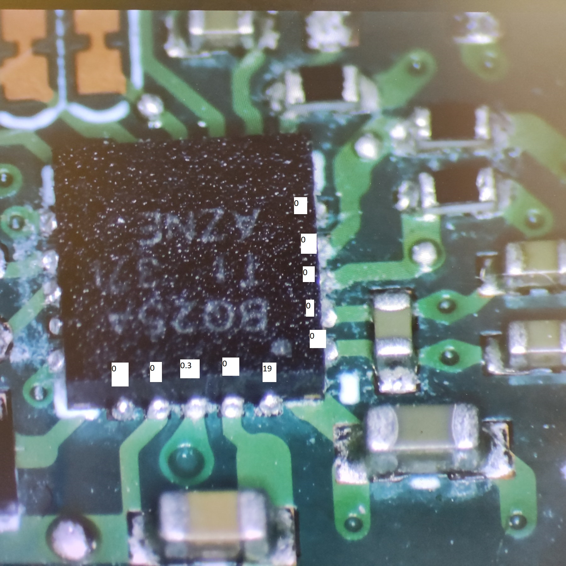

    I think , that i have replied to anything that matters on the mosfets ? (both of them) .
    Power (19V) doesn't go from MOSFET 1 to MOSFET 2. But the line between the 2 is clean and connected.
    Now,the 19V come to the first MOSFET but "never" leave this MOSFET ( even with the replacements ).
    So the 2nd MOSFET , to the pins that SHOULD Have 19V doesn't have any Voltage.

        As i said , above. There is NO other, voltage shown in the meter.
        Mosfet one , 19V comes in (single pad).
        Never leaves the "mosfet"
        Mosfet two , nothing comes on it.
        If you see above the pictures are shown what is coming ,and nothing is "going"...
        Even with different mosfet.

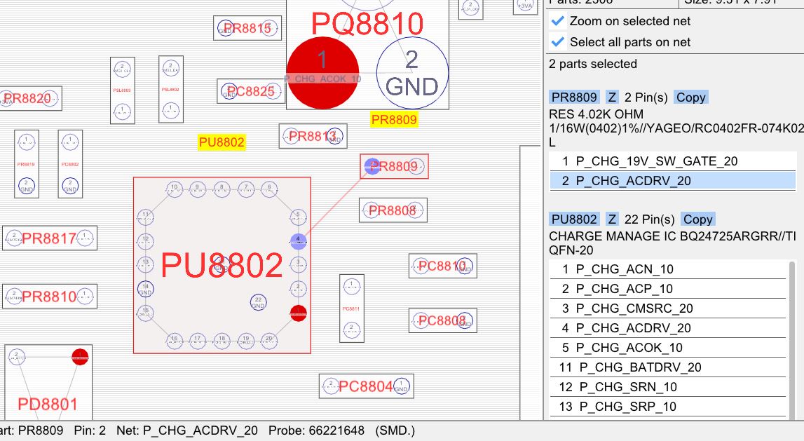

          Measure the voltage on PR8809, both sides.Then with no power test the resistance ,it should measure 4.02K Ohms

            0 voltage on both sides.
            4.11K Ohms resistance.

              Pin 2 connects to PU8802 ,pin 4 .Read the description for pin 4 in the datasheet and tell me what voltage you expect to see on PR8809
              https://www.ti.com/lit/gpn/bq24725a
                Good morning SMD!
                Just checked it.
                Only (Pin 1 has 19volt) all the other are "dead" .
                ( I have the old - factory mosfets which used to work with battery only , just in case i need to explain myself :P )

                        Did it ,again nothing.
                        The strange thing is that the laptop working but the mosfets on the side that we said that they should have 19v ,they still don't have.
                        Even though it's working , i re-tested with new mosfets again doesn't change anything ,and the mosfet still remains dead on the opposite side (both of them)
                        I removed the chip BQ24725ARGRR, just in case its going to change anything but again nothing ,the mosfet keep doing the same thing.
                        What can possible make the mosfet not to create the voltage that should create?

                          You should not start the board up with an IC removed. Why change the mosfets again ? ,the mosfets cannot pass any voltage without voltage on pin 4,it should be 25V ,that voltage comes from PU8802 pin 4.
                          Test PU8802 voltage on pin 6 and look at the boardview,see what that pin is connected to,test all resistors,look for corrosion .
                          If you`d prefer to just swap parts then replace PU8802

                            From battery the laptop turns on , detects the battery , but it doens't charge, if you remove it ,it doesn't turn on.
                            You are saying that PIN4 on the PU8802 ,should be 25V ?

                                        Review the voltage of ACDET pin on PU8802 -> pin # 6.
                                        What is the reading with the external power adapter connected ?

                                          With MOSFETS on board.
                                          PIN 1 - 19V
                                          PIN 4 - 0,35V
                                          PIN 6 - 0.1V
