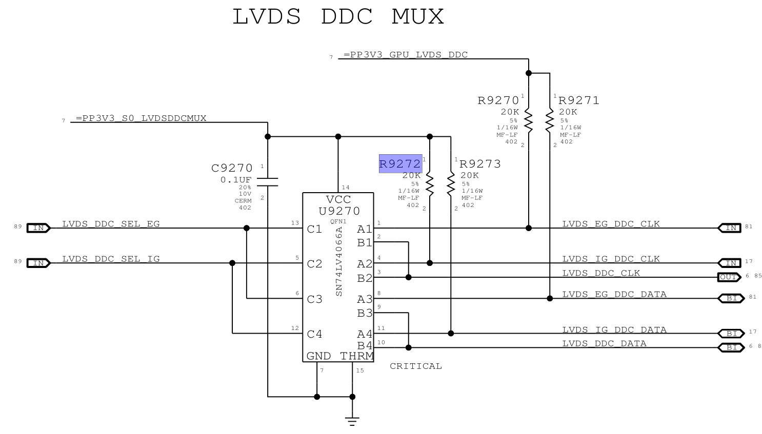

      Are we sure issue is not somewhere else?
      Looking at DDC circuit, LVDS_DDC_CLK at pin 2 of R9011, is reading 0.72 on 20V scale.
      Suggests monitor not detected?

        Re: MacBook Pro A1286 Mid 2012 no power, no LED on the charger
        Ok. This clk is an output from the logic board -> to the LCD screen.
        Trace this signal back to the mux @ U9270.
        What is the voltage @ R9272, pin # 2 ?

            Mon2, pin 2 showing 3.3V.
            But LVDS_DDC_CLK (OUT) showing 0.72V, so is there issue inside this chip U9720 then?
            • mon2
              • Dec 2019
              • 13835
              #86
              Can you confirm if you are measuring pin # 2 reading at the chip U9270 ?
              If yes, that is a good reading, yet pin # 3 = LVDS_DDC_CLK is 0v72 ??
              Pin # 2 and pin # 3 should be at the same voltage level.
              Measure to confirm directly at U9270 and then again at another site on the logic board. Perhaps a trace break ?
              While measuring, what is the voltage on pin # 1 of U9270 ?

                #87
                Sorry mon2, pin 2 with TP LVDS_DDC_CLK! 0.72V confirmed. 0.72V also on pin 3 so looks ok.

                  #88
                  U9270 on pin 1 is 0.72V!
                    Mon2, think then LVDS_EG_DDC_CLK coming from U8000 is low? 0.72V should be higher?
                    This is the cause of the problem?
                      Measure & post the voltage readings of the following:
                      PP3V3_S0_LVDSDDCMUX
                      LVDS_DDC_SEL_EG
                      LVDS_DDC_SEL_IG
                      PP3V3_GPU_LVDS_DDC
                      also adding:
                      PP3V3_S0_DDC_LCD
                      Next, remove all power.
                      With the LCD attached - meter in resistance mode - check the resistance between pins 17 & 18 on the LCD connector. This is the resistance check between:
                      LVDS_CONN_A_CLK_F_N
                      and
                      LVDS_CONN_A_CLK_F_P
                                PP3V3_S0_LVDSDDCMUX at C9270, 3.3 on 20V mode
                                LVDS_DDC_SEL_EG at TP[1] LVDS_DDC_SEL_EG, 3.3 on 20V mode
                                LVDS_DDC_SEL_IG at TP[1] LVDS_DDC_SEL_IG, 00.2 on 200m mode, going to 00.0 to 00.1 back to 00.2
                                PP3V3_GPU_LVDS_DDC at R9270 pin 1, 3.3 on 20V mode
                                PP3V3_S0_DDC_LCD at R9010 pin 1, 3.3 on 20V mode
                                LVDS_CONN_A_CLK_F_N and LVDS_CONN_A_CLK_F_P shows 1 on all modes up to 2m
                                      These are not good readings. There are 2 select signals for the 4066 mux switch, IG and EG.
                                      Be sure to measure both.
                                      One of these must be 3v3 to enable the lcd signals to flow through this analog switch.
                                      Remove the lcd and check again the voltage of the 4066 enables.
                                      If low, the 4066 switch will remain open. If 3v3, the switch will close and the signal will appear at the lcd connector.
                                      Also, when does the logic board work? After you remove only the lcd LVDS cable ?
