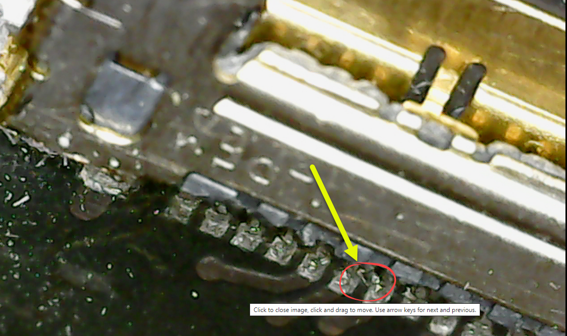

                        #171
                        Re: MacBook Pro A1286 Mid 2012 no power, no LED on the charger
                        Hi mon2,
                        I was able to get pictures of the display connector under the microscope. I show them here for your views.
                        • mon2
                          • Dec 2019
                          • 13830
                          #172
                          While the joints look solid, consider to flux the SMD pads -> low air pressure -> hot air these pads or high recommend to point-to-point touch each pad to reflow each contact.
                          The 2nd picture appears to almost show a potential short but could be my eyes.

                            #173
                            Hi mon2,
                            Sadly I think we will have to admit defeat on this board as I think I damaged the connector pads too much whilst removing it.
                            Board is ruined

                                  #176
                                  There is a lot of flux in the region so cannot see the pads (if they are even there) from the posted pic.
                                  Use Q-tip and alcohol to clean up this area and to confirm if any of the LVDS pads are still present on the board. Post a fresh pic after the IPA cleaning.
                                  • Gigabit2
                                    • Apr 2022
                                    • 264
                                    • United Kingdom
                                    #177
                                    Pads are gone
                                    • Gigabit2
                                      • Apr 2022
                                      • 264
                                      • United Kingdom
                                      #178
                                      This one becomes a donor board.
