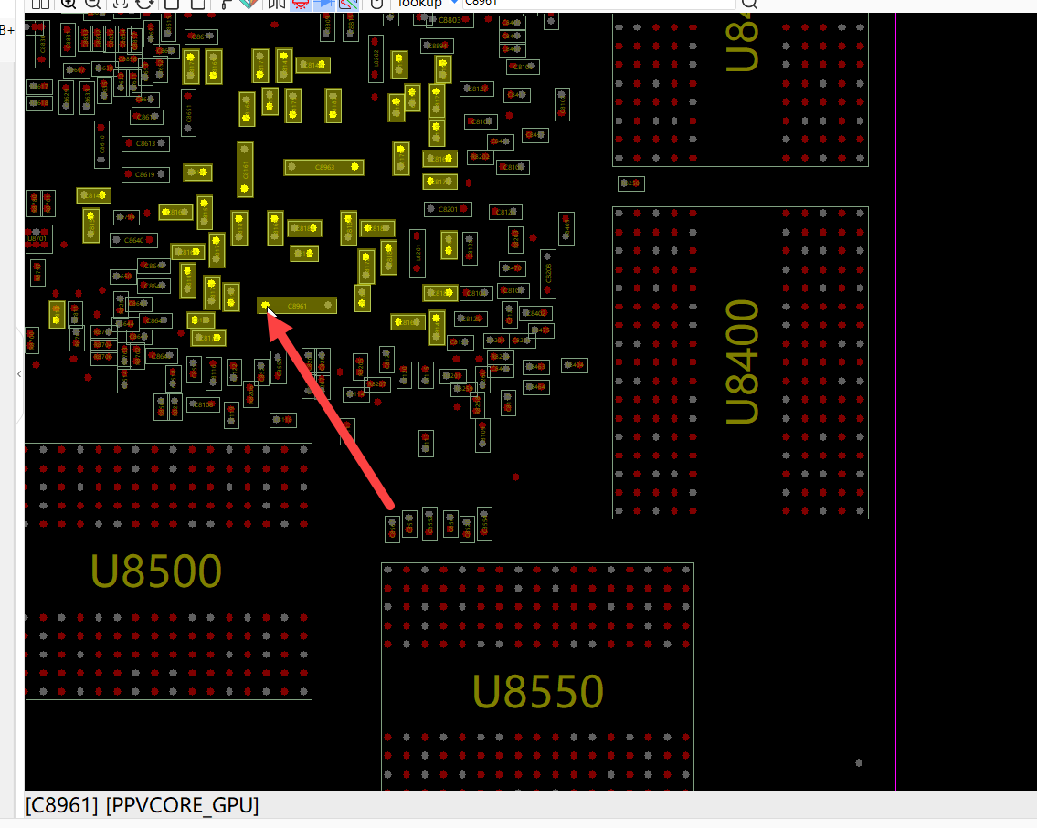

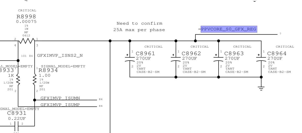

    What is the voltage of PPVCORE_S0_GFX_REG ? (with LCD connected)
    • Gigabit2
      • Apr 2022
      • 264
      • United Kingdom
      #62
      Re: MacBook Pro A1286 Mid 2012 no power, no LED on the charger
      Mon2, with power on?
      • Gigabit2
        • Apr 2022
        • 264
        • United Kingdom
        #63
        Do you have a test point for PPVCORE_S0_GFX_REG?
        • mon2
          • Dec 2019
          • 13830
          #64
          Yes. See attached. Yes, with power on - need to see if the power rail for the GPU is working.
          • Gigabit2
            • Apr 2022
            • 264
            • United Kingdom
            #65
            Measuring 0.89 on 20V mode, tested with C9861, C9862, C9863, C9864, all showing same
            • mon2
              • Dec 2019
              • 13830
              #66

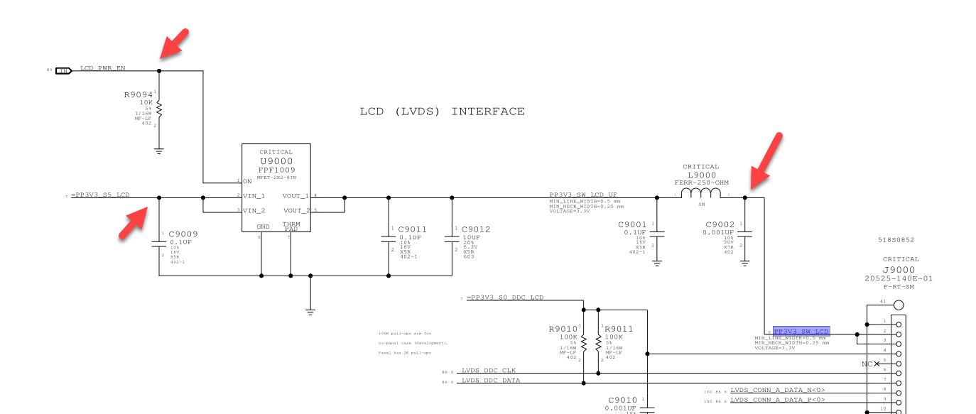

              Voltage for this power rail is OK.
              What are the voltage readings for the following (with LCD & powered on)?
              LCD_PWR_EN
              PP3V3_S5_LCD
              PP3V3_SW_LCD
              See attached.
              • Gigabit2
                • Apr 2022
                • 264
                • United Kingdom
                #67
                LCD_PWR_EN tested at R9094 showing .013 on 2V mode.
                PP3V3_S5_LCD tested at C9009 showing 3.31 on 20V mode.
                PP3V3_SW_LCD tested at C9002 showing 00.2 on 200m mode.

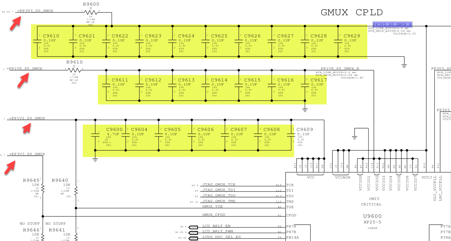

                        What is the power rating of your magsafe power supply that is being used for these tests ?
                        1) Given that this logic no longer posts if the LCD display is attached - the cable or display are strapping the motherboard.
                        2) In reviewing again, page 2 of the schematic, the logic flow is:
                        a) external video is driven by the NVIDIA GPU - if the external video is stable then the GPU is fine as you posted earlier
                        b) the GMUX @ U9600 takes input from the dedicated GPU (NVIDIA) or the INTEL internal video controller and routes it to the LCD connector @ J9000.
                        Post the voltage readings for the following:
                        PP1V2_S0_GMUX
                        PP1V8_S0_GMUX
                        PP3V3_S0_GMUX
                        PP3V3_S0_GMUX_R
                        PP3V3_S3_GMUX
                        GMUX_S3_PD_GND
                        ALL_SYS_PWRGD
                        LCD_BKLT_PWM (before R9704)
                        BKL_PWM (after R9704)
                        See attached for reference. You can measure at any of the highlighted parts for the respective power rail.
                        Confirm the resistance of resistor @ R9714. This resistor value is critical to configure the max current that the backlight power supply will support for the boosted power rail.
                        • Gigabit2
                          • Apr 2022
                          • 264
                          • United Kingdom
                          #72
                          Hi mon2,
                          It is 85W. Also used another adapter and a USB-C to MagSafe converter connected to an 85W supply and the same issue occurs.
                          PP1V2_S0_GMUX: 1.2V with 20V mode
                          PP1V8_S0_GMUX: 1.8V with 20V mode
                          PP3V3_S0_GMUX: 3.32V with 20V mode
                          PP3V3_S0_GMUX_R: 3.32V with 20V mode
                          PP3V3_S3_GMUX: 3.32V with 20V mode
                          GMUX_S3_PD_GND: 2.64V with 20V mode
                          ALL_SYS_PWRGD: 3.28V with 20V mode
                          LCD_BKLT_PWM (before R9704): 0.08 with 200m mode
                          BKL_PWM (after R9704): 0.08 with 200m mode
                          Resistance of resistor @ R9714: 16.1 with 200k mode

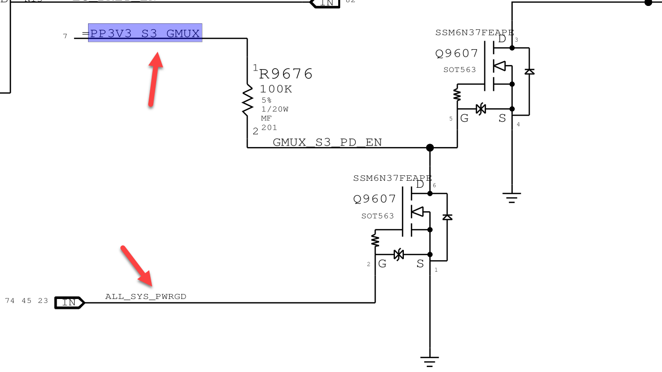

                            Post the voltage on each side of R9676.
                            • Gigabit2
                              • Apr 2022
                              • 264
                              • United Kingdom
                              #74
                              Pin 1: 3.32 with 20V mode
                              Pin 2: 00.5 with 200m mode
                              • mon2
                                • Dec 2019
                                • 13830
                                #75

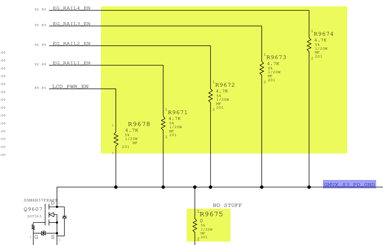

                                In the 2nd pic above, there are numerous resistors in the schematic.
                                Measure and post the voltage readings on each side of the resistors.
                                Be very careful as the parts are small.
                                From a similar thread on Louis' forum, the GMUX_S3_PD_GND value on your board is low as compared to another tech who reported 3v0.
                                • Gigabit2
                                  • Apr 2022
                                  • 264
                                  • United Kingdom
                                  #76
                                  R9678
                                  Pin 1: 0.13 with 200m mode
                                  Pin 2: 2.65 with 20V mode
                                  R9671
                                  Pin 2: 2.64 with 20V mode
                                  R9672
                                  R9673
                                  Pin 1: 3.31 with 20V mode
                                  R9674
                                  R9675 - not present
                                  2.64 on one side with 20V mode, 0.00 on other (as expected with nothing present)

                                        @mon2, is there no issue with R9678? Not boosting to 3.32V, as other resistors are?
                                        • mon2
                                          • Dec 2019
                                          • 13830
                                          #80
                                          No, R9678 is ok but is an output enable signal from the mux chip by Lattice (U9600). The output is low.
