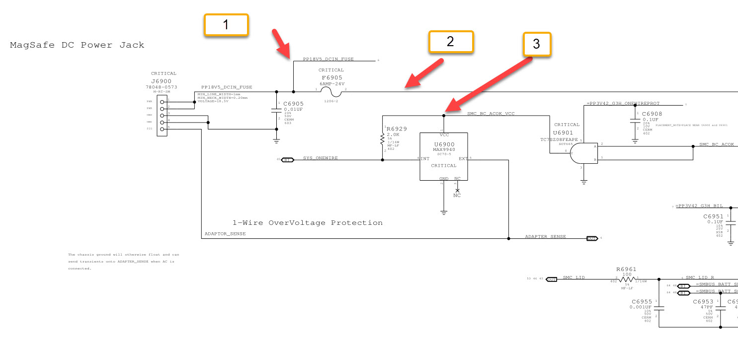

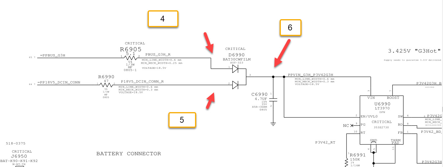

        Re: MacBook Pro A1286 Mid 2012 no power, no LED on the charger
        Hi.
        See attached. Post the voltage readings for these points with the external power adapter attached.
          Hi mon2,
          Great news, I replaced the MagSafe DC in board and system now turning on with bong!
          Sadly, no backlight on the display - have shined light from phone and can see screen, so looks like backlight issue once again?
          Can you help?
