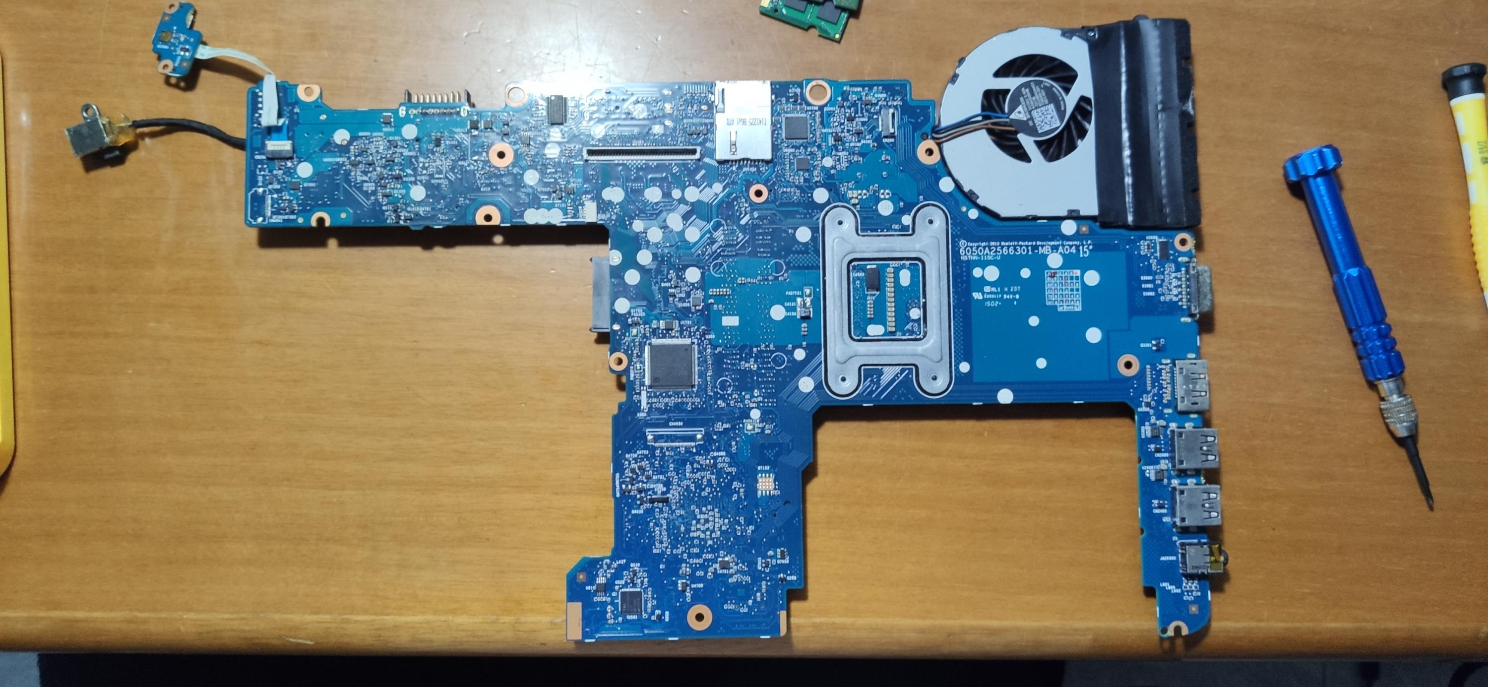

    Hi everyone, I have a problem with this laptop Hp probook 650 G1. Today it decides to not charge the battery anymore.. The pc works fine but the battery does not take the charge. I had the exact same problem 3 months ago. 3 months ago I "solved" just totally disassembly it and then magically it starts to go normaly. Now i tried to unplug the ram modules, the main battery, the bios battery ( doing a clear cmos shorting the 2 pins ). Unplugged everything I press for 30sec the power botton, then plug one ram module, plug the battery and try to restart but same issue, the battery does not take any charge. I notice that the problems comes when I leave the pc in suspension for a long time (about 1 day), it can be the problem?
    Thank you

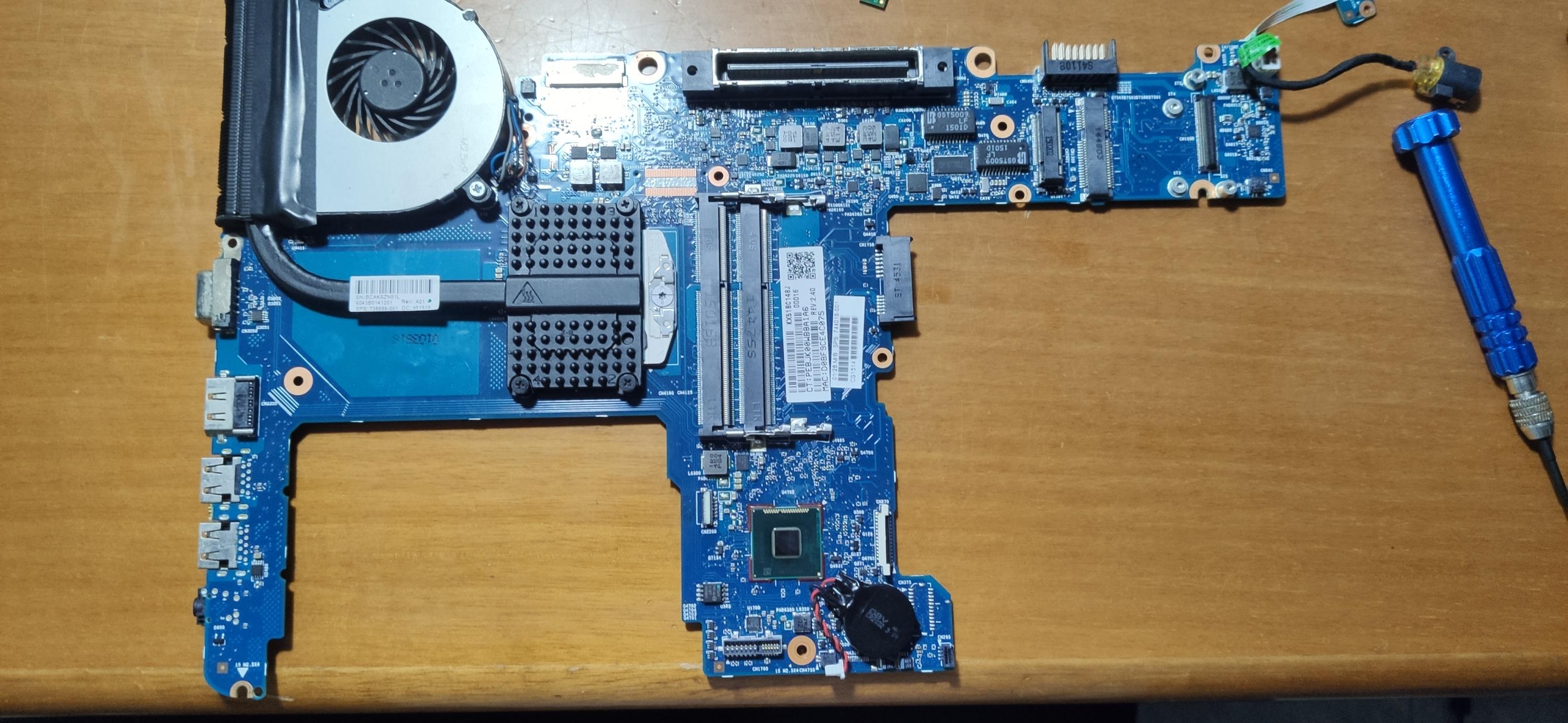

                        Share any pics / white silk screen markings on the logic board so we can locate possible schematics for a deeper review. PICs are best.
                        Remove all power. Locate where the DCIN power connector is located. This trail should follow with 2 mosfet devices and a local charger IC that is used to charge the local battery. You can share pics on this forum to help.
                        Once the mosfets are found, with NO power (no battery), meter in lowest resistance mode - we can check if the mosfets are defective.
                        Often the mosfets are 8 leads (4 on each side).
                        The pinout for the mosfets are usually common - proceed to check the resistance between:
                        source (1-2-3) & drain (5-6-7-8)
                        source (1-2-3) & gate (4)
                        gate (4) & drain (5-6-7-8)
                        We are looking for a low resistance in the readings which means the mosfet is defective / shorted and must be replaced. If you see '1' or 'OL', this means the meter scale is too low so increase till you have a reading.
                        Share the readings & meter scale for each for the next review.
                        Do measure both of the front side mosfets. It is very common to have defective mosfets in this region of the logic board.
                        PS: I am assuming that you are using the official and suitable power adapter for this logic board ? What is the output voltage ?
                        Do post the markings of the charger IC so we can locate a datasheet (if it exists). Then a reference schematic of the charger IC will educate us on how the logic board is most likely wired for this portion of the design.
                        Till then, need to cut my overgrown lawn - (not) a favourite past time

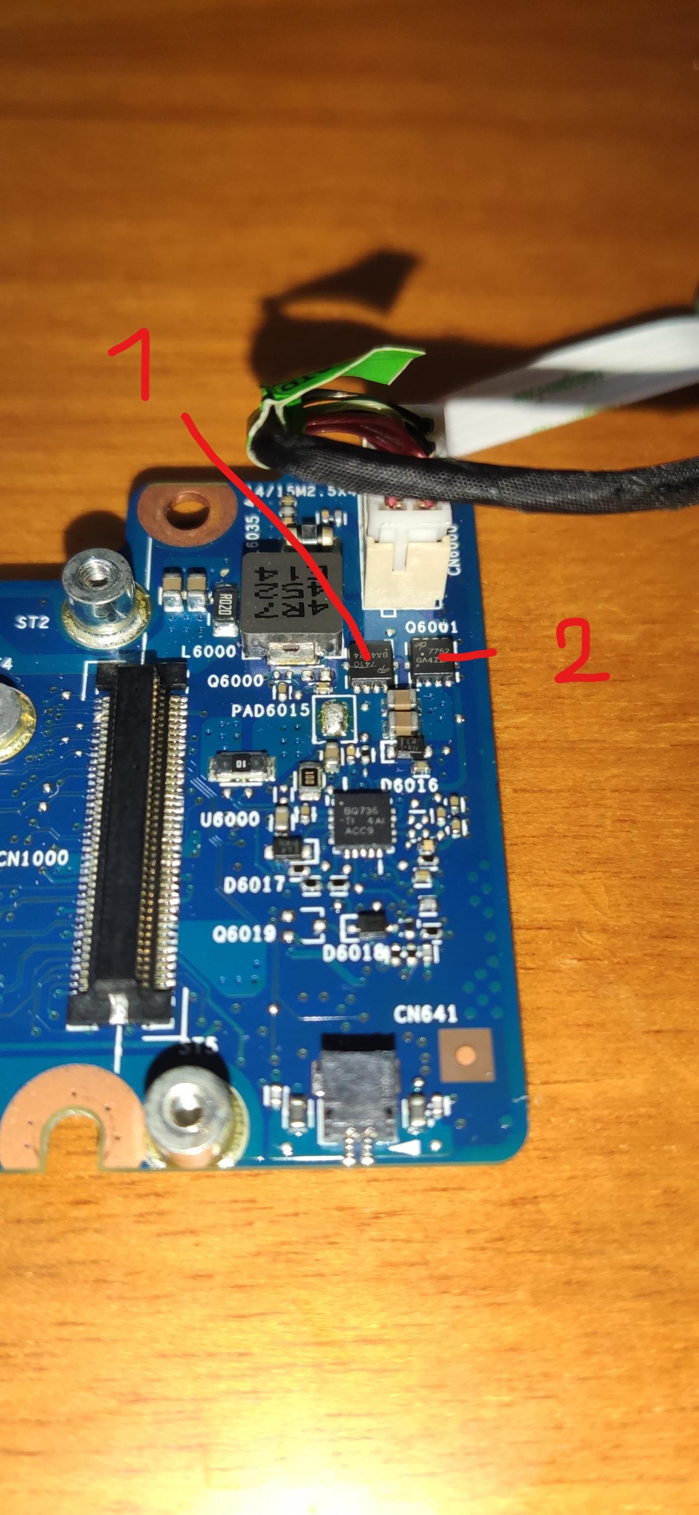

                                    Re: Hp probook g1 650 does not charge
                                    Originally posted by mon2
                                    Review my post #12.
                                    Measure and post the resistance of each mosfet. No power when measuring the resistance.
                                    Here the mesures
                                    1
                                    S-D 52 kOHM UP TO 0L
                                    S-G 208 KOHM
                                    G-D 1,2 MOHM
                                    2
                                    S-D 30 kOHM UP TO 1 MOHM
                                    S-G 202 KOHM
                                    G-D 146 KOHM
                                    3
                                    S-D 20 kOHM UP TO 20 MOHM
                                    S-G 3,8 MOHM
                                    G-D 510 MOHM
                                    4
                                    S-D 1,5 MOHM
                                    S-G 2 MOHM
                                    G-D 270 KOHM
                                    The mesures seems to be good, isn't it? No low resistance
                                    • mon2
                                      • Dec 2019
                                      • 14664
                                      In my opinion, mosfets @ 1, 2 and 4 have low resistance with the Kohm readings.
                                      They are very inexpensive - consider to replace each and test again.
                                      Post the markings on the topside of each for a review of which devices are on this logic board. Very likely, you can replace with other mosfets.

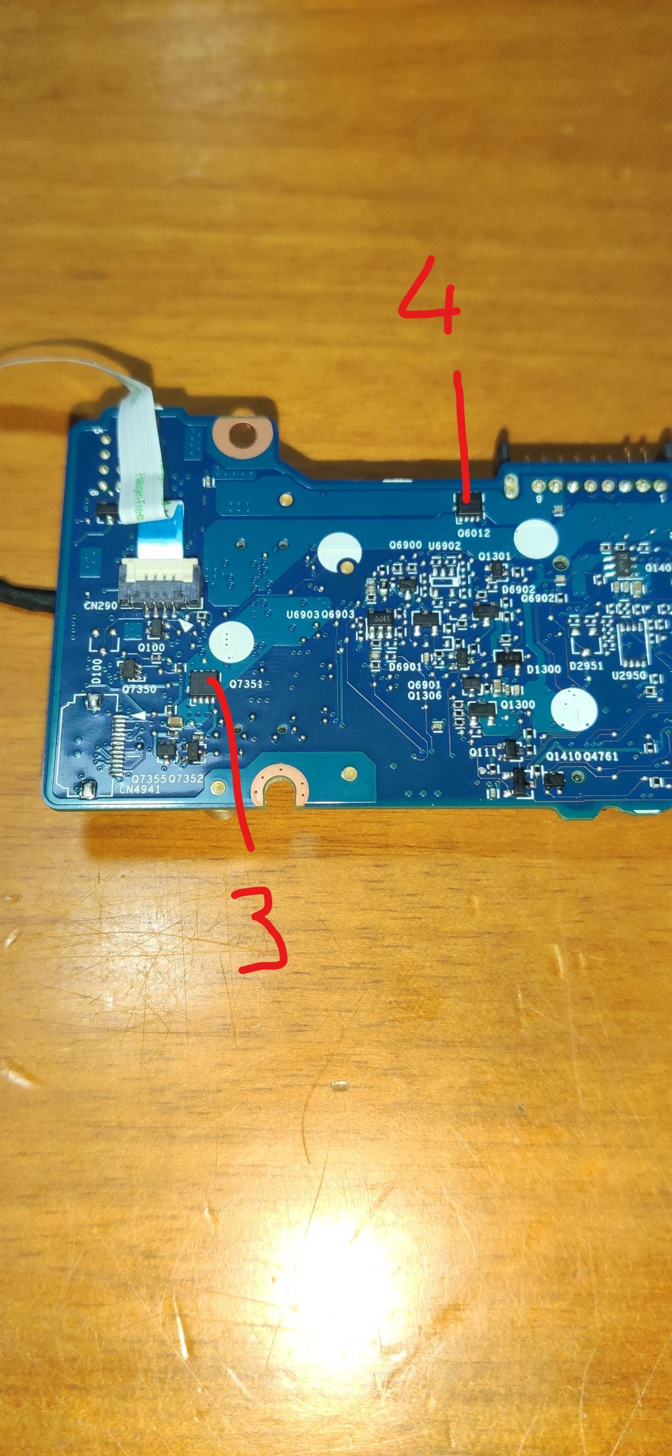

                                      • giulio93
                                        • Aug 2021
                                        • 258
                                        • Italy
                                        If thought if the mosfets were shorted the ohm values should be 0, not in Kohm
                                        mosfet
                                        1 is a 7410 BA4324
                                        2 is a 7752 GA4Z2P
                                        3 is a E100BN
                                        4 is a 7410 GA4127
