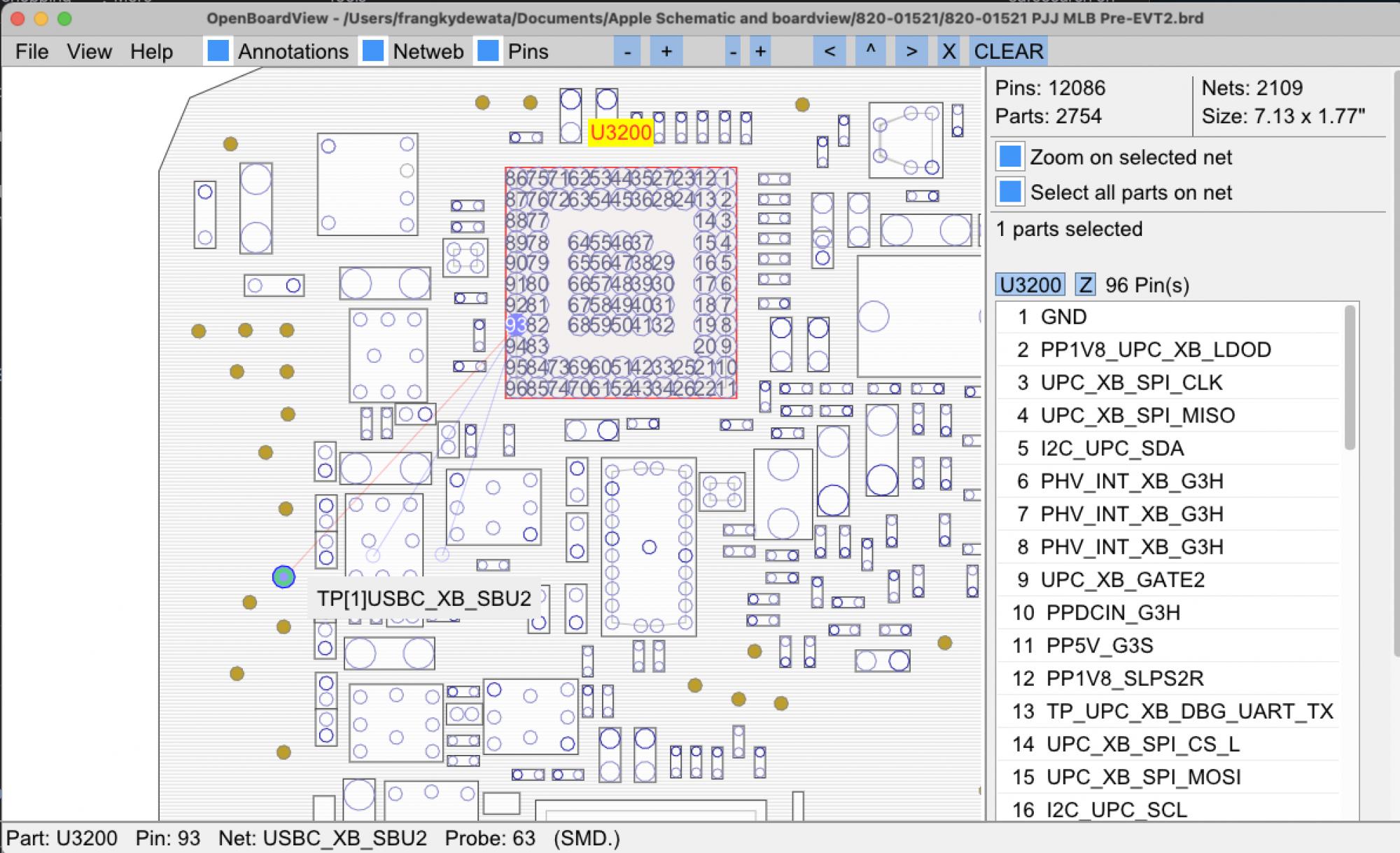

                              Re: 820-01521 only shows 5V 0.04A
                              any suggestions?
                              • mon2
                                • Dec 2019
                                • 14664
                                SBC_XB_SBU2 = 0L
                                Is not correct for this diode reading. Can you check again?
                                It should be about 0.65.
                                Check also
                                USBC_XB_SBU1
                                USBC_XA_SBU1
                                USBC_XA_SBU2
                                • kingskie
                                  • Oct 2014
                                  • 249
                                  • indonesia
                                  Originally posted by mon2
                                  SBC_XB_SBU2 = 0L
                                  Check also
                                  USBC_XB_SBU1
                                  USBC_XA_SBU1
                                  USBC_XA_SBU2
                                  i checked USBC_XB_SBU2 from the test point that i attached still OL
                                  USBC_XB_SBU1 = OL
                                  USBC_XA_SBU1 = OL
                                  USBC_XA_SBU2 = OL

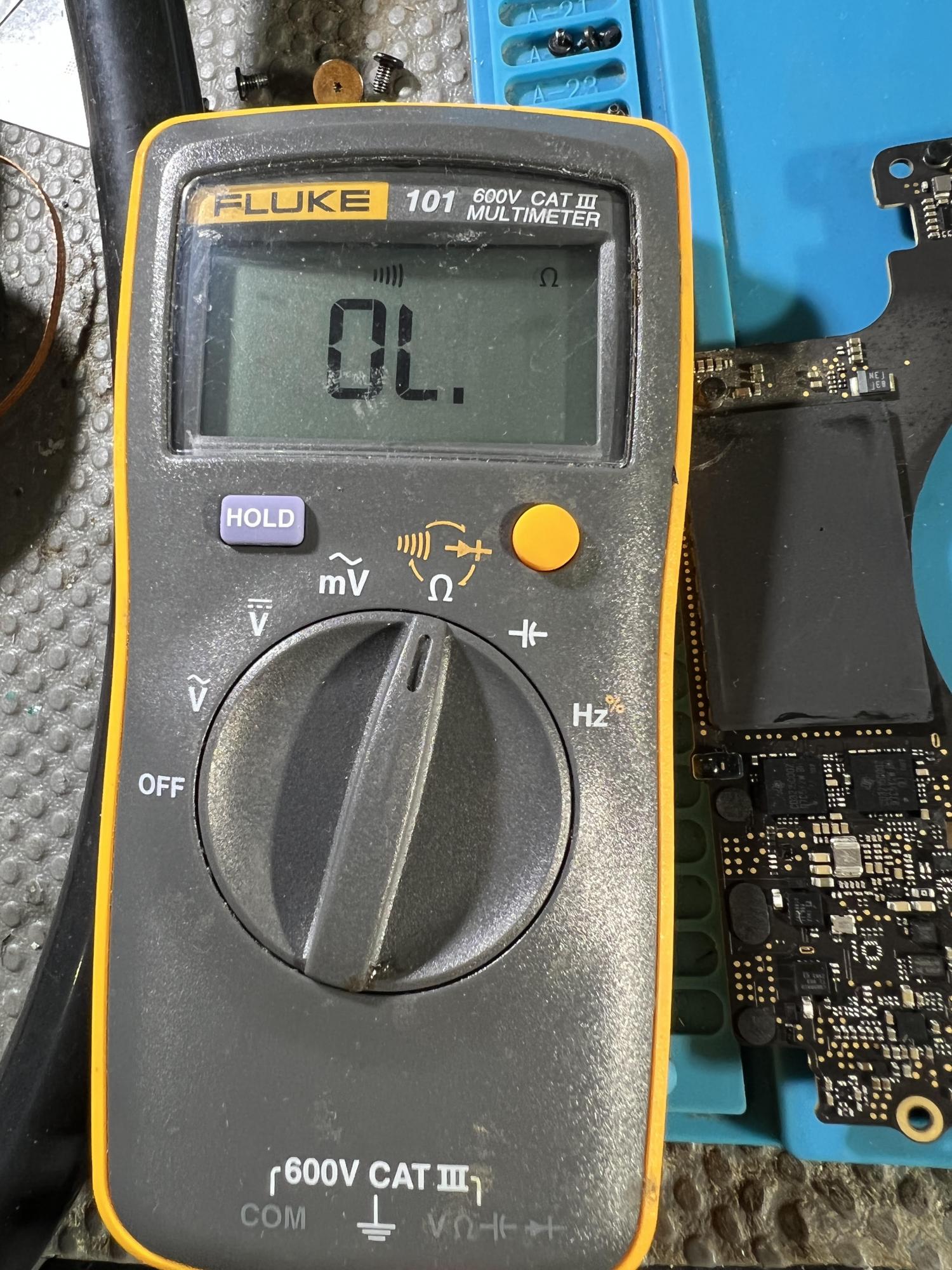

                                  • mon2
                                    • Dec 2019
                                    • 14664
                                    Post a pic of your multimeter so we can confirm the diode mode setting.
                                    • kingskie
                                      • Oct 2014
                                      • 249
                                      • indonesia
                                      this is my multimeter
                                      • mon2
                                        • Dec 2019
                                        • 14664
                                        You are in ohms mode.
                                        Press the yellow button till you see the diode symbol and measure again.
