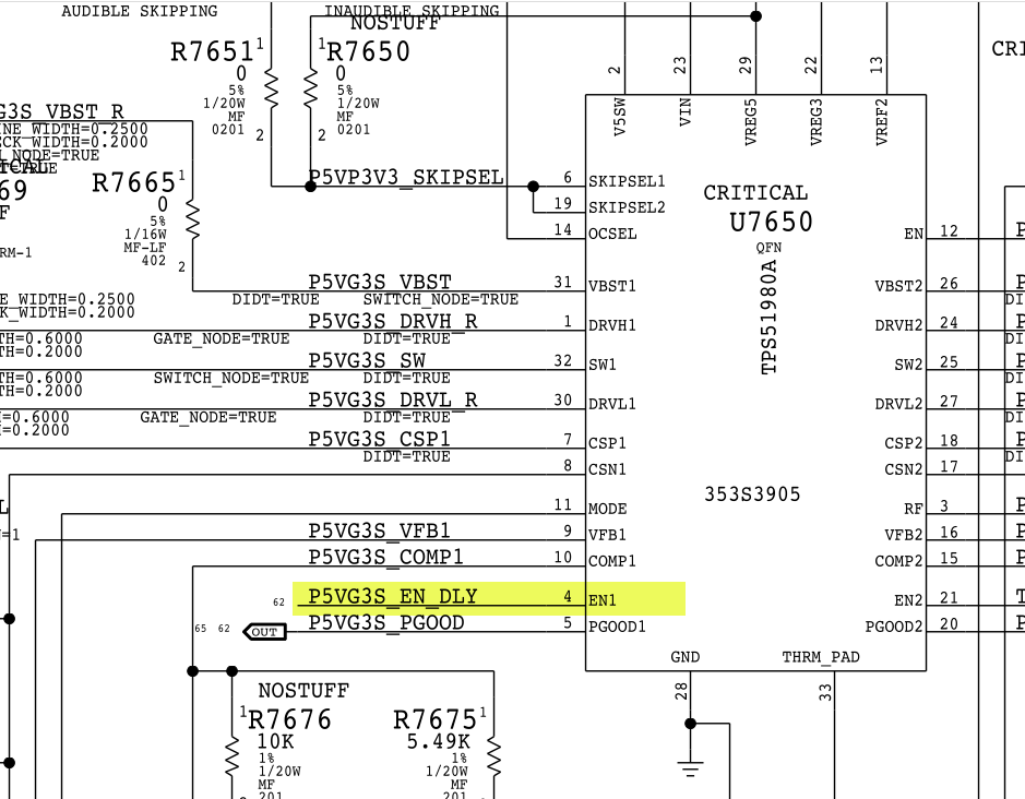

820-01521 only shows 5V 0.04A
  • kingskie
    • Oct 2014
    • 249
    • indonesia
    Re: 820-01521 only shows 5V 0.04A
    Originally posted by mon2
    You are in ohms mode.
    Press the yellow button till you see the diode symbol and measure again.
    yes @mon2, i measure with dioda mode red probe on the ground and black probe on the test point
    • mon2
      • Dec 2019
      • 14663
      What are the voltage readings of the following ?
      PP1V1_UPC_XA_LDO_BMC
      PP1V1_UPC_XB_LDO_BMC
      only the port that is powered will enable the above LDO rail.
      Do test each port side of the logic board for the above points.
      • kingskie
        • Oct 2014
        • 249
        • indonesia
        what are the voltage readings of the following ?
        pp1v1_upc_xa_ldo_bmc
        pp1v1_upc_xb_ldo_bmc
        only the port that is powered will enable the above ldo rail.
        pp1v1_upc_xa_ldo_bmc = 1.114v
        pp1v1_upc_xb_ldo_bmc = 1.112v
        • kingskie
          • Oct 2014
          • 249
          • indonesia
          any suggestions?
          • mon2
            • Dec 2019
            • 14663
            The last measurements are ok.
            PPBUS_G3H = 12.26V
            This reading is low. This means the SMC has not yet boosted the output to be 12v6 using the I2C lines.
            On the ISL9240 chip that is supplying the ppbus_g3h, locate the I2C lines. Measure the voltage of the SCL and SDA lines.
            Post your readings.
            • kingskie
              • Oct 2014
              • 249
              • indonesia
              the last measurements are ok.
              ppbus_g3h = 12.26v
              this reading is low. This means the smc has not yet boosted the output to be 12v6 using the i2c lines.
              On the isl9240 chip that is supplying the ppbus_g3h, locate the i2c lines. Measure the voltage of the scl and sda lines.
              Post your readings.
              i2c_pwr_sda = 1.791v
              i2c_pwr_scl = 1.790v
              • mon2
                • Dec 2019
                • 14663
                The I2C voltage is fine.
                1) Measure each AWAKE line and post the measurements.
                PPVDDCPU_AWAKE
                PPVDDCPUSRAM_AWAKE
                PP1V2_AWAKE
                PP3V3_AWAKE
                and
                PP0V8_SLPS2R

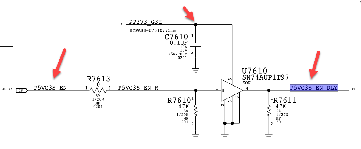

                2) As per comments by @reassor, PP5V_G3S is created by U7650. Enable = EN1 = P5VG3S_EN_DLY.
                See attached.
                Check the INPUT and OUTPUT voltage of this single gate delay IC (schmitt trigger).
                Post your results.
                You may have a damaged T2 but first let us confirm the above rails.
