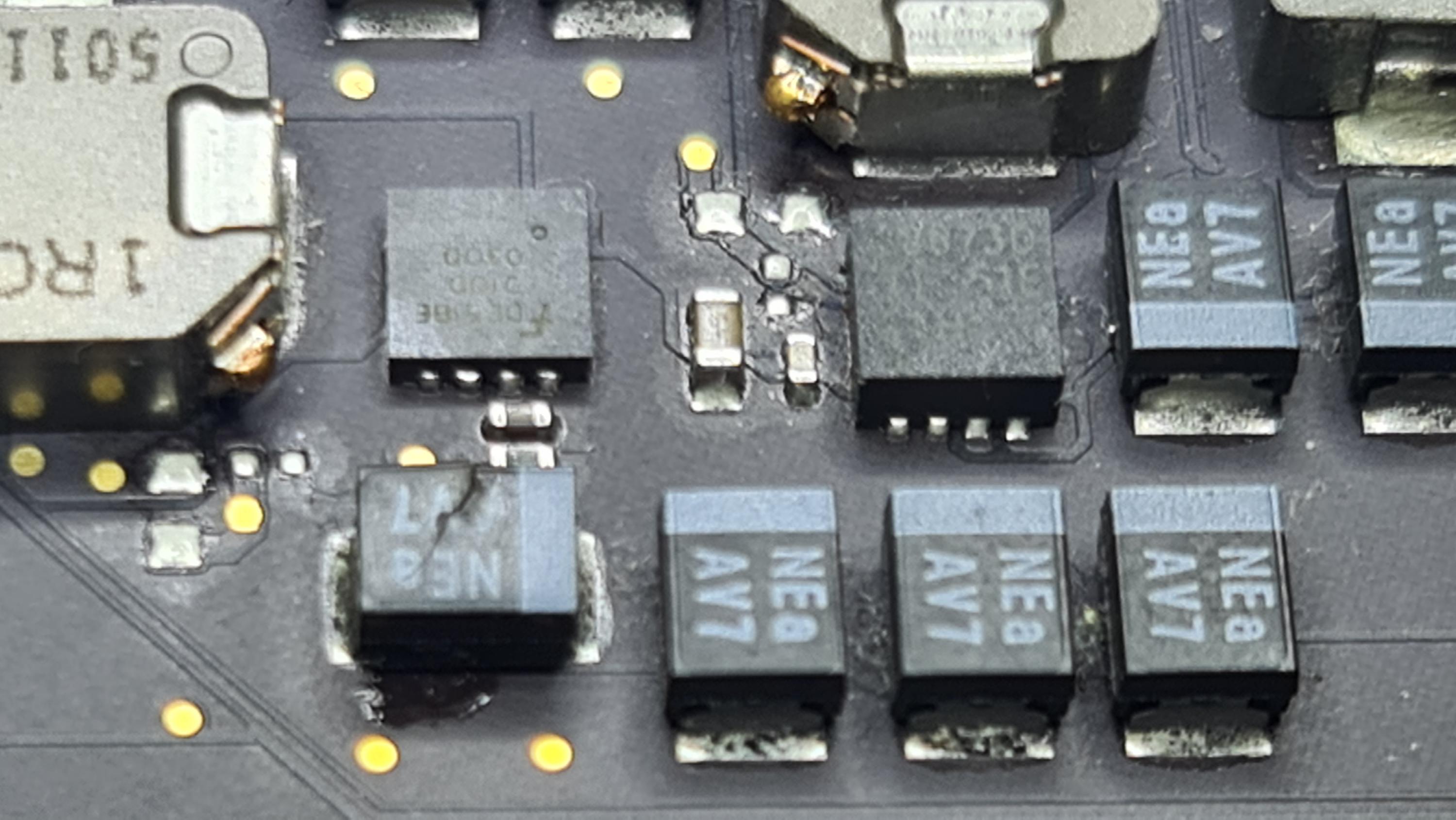

              I replaced F7140! But now C7621 is burned!. But why? You can't see anything on the board!

                Re: MacBook Air A1466 2015 no Power on
                C7621 at Picture
                  That was the reason to ask for the resistance reading.
                  The fuse blew for a reason.
                  What is the resistance to ground of the fuse that was showing 0v ?
                  Remove this blown capacitor.

                    c7621 is removed should i insert a new one? the damage fuse has 8,2k ohms

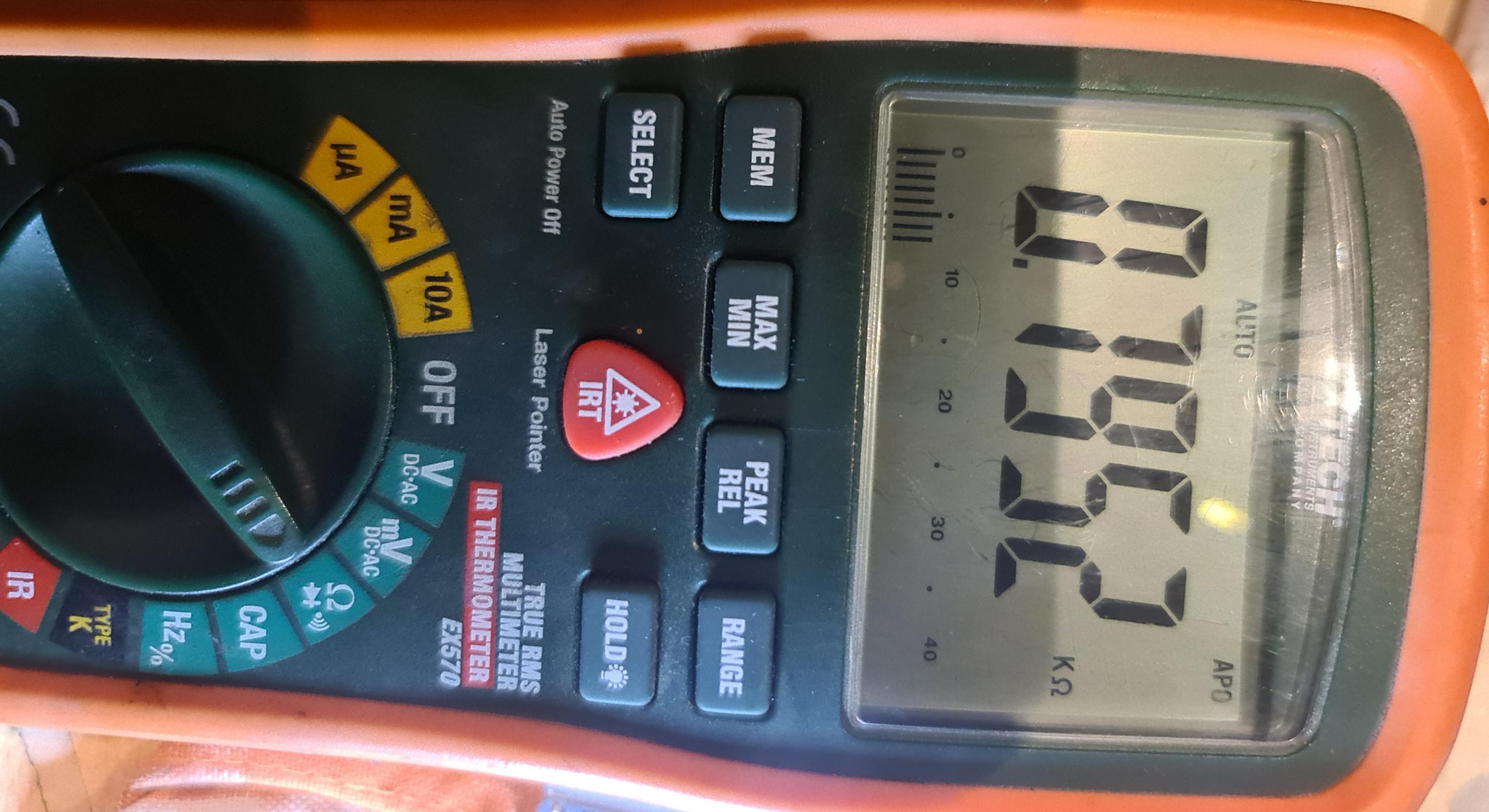

                      I missed your earlier post.
                      What is the resistance scale used on your meter?
                      Without power, check the resistance again on both sides of the F7140 fuse.
                      Post the pic of your meter settings for this test.
                      For now leave the cap off.
                      The fuse readings are now good.
                      Check also the cap resistance to ground where the blown cap was soldered.
                        the Fuse has now 0,8K both sides
                          Still sounds low.
                          If you remove the fuse, what is the resistance on each pcb pad of the removed fuse to ground?

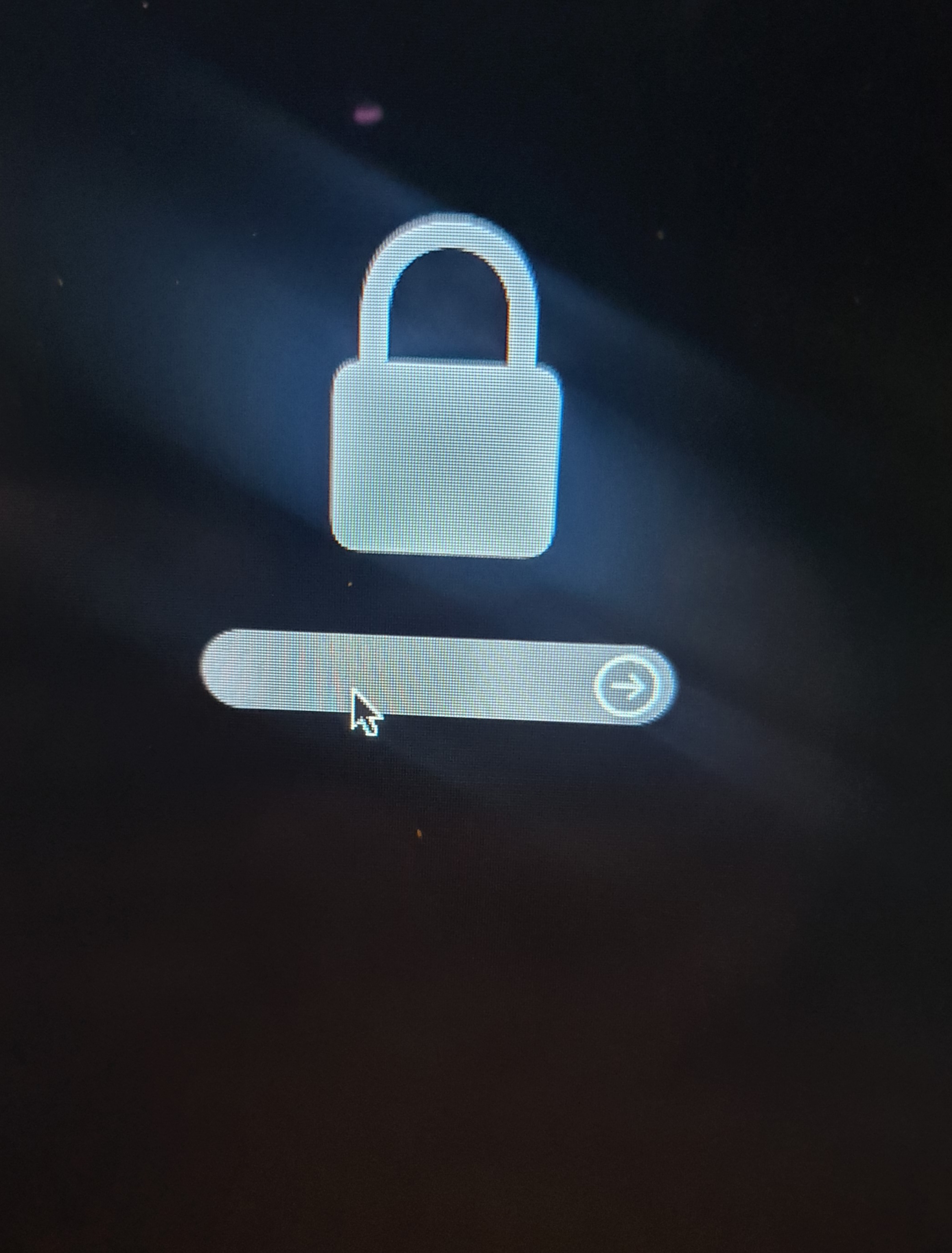

                              The MacBook is running now. The new C7621 is in the Board. But after the gong at the start comes a lock with a password. I didn't get the password from the previous owner. Then should I buy an EFI Bios chip or is there another option?
                                Yes this would appear so - https://support.apple.com/en-gb/HT204455.
                                Ask the previous owner if he can provide you with the password. Otherwise you are going to need a EFI chip.
                                  Plenty of guides on removing the password in the EFI of a MAC. Just need a programmer and hex editor.

                                    Further to my previous message if you need a hand sourcing the EFI chip Strolch please drop me a message or post back on here and let me know.
