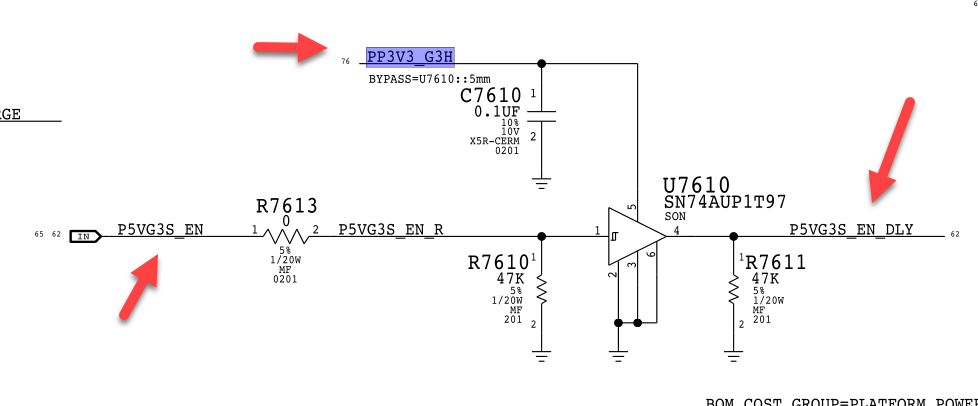

            Hi I am also working on an 820-01521 that has no PP5V_G3S. U7650 is not getting enable signal for this voltage. It looks like that EN should come from PMIC U7800. Any further news on this repair please @MobileXT ?
            Thanks I know it's probably best to make a new post but this one isn't that old so I thought I would just piggyback on here.
            My YouTube channel - https://www.youtube.com/channel/UCiD...5d6OgizDqoi_SA
            • mon2
              • Dec 2019
              • 14659

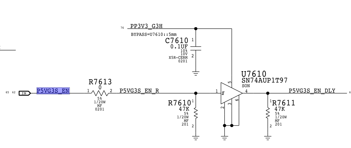

              Re: MBA 820-01521-A Missing PP5V_G3S
              What is the voltage of
              P5VG3S_EN @ R7613, pin # 1 ?
              P5VG3S_EN_R @ R7613, pin # 2 ?
              Remove all power. No battery. Meter in resistance mode.
              What is the resistance to ground of P5VG3S_EN @ R7613, pin # 1 ?
              • Pedro147
                • Sep 2016
                • 168
                Originally posted by mon2
                What is the voltage of . . . . etc
                I realise that this is the other guys post but he is MIA I would greatly appreciate any help please @mon2
                * I have 0v both sides of R7613 (working board is 1.79v)
                * R7613 measures 0.7Ω (should be 0Ω but probably just resistance of DMM leads?)
                * RTG of P5VG3S_EN is 46K (working board is 46K also)
                * P5VG3S_EN comes from PMIC U7800 so am I screwed
                PS - I tried DFU restore / revive but board wouldn't go into DFU mode

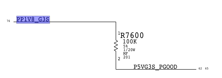

                      Use the exact net names from the schematics. It will make the review much easier to follow.
                      P5VG3S_PGOOD - 1.75v
                      P1V8G3S - 0v (correction: PP1V8_G3S)
                      This does not look correct.
                      PGOOD signals are open-drain lines. There will be a logic low but no logic high. Instead, '1' state will be high impedance and demands a local pull-up.
                      The pull-up here is R7600. The other side of R7600 should be 1v8 (PP1V8_G3S).
                      You have 1v75 yet the PP1V8_G3S = 0v ??
                      Confirm the voltage of PP1V8_G3S.
                      Also remove all power, confirm the resistance of R7600. Measurement ?
                      • Pedro147
                        • Sep 2016
                        • 168
                        Apologies for the sloppy net names @mon2
                        Yes I see what you are saying now.
                        PP1V8_G3S is indeed 0v diode 0.344
                        R7600 is 99.7Ω so within spec.
                        I rechecked all my other readings and they are all good, both voltages and diode reading.
                        • mon2
                          • Dec 2019
                          • 14659
                          What is the voltage of P5VG3S_PGOOD ?
                          Measure at the resistor R7600.
                          • Pedro147
                            • Sep 2016
                            • 168
                            That is the voltage measured at R7600.
                            Diode value 0.344v refers to diode mode measurement of that line PP1V8_G3S
                            P5VG3S_PGOOD is 0v too
                            • mon2
                              • Dec 2019
                              • 14659
                              In post #10, you had 1v75 for this signal. No more?
                              Remove all power, meter in resistance mode.
                              Check the resistance to ground of P5VG3S_PGOOD.
                              Post the measurement and meter scale used for the measurement.
                              • Pedro147
                                • Sep 2016
                                • 168
                                Yes sorry post #10 was a mistake. I had three of these boards going at once and I got confused
                                P5VG3S_PGOOD resistance to GND is 595K ohms on auto ranging scale.

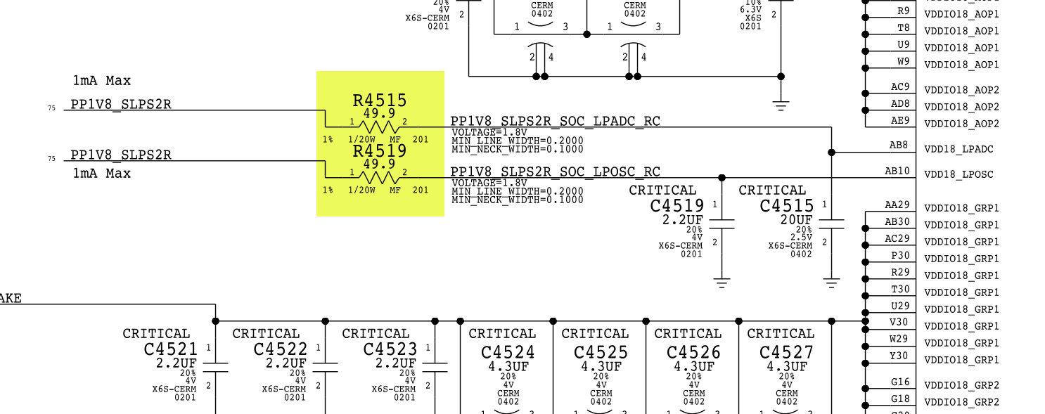

                                    Pin 1 (PP1V8_SLPS2R) of R4519 is a steady 1.8v but PP1V8_SLPS2R_SOC_LPOSC_RC (pin 2 of R4519) is only 0.628v (should be 1.8v)
                                    R4519 is correct value at 49.9Ω
                                    In regard to your questions, I have all those voltages.
                                    PP1V8_SLPS2R - 1.8v
                                    PP1V1_SLPS2R - 1.1v
                                    PP0V8_SLPS2R - 0.8v
                                    PP1V2_AWAKE - 1.2v
                                    PP3V3_AWAKE - 3.3v
                                    • mon2
                                      • Dec 2019
                                      • 14659
                                      PP1V8_SLPS2R_SOC_LPOSC_RC is not at the correct value.
                                      Remove all power. Meter in resistance mode. Check the resistance to ground of PP1V8_SLPS2R_SOC_LPOSC_RC.
                                      What is the voltage of PP1V8_SLPS2R_SOC_LPADC_RC ?
                                      • Pedro147
                                        • Sep 2016
                                        • 168
                                        resistance to ground of PP1V8_SLPS2R_SOC_LPOSC_RC - 63.3Ω
                                        voltage of PP1V8_SLPS2R_SOC_LPADC_RC - 1.8v
