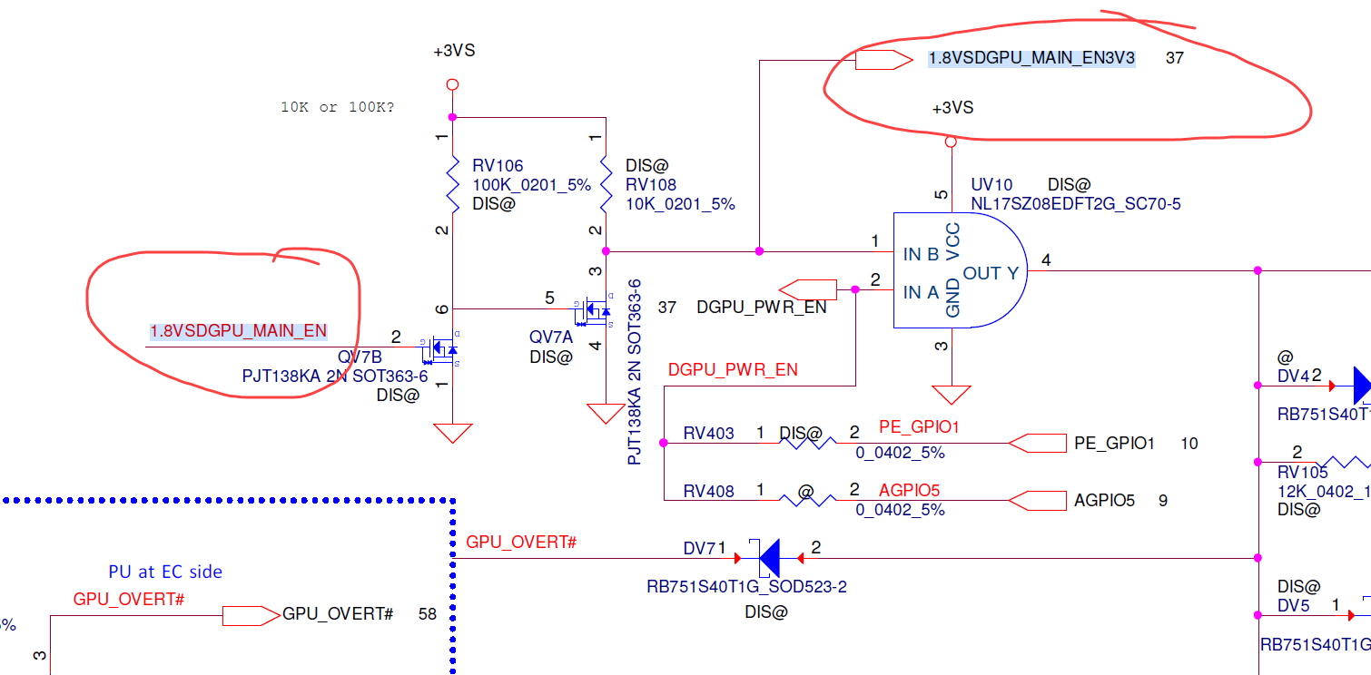

          Which ROM? Yes, operating a 1v8 rated semiconductor @ 3v3 is deadly to the device. This rom may be the show stopper.
          Review the enable signals for the GPU power path since pin #4 is @ 0v.

            the ROM in question is UV49, I'm thinking EC is not sending the EN signals because it can't read the dGPU bios.
            I checked 1.8VSDGPU_MAIN_EN and 1.8VSDGPU_MAIN_EN3V3 from QV7 and both are 0v
