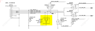

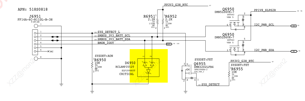

        Attach the power adapter only. Carefully measure the voltage to ground on each pin on the battery connector @ J6951.
        Post each measurement. We are testing if the SMBUS interface lines are ok or if one of the TVS ESD diodes has become defective.

          Actually I already checked SCL and SDA earlier due to seeing that in another thread.. But checked again now:
          1 -> 0v
          2-> 3.3v
          3-> 3.3v
          4-> 0v
          By the way nothing is in those lines when the fuse is removed. Also with the fuse removed the USB meter stays at 5v... Is this expected?

              These lines are fine. They are not shorted. If these lines reported a low voltage then one of the diodes is shorted.
              Remove all power. Meter in resistance mode. Measure the resistance to ground of each and every inductor on the board. You are hunting for a short on one of the power rails. If the resistance is too low, then the rail may have a short on that power rail and causing the power cycling.

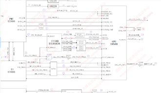

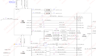

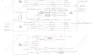

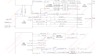

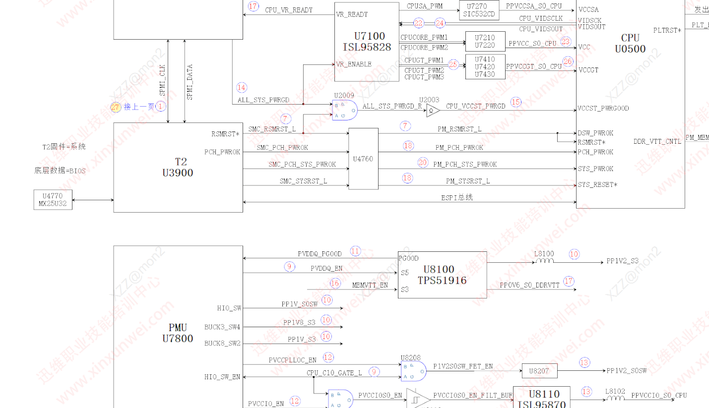

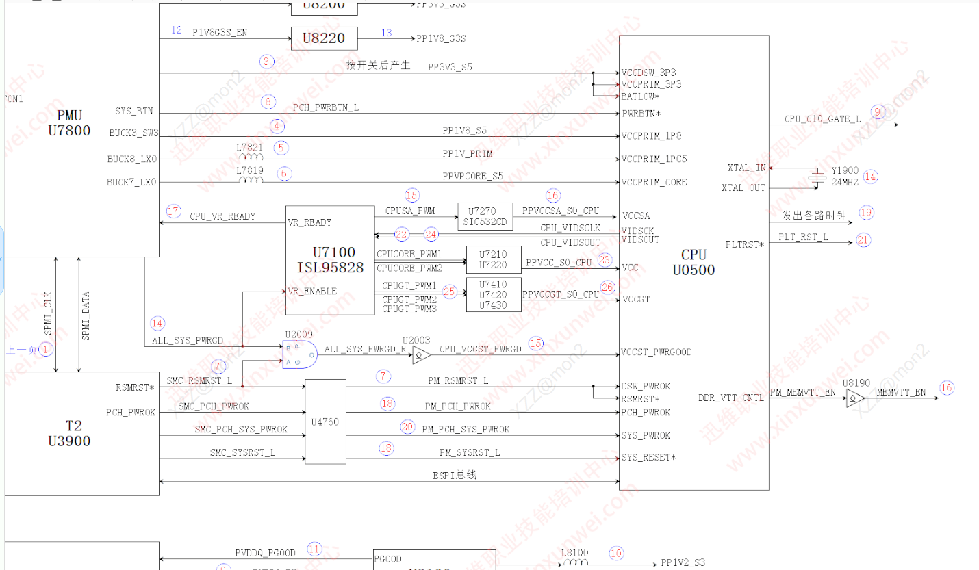

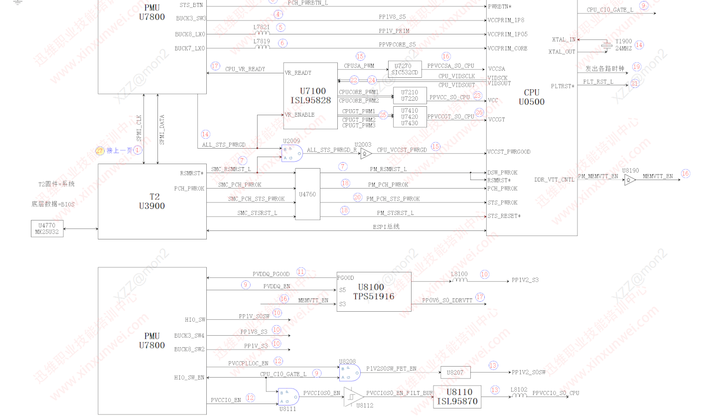

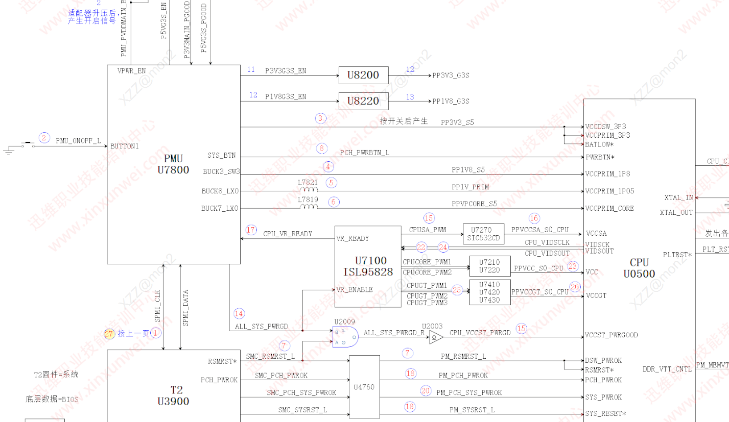

                  Do you have a power sequence chart for this model?
                  Click image for larger versionName:	ps1.pngViews:	0Size:	110.1 KBID:	3707927
                  Click image for larger version  Name:	ps2.png Views:	0 Size:	327.4 KB ID:	3707928
                  Click image for larger version  Name:	ps3.png Views:	0 Size:	317.8 KB ID:	3707929
                  Click image for larger version  Name:	ps4.png Views:	0 Size:	335.0 KB ID:	3707930

                    No I didn't have these, I was going to work through the Power Aliases page on the schematic.
                    Where did you get these?

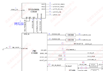

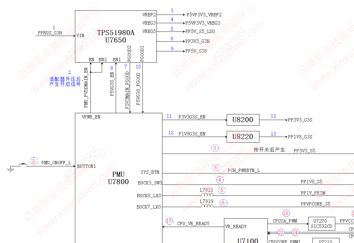

                      I've checked quite a few of the sequences, basically the blue ones without circles all work but reset every 15 seconds but lots of the blue with red circles all belonging to U7800 are not working..
                      POWER SEQUENCE:
                      U7650 BLUE Numbers:
                      1 -> PPBUS_G3H -> Looping 12.22v @ 30mah when resets Batt Dis-connecting? / 11.6v When charging @ 0.5 – 0.8a.
                      Just Batt -> 11.22v Stable.
                      Just Charger – 12.55v/12.22v Looping!
                      2 -> Power Button -> U7800 (Showing 3.3v) Then:
                      U7650 – Pin 12 -> 3.35v
                      21 En -> 1.98v
                      3 -> P5VP3V3_VREF2 -> 1.98v
                      4 -> VREG2 -> Pin 14/22 connected together -> 3.28v
                      5 -> 5.13v
                      6 -> 3.35v STABLE – Not directly connected to IC.
                      7 -> 3.05v
                      8 -> 3.37v En Cycling every 15s. (5v Enable)
                      9 -> Stable 5.13v - 15s Cycle & Reset.
                      U7800 Blue Numbers:
                      10 -> 1.8v 15s Cycle & Reset.
                      11 -> 1.8v 15s Cycle & Reset.
                      U8200 Blue Numbers:
                      12 -> 3.37v 15s Cycling.
                      U8220 Blue Numbers:
                      12 -> 1.79v 15s Cycling.
                      U7800 Blue Numbers with RED Circles:
                      1 -> Diode Reading -> 566. MISSING – 0v!
                      2 -> Power Button has 3.3v on it.
                      3 -> Diode Reading -> 425. MISSING – 0v!
                      4 -> Diode Reading -> 328. MISSING – 0v!
                      5 -> Diode Reading -> 73. MISSING – 0v!
                      I stopped going any further as it is clear they are not working, can check more if needed.
                      Shorting the Power button to ground makes no difference and I think it is auto-booting anyway when USB charger is applied right?
                      Also I did it all with out the battery as cannot access the other side of the board otherwise but it should run with out the battery right?
                      Since step one on U7800 is a clock should I see anything on the multimeter? I do have an oscilloscope I can dig out and setup...
                      I had a good check around U7800 for shorts but nothing seams to be short... So I guess the question is whether it is faulty or something else is not right like the clock signal in step one!
                      Cheers.
