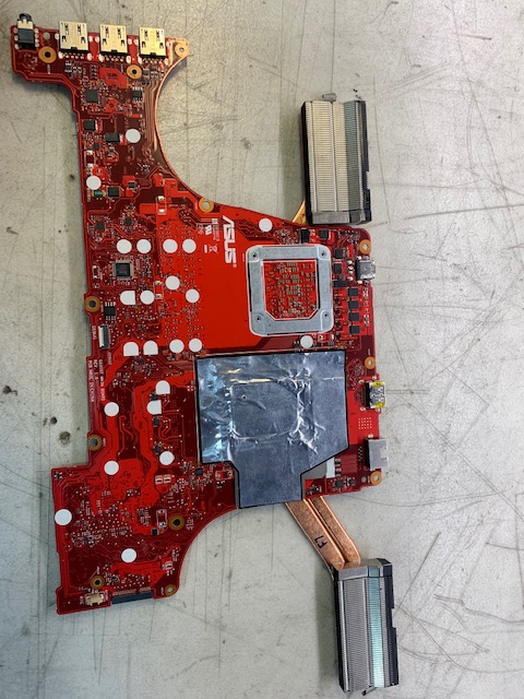

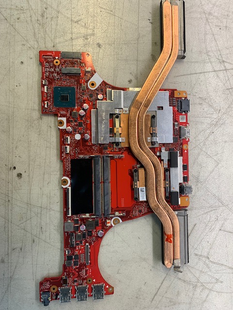

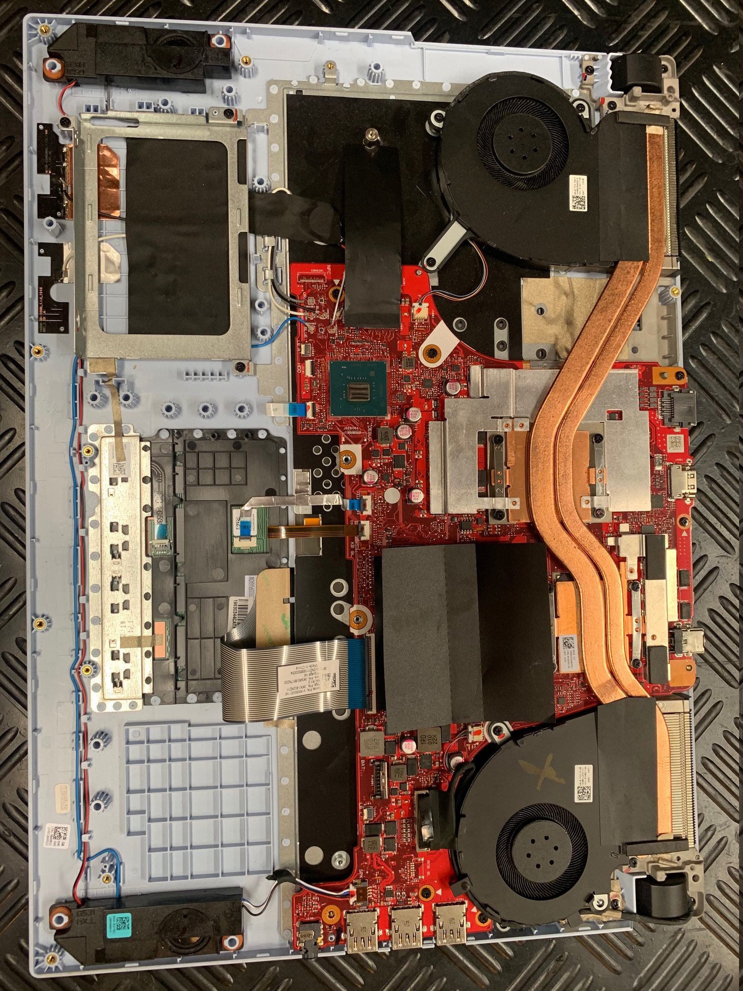

    ASUS G731 shorted motherboard
    Hi, got this Asus ROG G731 with a "shorted motherboard", at least there are shorts measuring across a bunch of electrolytic decoupling caps. Probably been exposed to a faulty charger / wrong polarity charger.
    At least, inside I found a working 512GB SSD and 16GB of ram.
    Anyone have any service manual to this guy or any advice where to focus my probing ?

      Re: ASUS G731 shorted motherboard
      Thanks, so you mean I will need to start the process by getting the MB out of the unit firstly, loosening the heatpipes and everything else ?
        • 21307
        Yes ,you`ll have to take the board out. Remove the heatsink screws a few turns out each evenly until theyre all loose,then try and lift the heatsink off near the screw area,if you lift it by the fan end it`ll bend like a banana

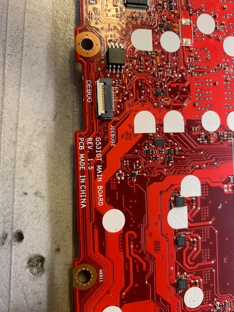

          Adding some pictures of the bottom side aswell.
          Obviously there is a G531 GT rev 1.5 motherboard I am looking for the service manual for.

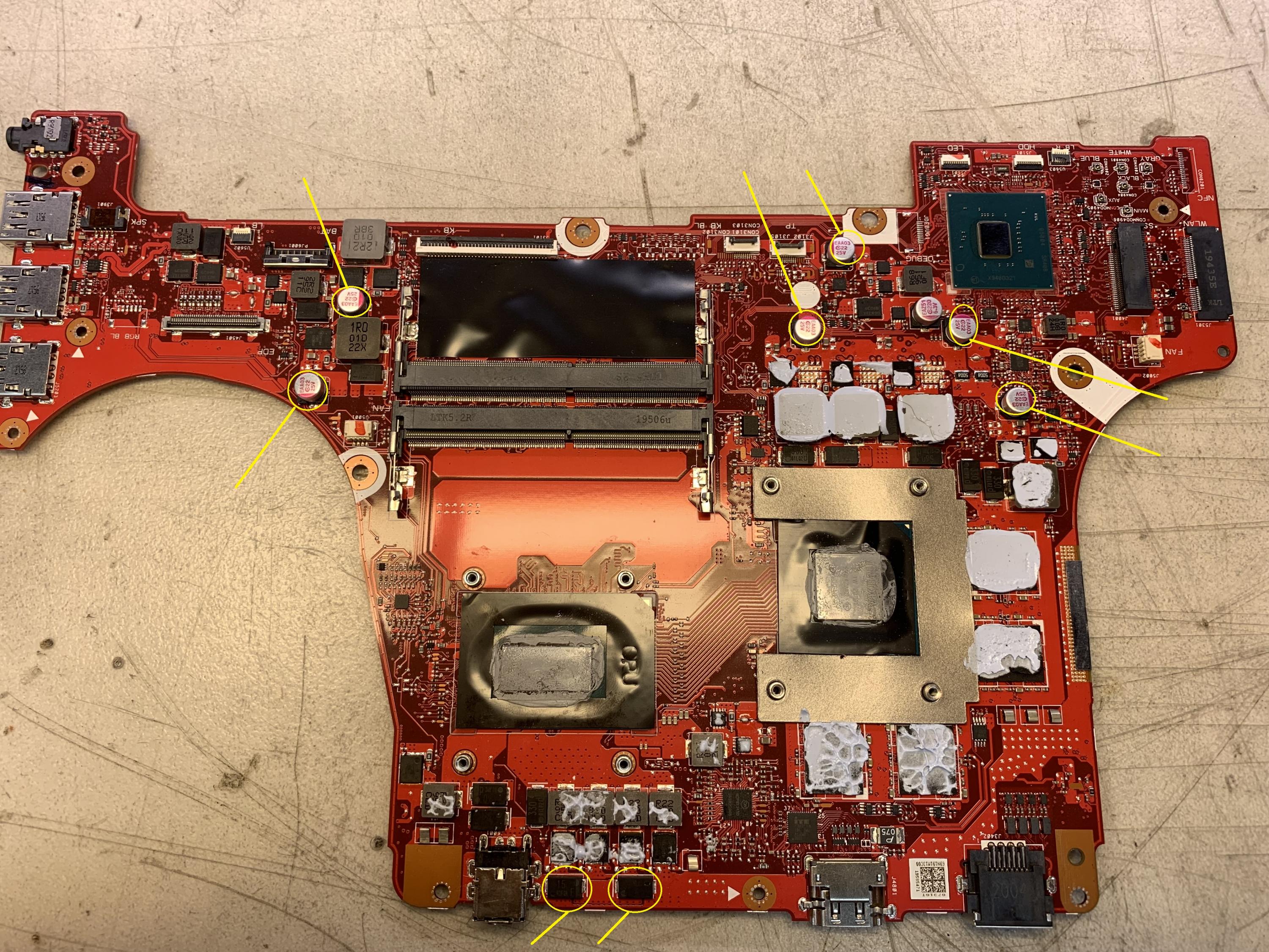

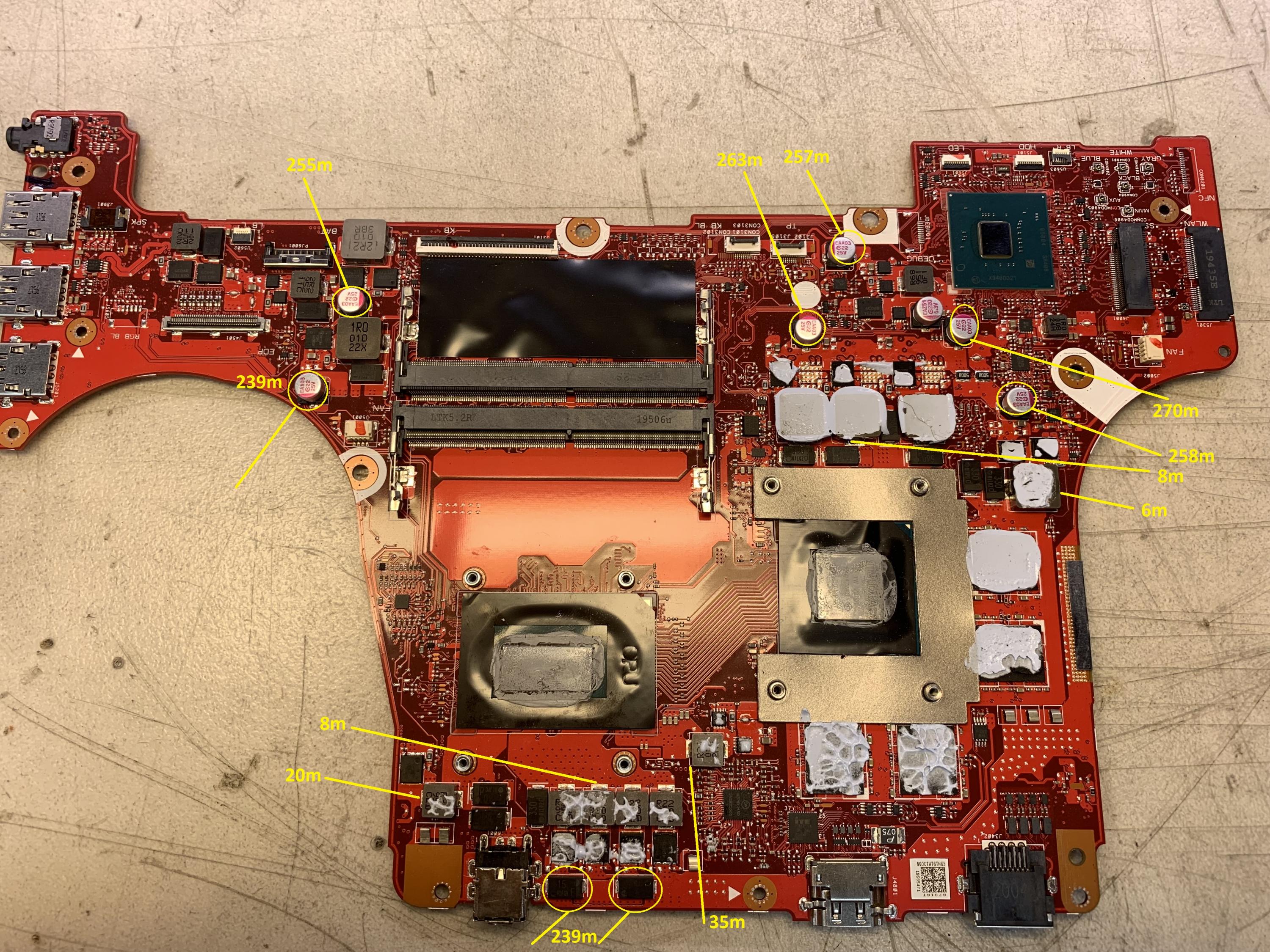

            It seems as far as I can understand, that the system power bus is shorted.
            All the electrolytes with a 25V rating are less than 1ohm across...
            I wonder if I should try to supply some current limited voltage through the charger input?
            I have a high resolution thermal camera that I could use to see if there are any heating stuff...

              Post the resistance to gnd on those caps,and all the large square grey coils
              • PowerAmpFreak
                • 982
                • Sweden
                Here you are...
                Measured to GND with LCR meter.
                EDIT: Listen to this:
                I connected a heavily current limited supply across the short. Slowly increased the voltage to 100mV, current consumption increased to around 50mA initially and slowly faded down.
                After this the static short is gone.
                  When doing voltage injection usually one starts with 1 V DC and current limit set to 2 A, since this will not cause any damage. 50 miliamps will cause nothing to significantly heat up.
                    I suspect a MLCC ceramic cap somewhere on the system bus to be shorted. Eventually by injecting a small current will affect the MLCC material properties. I got the information from the previous laptop owner that it was dropped onto the floor and perhaps this damaged a MLCC.
                    Normally, MLCC are quite sensitive to mechanical stress and I will now go through them with freeze spray and measure resistance and see any change.

                          hello, please measure the resistance to ground of the current sensing resistor, its usually located after the dc-in mosfets
                            It seems I found the problem in this motherboard.
                            The story is the following:
                            Previous owner dropped the laptop on the floor.
                            That destroyed the charging connector
                            He tried to replace the connector
                            He then accidently managed to short a 0402 MLCC by a solder bridge.
                            When fixed the bridge the short is gone.
                            What's left to understand is the post above, what the smaller pins in the charging connector does. If they are used to detect the charging plug. One pin is grounded, the other is not. The via hole for this pin was damaged in the process of connector replacement.
