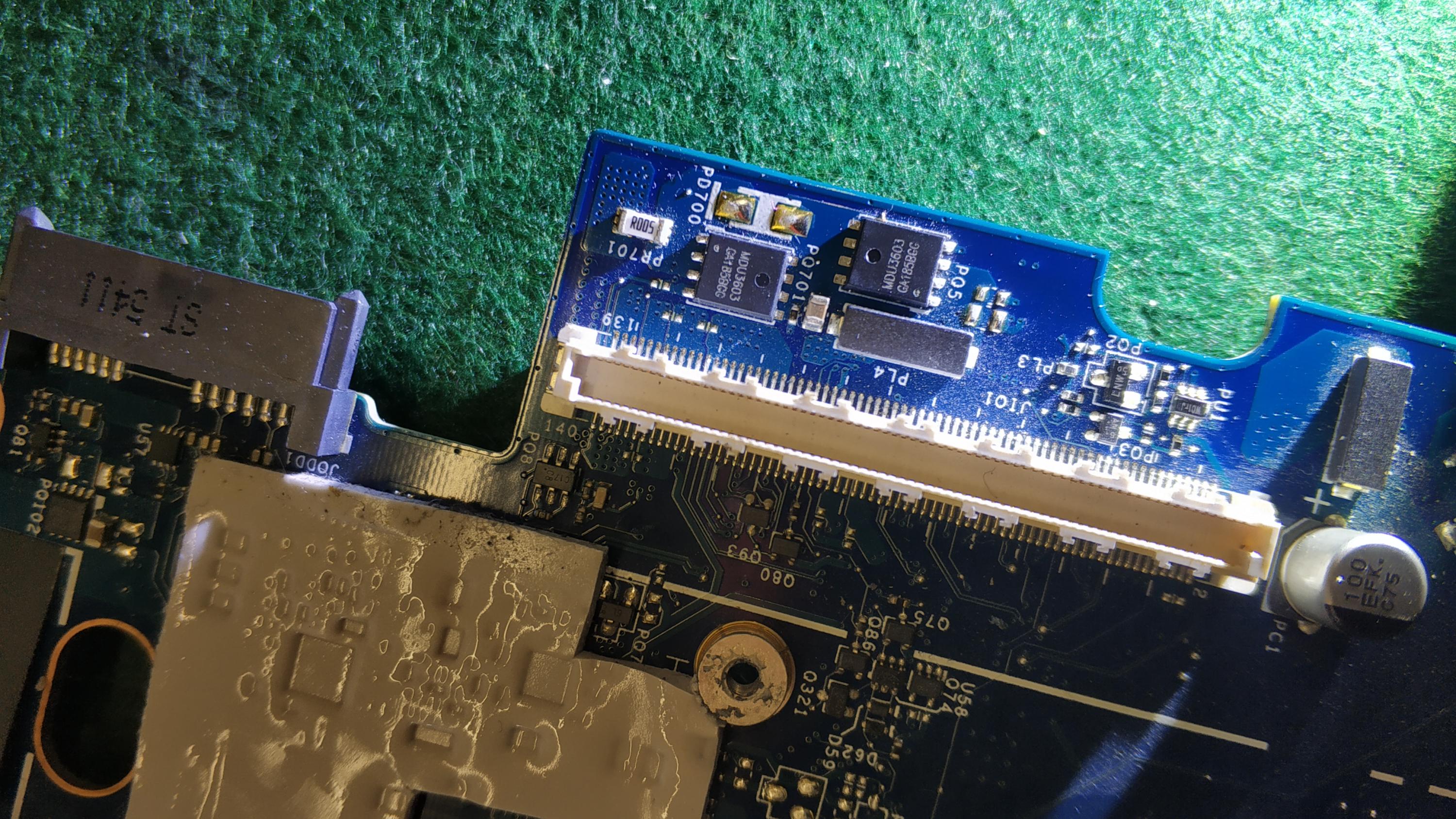

    Hello, I have a Dell M6800 that power supply goes off every time you try to plug in. Power supply is on good condition, working Ok in other devices.
    The board is a LA-9872P, could not find a proper scheme, maybe 9871P is similar?
    The board has almost 2 mosfets dead, PQ5 and PQ701 (MDU3603 both ones). Changed them but plugging the power supply, the PQ5 died again, PQ701 still live, but short is still present.
    Tried to inject 2v, the PQ701 heats a lot, other components not seem to increase temp to my fingers "resolution".
    Totally lost, some one could point me?

      3) The PQ5 shorted was removed a throw away to waste, not fitted any other again yet (just to not burn other) The Source to Drain reading was continuity and discarted it as failed, not tested source to gate and gate to drain... I could solder a new one and let it burn to check. EDIT, maybe I'm just too stupid and throw away 4 good ones... (shit)
      4) with the PQ5 mosfet off and the power supply plugged, the pads 1,2,3 read is 19,57v and the pin 4 read is 9,29V, too high this one, not?, this not should be powered with the power button with 3.3v?

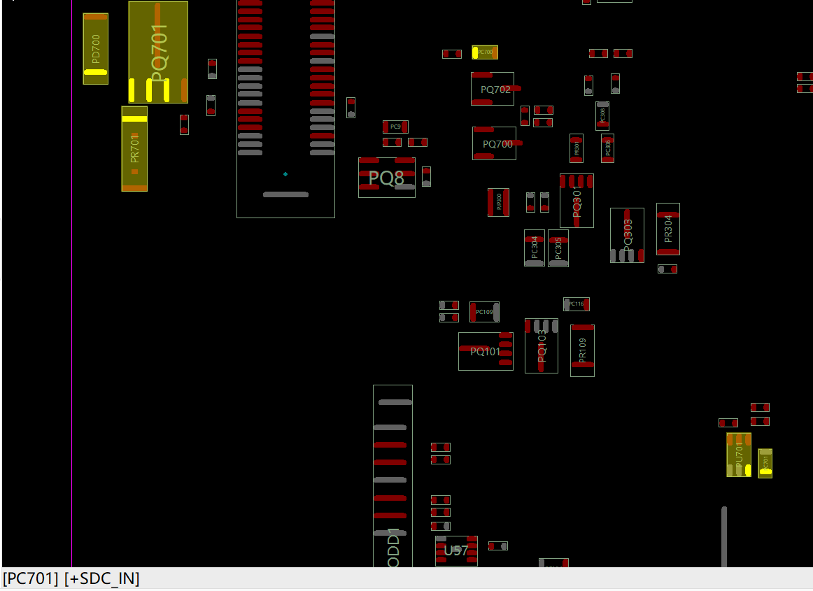

          Any one has a .brd file of this board? reached a PU701 with short on pin 1,2,3 and a near cap shorted too (perhaps the 701)
          Edit: removed PU701 and the supposed PC701 but short still on board pads.
          Added schematic of the board
          • mon2
            • Dec 2019
            • 14660
            Re: Help with board LA-9872P short to earth
            Have the boardview file but is tied to a paid sub.
            See attached to see if it helps.

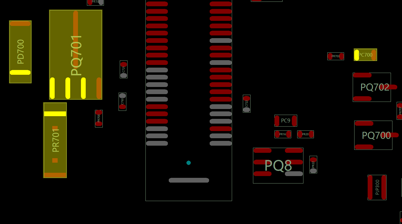

                Well, the PU701 pads are all shorted, maybe a noob question, the PQ701 source pins are earth, not?
                The PR701 should give continuity? it’s earthed too on both sides
                I'm hitting the jackpot, any idea where to continue?

                  Some update, found the PC535 (10uF 805) and PC529 (100uF CEEEFK1E101YP Panasonic) shorted, will change all the row of de 100uF capacitors for sure.
                  Almost one of the shorts is found, fingers crossed.
                  • ex250
                    • Jun 2019
                    • 97
                    • Spain
                    Found also the PC908 a 330uf in short.
                    Seems that all shorts are found. Now was trying to check if the mosfets 87350D, removed all from the board, any easy way to check if they are on spec?
