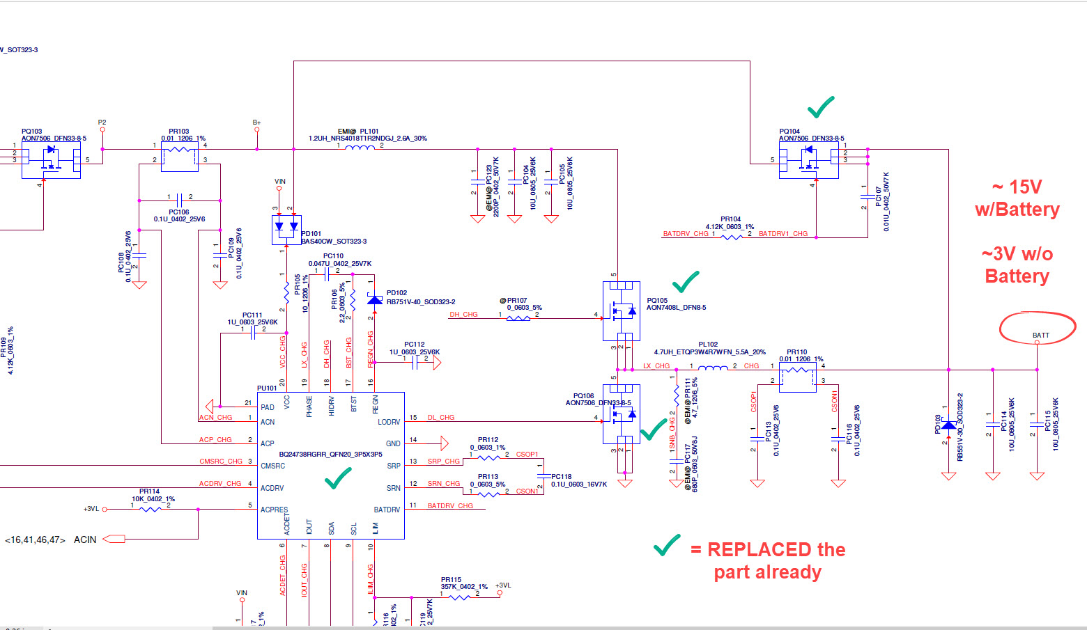

    Hi. Have a HP250 G3 laptop (schematic attached) that will not charge the battery.
    1) The laptop works fine with the AC adapter.
    2) The laptop works fine with a pre-charged battery (HP original with 880 cycles). The battery was depleted when brought in for service and we purchased a new clone with 2 charge cycles on it. The clone battery was received DOA and also will not charge with the laptop.
    Then we purchased the NLBA1 tool which worked well to ping the clone and HP battery with success. While we could readout the parameters with the I2C / SMBUS interface, the clone battery was unable to be charged with the NLBA1 tool.
    The same NLBA1 tool was able to charge the HP original battery with 100% success in about an hour.
    We applied this pre-charged battery onto the logic board and the laptop booted fine into Windows and reports the battery gauge @ 98%. The laptop continues to work while the battery drains and is presently @ 45% and going down.
    If we attach the ac adapter, the battery level will become static but continues to state "charging" but it does not charge up. Will remain at the current % level.
    3) Have replaced the charger IC @ PU101 and the 3 interface mosfets with no improvements.
    So we know that the AC adapter is able to power the logic board and does not make use of the battery since the battery level does not drain in this configuration.
    If using the battery only, the laptop works but drains the battery.
    In the absence of the battery, the BATT rail is ~3V.
    With the battery & ac adapter, the BATT rail is ~15V.
    Is it possible that PU101 (charger IC) is unable to charge this somewhat stale battery due to perhaps a higher current draw during the charging cycle ? Again, NLBA1 tool can charge this battery if out-of-circuit.
    Any ideas / suggestions on what could be at fault ? Thanks.

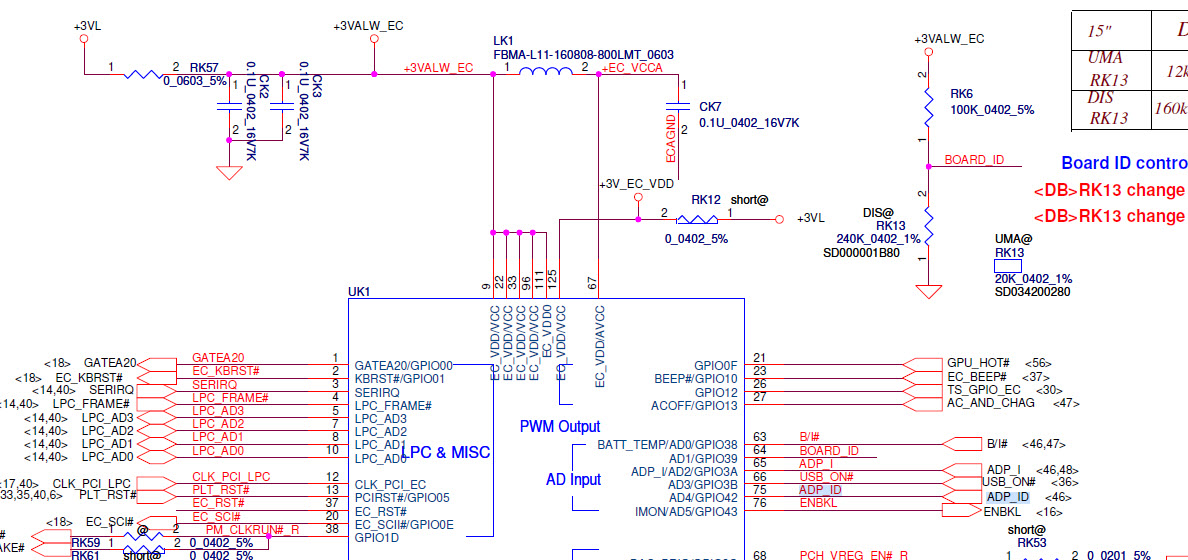

          1) PR1, Pin1 = ADP_SIGNAL @ +1v8.
          2) PR1, Pin2 = voltage divider junction @ 0V9.
          We are using a universal AC adapter @ 19V on this logic board.
          Update:
          OMG - just found the following using the keyword "ADP_ID":
          https://yashan.co.in/hp-cq40-battery...g-discription/
          Had no idea on this ID pin. We are < 1V here with the charging cable.
          Can a 3v3 rail feed be placed onto the ADP_ID rail to pacify the logic level ?
          So, the idea is to REMOVE PR1 -> apply a 3v3 jumper off the logic board to emulate the logic '1' (high) for the KBC.
          More...
          If the power adapter cable is REMOVED and measured without connecting to the logic board, then the ADP_SIGNAL = 19v0 !!
          If the same power adapter cable is connected to the logic board, ADP_SIGNAL drops to +1v8. According to the above website, the end result for ADP_ID must be +3v3..+3v6 to pacify the KBC.
          Removed PD2 - same results. ADP_ID remains @ 0v8.

            So the plot thickens...zener diode PD3 is missing off the logic board.
            Based on this, believe that 19v0/2 = ~9v5 was seen by the ADP_ID pin on the KBC ??
            This would certainly nuke the GPIO pin?
            This would imply that KBC @ UK1 must be replaced?
            Never programmed the KBC9012 devices. From where can we source the contents of this KBC device ? Do see the mention of the SVOD3 programmer and see it on Ebay. We need this tool to program a fresh (empty) KBC?
            I think a damaged GPIO pin is the only way the 19v0 on pin 5 of the power connector tanks to 1v8 and ends up being 0v9.
            Welcome your comments.

              Use your bench psu and solder a 290k resistor from ADP_SIGNAL pin 5 to ADPIN and check voltage again. What programmers do you have now.The SVOD 3 is a good programmer ,it even has a battery tester built in.Other programmers that can flash the KBC are the Vertyanov JIG , SAS IO (vertyanov clone... ) RT809H,RT809F and even the CH341A.

                2) still leave in the 10k pull down on the logic board? Please note that PD3 zener diode is missing.

                  ADP_ID is perfectly fine, especially if it turns on with AC adapter only and white LED is lighting up at DC-in connector. ADP_ID is a simple voltage divider.
                  ADP_ID = 19V * PR7 / (Radapter + PR1 + PR7)
                  With a 90W AC adpater, Radapter = 220kΩ (I think for blue tip)
                  ADP_ID = 19 * 10 / (220 + 10 + 10) = 0.79V
                  PD3 is no stuff as indicated in the schematics.
                  No need to waste time troubleshooting a motherboard issue and risking killing it by taking a wrong path if you don't even have a known good battery.

                    2) Where is this Radapter located? Inside the small 8 pin module that accepts the adapter voltage ?
                    3) What is the identifier in the schematic to show that PD3 is a no-stuff part?

                      What brand is the "universal" charger,a lot of cheapo chinese ones can be 45W or worse with a 90W label on
                      A 19V 65W charger has a 383Kohm resistor. 90W = 294K - 300K ,120W = 180K ,or thereabouts
                      A well worn battery will charge quicker. Agree with piernov that you need a good battery to start with.

                          Originally posted by mon2
                          Thanks.
                          The resistor is inside the charger tip. PD3 is no stuff as it has an @ before it . @PD3

                                      Hi. Voltage readings of PU101 (charger IC):
                                      (battery removed from logic board & AC adapter connected - WHITE LED on)
                                      Pin # 1 = 19v3
                                      Pin # 2 = 19v3
                                      Pin # 3 = 19v85
                                      Pin # 4 = 19v83
                                      Pin # 5 = 3v30
                                      Pin # 6 = 2v698
                                      Pin # 7 = 0v
                                      Pin # 8 = 3v31
                                      Pin # 9 = 3v31
                                      Pin # 10 = 0v71
                                      Pin # 11 = 3v06
                                      Pin # 12 = 3v02
                                      Pin # 13 = 3v05
                                      Pin # 14 = 0v
                                      Pin # 15 = 0v
                                      Pin # 16 = 6v0
                                      Pin # 17 = 5v89
                                      Pin # 18 = 0v
                                      Pin # 19 = 2v9
                                      Pin # 20 = 19v5
