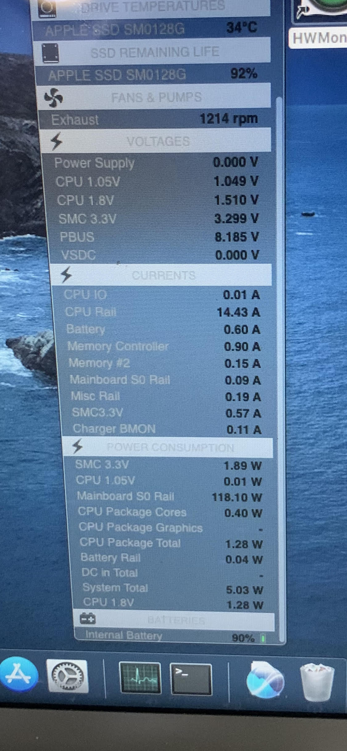

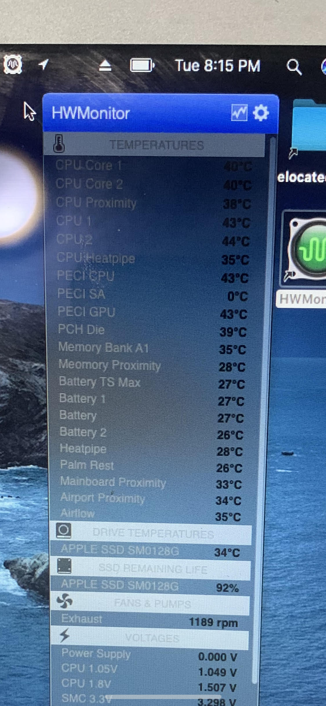

    Hi! I got this 2017 board that needed a long press in the power button to turn on and the CPU throttled extremely hard. if I do a SMC bypass the laptop works perfectly. tried with disconnected keyboard/camera/DC-in Board etc and still throttles. Fan always stays low not high
    I inspected the board and it looked pristine except a little liquid spill around the SMC and had a shorted cap C5125 from U5110 REFOUT
    after removing the Cap the laptop no longer needs the long press to turn on but still throttles and fan low rpm.
    still haven't replaced the cap. ran ASD EFI and passes everything, installed HWmonitor and checked sensors all show normal temps low.
    The only things that look sus are the "PECI SA" sensor jumps from 0 to 42 C don't know if that is normal
    and it shows the "CPU Rail" current as 14.43A. that looks High, and "Mainboard S0 Rail" 118W of consumption.
    I suspect it's a current sensing issue? would love some insight on where to look next as I'm a total Noob.

      Hi, finally took this board again, replaced the capacitor and realized that the trackpad was extremely hot to the touch, and it didn't work anymore so I replaced it with another trackpad and cable and the laptop no longer throttles but the trackpad gets extremely hot I guess something is shorting it and I can't figure where to look for. I haven't turned on the laptop anymore because I feel like its going to burn the trackpad as it gets extremely hot.
      but before I checked HWmonitor and everything looks normal except :
      Memory bank A1 128C
      and battery drawing 254 amps
      the laptop no longer throtles, but the trackpad gets extremely hot.
      Any Advice?
            I can confirm that this is not an issue. I've seen this on many A1466 MBAs and none of them had any issue because of that.
            So, are you saying that after replacing C5125 capacitor, Memory Bank A1 now shows 128C?
            Please examine closely HW monitor now and compare with the first picture you posted here. Perhaps one or more readings are missing from the list.
                thank you for your reply!
                Yes, the only difference is now Memory Bank A1 shows 128C everything else seems normal. but when I connect the charger it says the battery is drawing 254 Amps. but can't do nothing about that as the trackpad gets scorching hot the second the laptop turns on.
