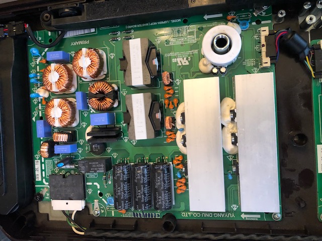

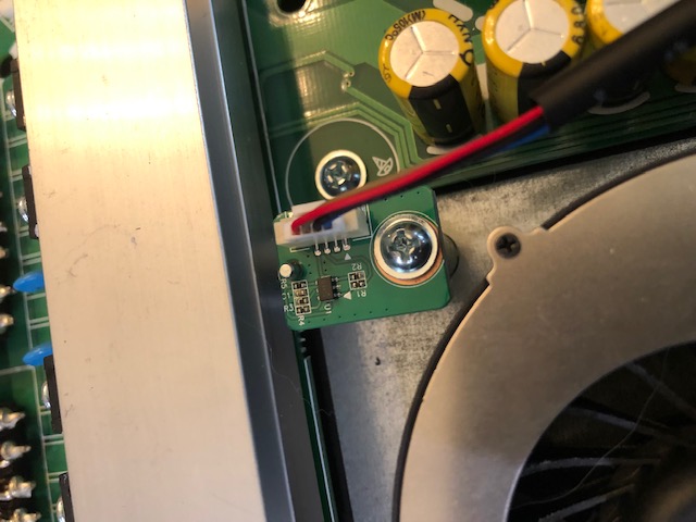

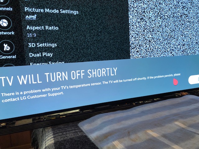

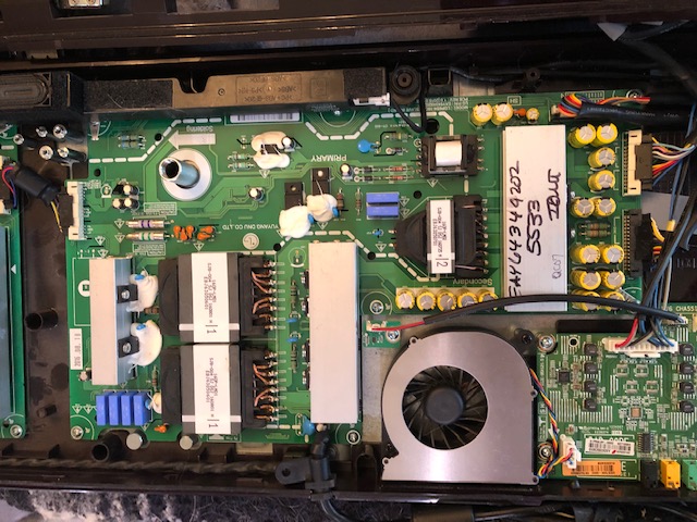

    I am a very beginner at tv repairs. I am trying to fix my tv before I end up buying a new one. I do not know names of boards, but I will do my best to explain what I have done so far.
    Tv is an LG OLED65G6P manufactured in april 2016. I had a warranty on it till September of 2021. Warranty is done. The problem I am having is when I turn the tv on after about two or so minutes a popup comes up and says the temperature sensor issue, and then it powers itself off. The tv works as designed, picture, sound, wifi, settings and everything, before it just powers itself down.
    So i did what any person would do and I looked on Google for the temperature sensor. I ordered the $15 sensor. and installed it. The temperature sensor is a very small 1x1 inch circuit board. After install same problem.
    A previous repair while it was under warranty June 2021 was a main motherboard for a separate problem. That problem was the cable connection kept disconnecting, so the warranty replaced the main circuit board where the cable goes into the tv. But this issue with temperature happened after a few months after when the warranty expired.
    So once again I go to google and didnt really find any viable information. So I did what i felt was the right thing. I spent $125 and replaced two of the three remaining circuit boards. So now the only board that was not replaced was the video board. There are four big main circuit boards on this tv. I have replaced three of them.
    I really need help. This tv cost $3000 when I bought it and dont have that money to get a similar tv.
    Does anyone know much about this. Just to quickly recap. When I turn the tv on a pop comes up and states the temperature sensor issue, and then the tv powers down.
    The lg part numbers I have installed so far are:
    eay64339201 lg power supply master
    eay64349202 lg power supply slave
    ebr82440301 lg sub pcb assy, (temp sensor) Could this be incorrect sensor?
    The board replaced under warranty, i do not have the part number.
    I appreciate the time spent helping me out.
    One thing I forgot to mention. Last time I messed with it, I decided to put the tv in reset mode to reset to factory settings. and now I am stuck in the opening sequence of time, language etc etc. Tv doesnt stay on long enough to get past this part.

        Re: OLED65G6P-U.BUSWLJR Temperature sensor issue
        i just wounder what temperature sensor you replaced... its TV not cooker LOL
        so stop doing any things... upload focused clear photos on the whole back and the all boards you replaced ..
        this error and go to shutdown to protect the panel module its 90% happen because one of the cable / sockets get on power boards warming up and the resistances of them changed so the MICOM on main boards watching this and turn the tv off.
        so start with photos.

                    • drake441335
                      • Feb 2022
                      • 6
                      • usa

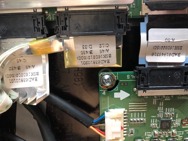

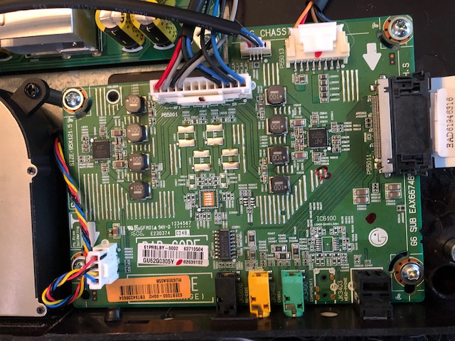

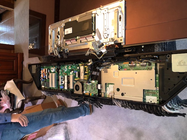

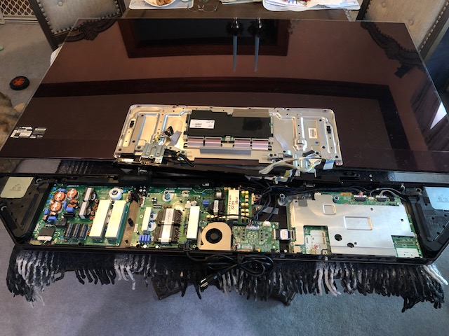

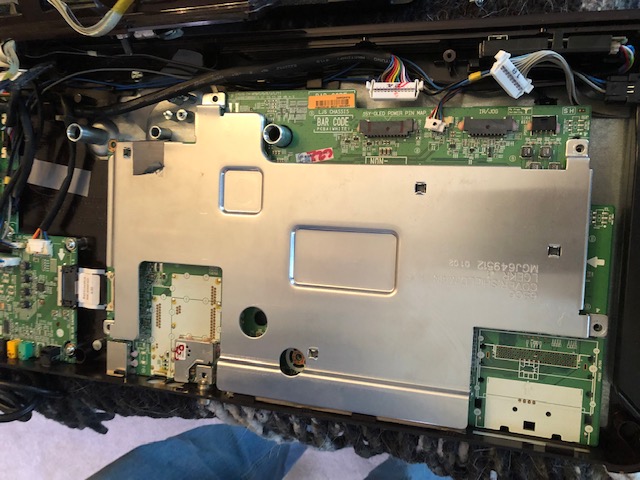

                      Sorry, I started a new job and getting back to this tv was not a priority. here are the pictures. the pictures show all pieces i have replaced. the wires in the final pictured were not replaced, i just took the picture for part numbers for myself.
                      thanks for your help

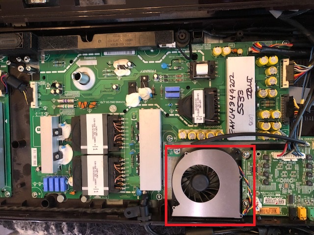

                        Originally posted by drake441335
                        i just took the picture for part numbers for myself. thanks for your help
                        if yours cable and socket fine at power boards and there are no burn then you have the problem with this FAN, the RM ( spinning )of it became low so its resistance become high.
                        open it clean and oil the shift of it. if it still make noise and didnt spin in high speed as i think its 12V you can use PC FAN too and see the tv will remain on

                            Well, I decided that trying to make this repair myself was starting to get above my head. I took the tv into a repair facility. they told me that the main board is not communication with the temp sensor. The board with the metal on top of it is the one that is not communicating. The board is on order and will be installed next week or so.
                            I truly thank you all for your help.
                            • Diah
                              • Feb 2013
                              • 6703
                              short and clear words.. they told you a lie. its FAN issue
                              the top boards you mentioned are the T-CON driver boards had nothings to do.
                              the FAN will sitting on it to pull air. that's all... am sure this shop owner a member in this forum... so if you read take it easy.. earning money are your right but not by lie.
