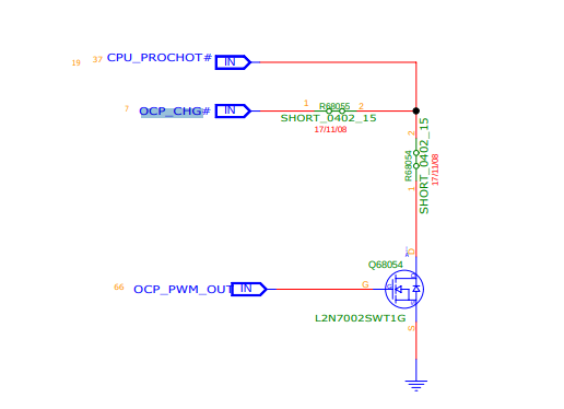

    I found a similar Elitebook 850 Gen 6 from a friend and measured more voltages of a good board:
    1. id pin reading of about 0.58V is correct for this board.
    2. PROCHOT pin of ISL charging IC reads about 1V on a good system.
    I followed the PROCHOT pin (OCP_CHG) from ISL chip and found the schematic (see attachement)
    I thought maybe the mosfet is shortet to ground and removed it. But signal was still low.
    I ordered a new ISL IC and hope that the IC itself is faulty and pulls the signal low.
    I will keep you guys posted.

      PROCHOT is open drain, so needs a pull up. It will be pulled low if the input and output current (measured via CSIN/CSIP and CSON/CSOP pins) is considered excessive. Going off the datasheet, you have series resistors to each pin from Rs1/Rs2. Check these values as they need to precisely match.
      Without a schematic, it's also possible that this line is also being pulled low elsewhere on the board if it's using some kind of combinational bus. Depends where the pull up is. PROCHOT can also be asserted by the EC or the CPU itself. You also haven't mentioned whether this is happening with/without battery, charger only, battery only. Sometimes bad batteries can also cause this problem.

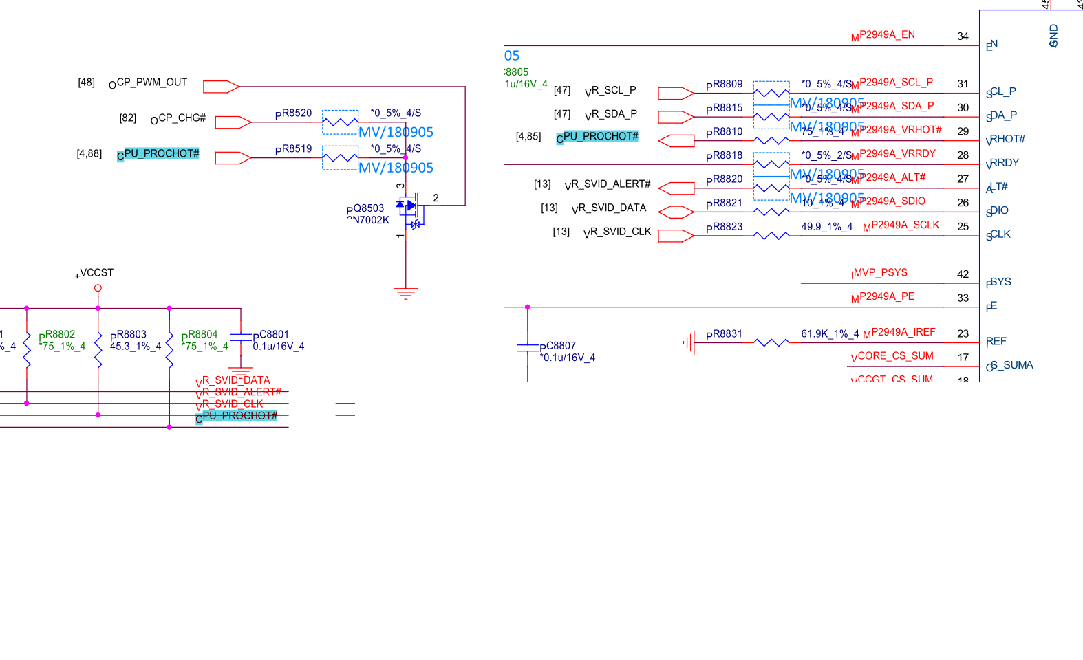

                I have seen such cases happen a lot in HP, Dell devices I want to mention to you an experience with HP 840 g5 6050a2945601 The device was very bad due to the exaggerated slowness. I decided to follow this fault from the beginning of the charging circuit to the VRM control, passing through the processor H_prochot# In the event of this signal The processor performance is pulled to its lowest levels, which is that it works at the lowest hertz and the lowest number of cores This signal is linked to the charging control and the processor on the Mediol Alermal. It is also linked to the VRM. They all have a pull up resistor with a value of 1 volt. By tracking their resistances, it became clear that there was no damage and the resistors were intact. I was only able to modify the 1 volt supply path to Hprochot# and the device returned to its performance again

                  Hi everybody. I´m gettiing the same problem with my Elitebook 840 G5. CPU stuck at 0.4Ghz. I´ve tried everything, even rollback bios to version 1.25. The issue continues.
                  ¿How can I put the 1v to the Hprochot# in the mainboard, to make the processor run as it should? Thanks.​

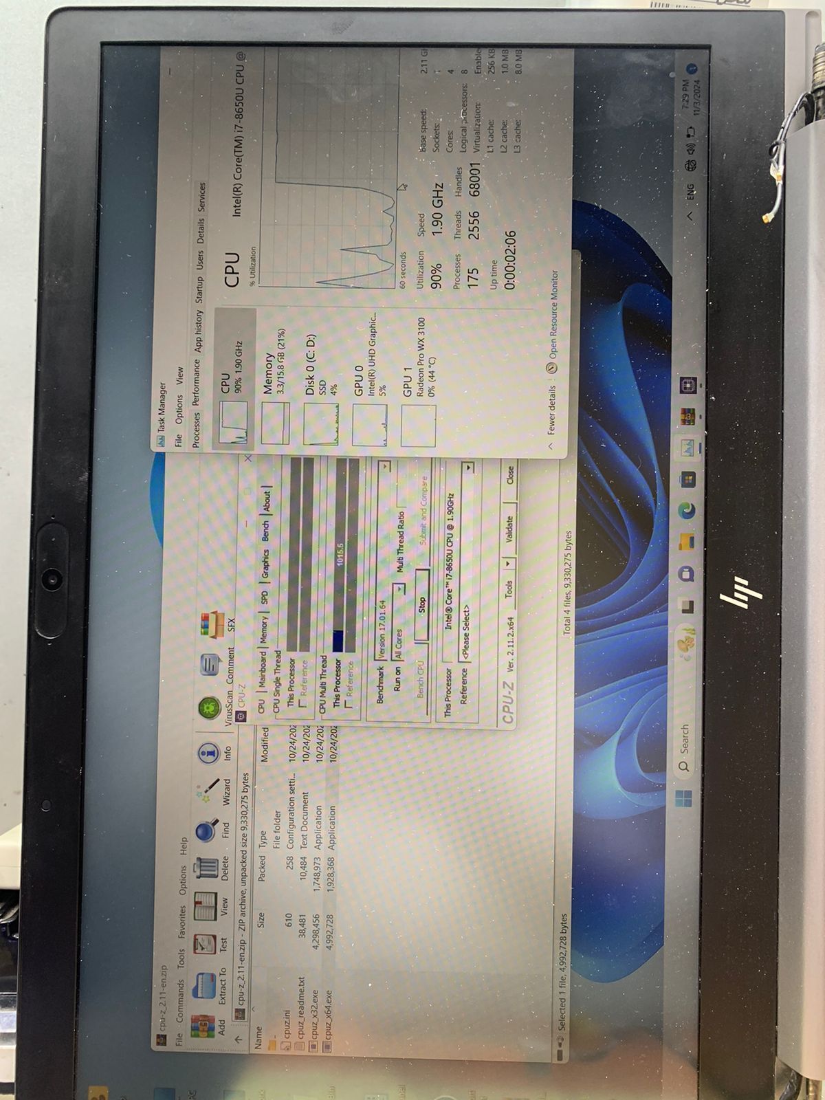

                          buchoni , chbalnuweit same problem than you, same laptop (hp Elitebook 840 G5) processor stuck at 0.4 GHz and is always in BD PROCHOT protection. Finally I could fix the problem by changing ISL9538H chip. It works for me. I hope this post will help you. Thanks
