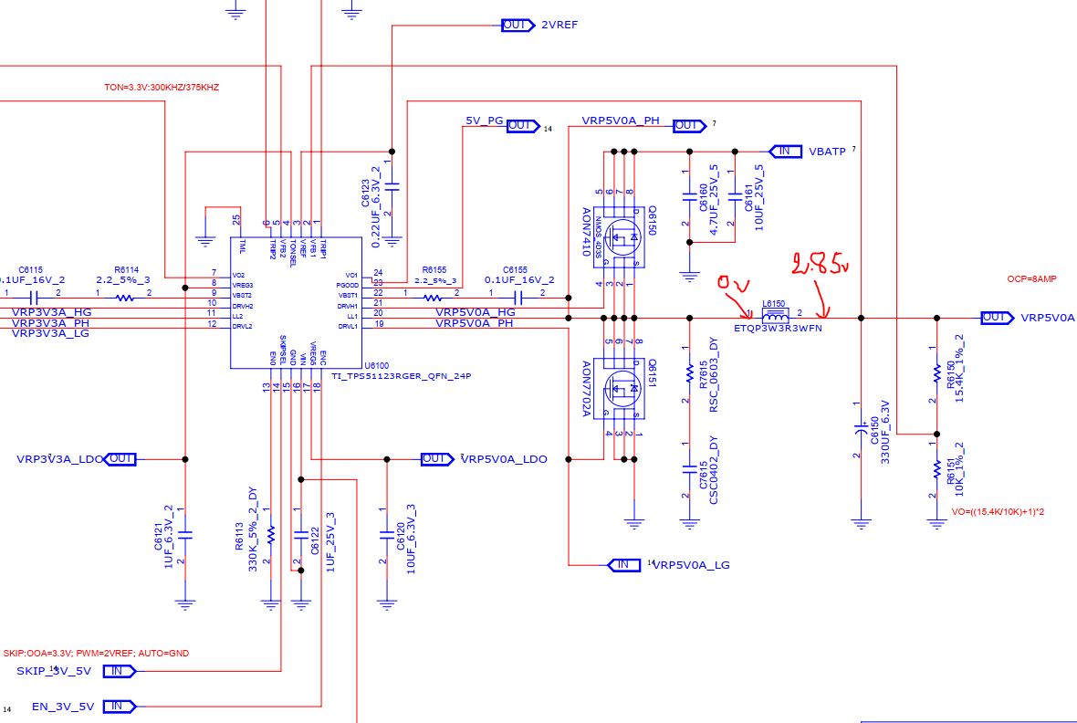

    hi
    i have laptop hp 250 g1
    laptop had many shorted component
    i solve short issue
    i replace power ic
    the original ic is tps51123
    i use RT8223 instead of 51123
    DC-in LED lights up
    i have 3.3v but no 5v ON LL2 but i get 2.85 on vo1
    is it possible the ic is defective ?
    i get the following readings on RT8223
    pin1 4.89
    pin2 1.11
    pin3 1.99
    pin4 3.36
    pin5 2
    pin6 0.78
    pin7 3.3
    pin8 3.3
    pin9 8.2
    pin10 4.12
    pin11 3.3
    pin12 4.08
    pin13 2.7
    pin14 2.7
    pin15 0
    pin16 19
    pin17 5
    pin18 0
    pin19 0
    pin20 2.8
    pin21 2.8
    pin22 4.60
    pin23 0
    pin24 2.8

    Re: hp 250 g1 missing 5v .
    Which exact p/n from Richtek did you solder in ?
    L6150 is a coil and should reflect the same voltage on both sides of this coil (magnet wire).
    Check the resistance across the 2 connections for this part - perhaps not soldered down properly or is defective.
    Also, the EN pins should be HIGH to enable the respective power rail. Check the values on Pin 1 & 6 of this IC.
    Are you 100% sure that the Richtek part can replace the original component ?
      yes i desolder the coil and messure in both side of coil
      the resistane on coil 6150=150ohm
      pin1=4.89
      pin6=0.8
      but the ic produce 3.3v normally .
      RT8223 is the equivalent of tps51123
      RT8223 EM DK B2M .
        • 21478
        TPS51123=RT8223M .The RT8223M should be marked with EQ or EQ=
        https://cdn.badcaps-static.com/pdfs/...b196680b71.pdf
          I think, If the original IC is marked EM, then replacement should be TPS51125 and not 51123.
            no it's 51123 not 51125
            i try to use 51125 but pin 18 is differnet it's EN pin .
              yes i think so
              i will search for another replacement
              i believe the problem in compatibility of ic .
                Up1585qqag (em ec) = tps51123a = rt8223p( eq=)
                  finally TPS51123 arrived from china
                  the laptop now working fine
