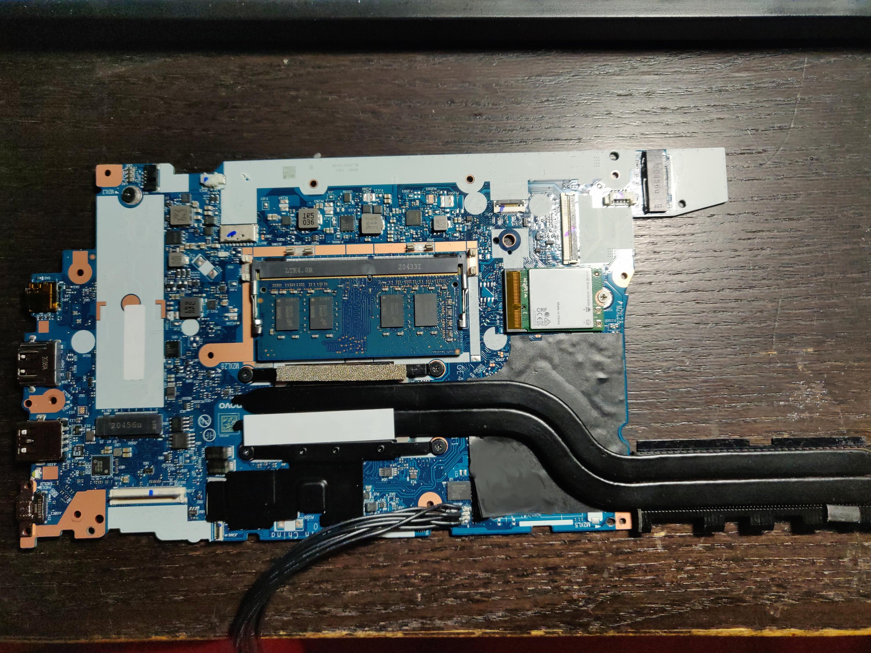

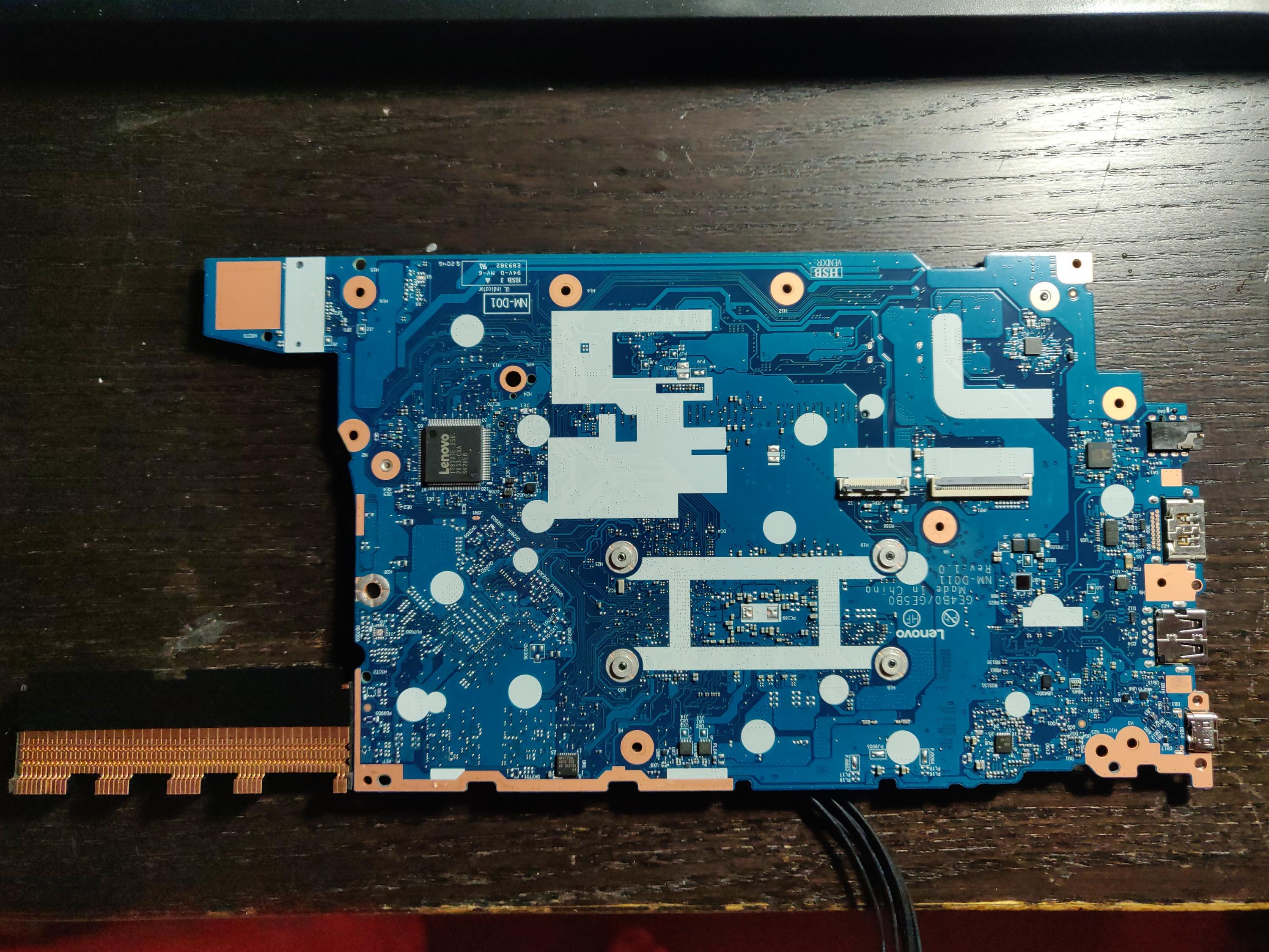

    There's this laptop that needs a new EC chip (IT8227E-256). I can buy these on Ali Express. But those would come unflashed/empty. Before I venture into this replacement, I need to dump the firmware of the original EC, and flash that onto a new EC.
    But I can't find any information at all on those.
    Do anyone out there have any pinout/schematics on these chips, and what one needs to dump and flash those?
    Maybe there's a JTAG or something similar I might have missed.
    The computer in question is a Lenovo E14 Gen2 (Quite new on the market)
    Pictures on the motherboard are attached. (See motherboard_back.jpg, middle left, for the chip in question. It's the QFP128 package with the big "Lenovo" print.)

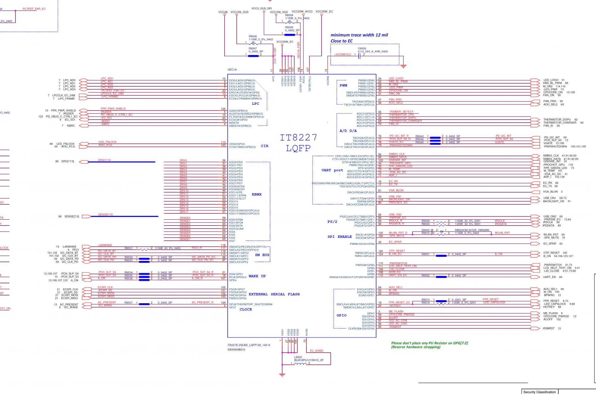

    can this help?
    • mon2
      • Dec 2019
      • 14309
      Re: Need some advice on IT8227E-256 Embedded Controller (EC))
      Not to be Debbie Downer but if this EC is not working, what are the chances the firmware can be extracted over JTAG ? I suppose it is still worth a try.
      No experience with this area yet but thought @SMDFlea or another tech noted that the EC firmware is often inside the host BIOS. If true, would the bios not reflash this firmware onto the virgin IC ? Or can the EC firmware be extracted out of the BIOS dump ?

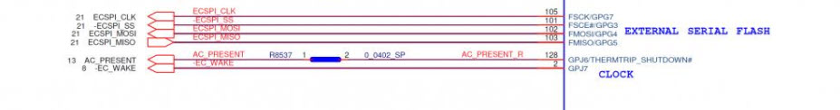

      Update - see attached portion of the pinout - thanks @m.maher!!
      From what I can gather, this EC is a SPI BUS MASTER. Respectively, the firmware is stored on an EXTERNAL SPI FLASH device. The CS pin is driven by this EC.
      Based on the direction of the arrows on the SPI pins, this EC device is the MASTER and there must be an external SPI flash that offers the firmware.
      Can you confirm this detail ? If this assumption is correct then you can solder in a 'blank' IC which then should fetch the firmware from the external SPI flash device which is still onboard.

          From what I now understand the kbc fetches the bios image of the kbc from the Winbond chip via spi. I do have a NM-B911 with the same IT8227 kbc that shows no clock.
