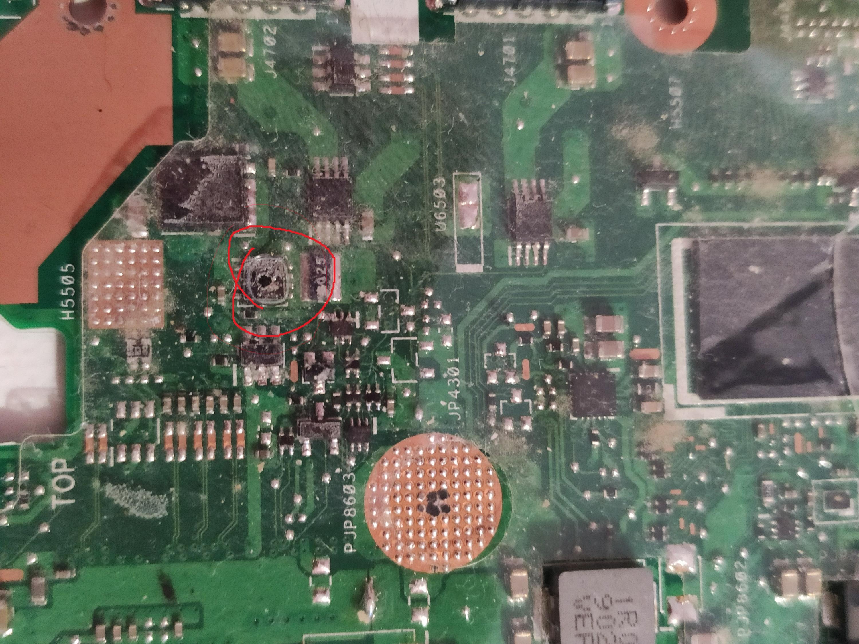

    e4065a dead
    e406s notebook totally dead, lights out.
    Customer set wrong voltage i think, nut nothing burned
    only the plastic a little burned , circle red in the pictures
  • Spider1211
    • Oct 2019
    • 532
    • Mauritius
    Re: e4065a dead
    Looks like a burnt mosfet. Remove it and check for continuity on the board (with black probe on ground). If there is no short, just replace the mosfet and try to power the board. Please provide a better picture with the plastic cover removed.

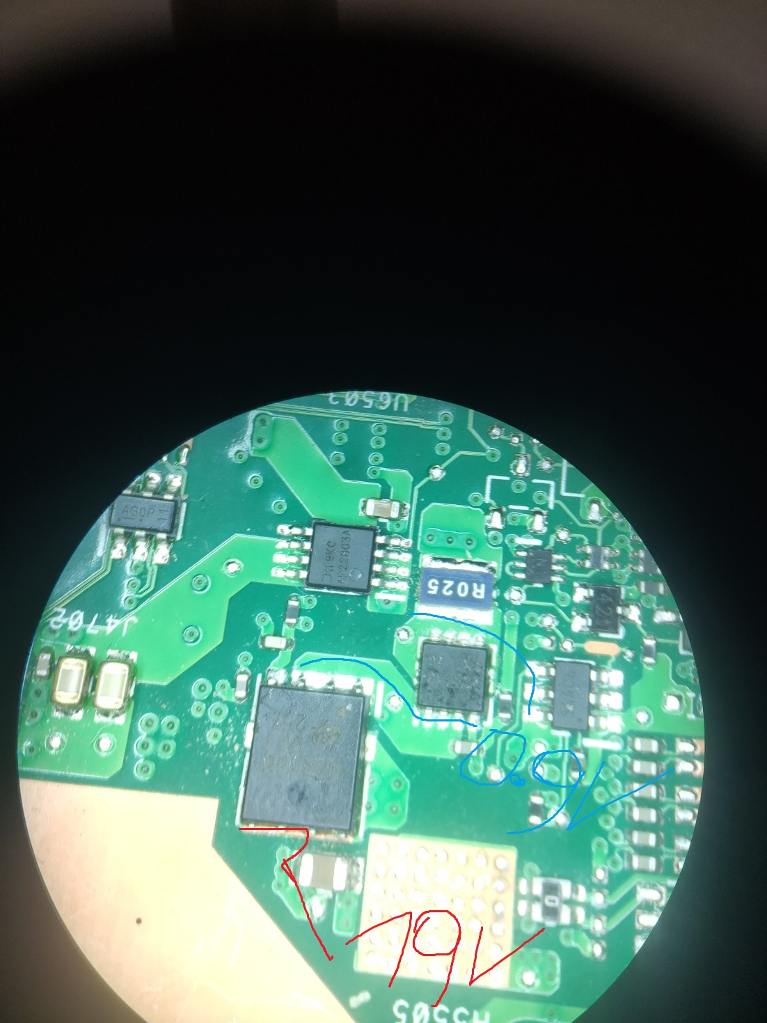

      Re: e4065a dead
      i will make a pics with camera scope later
      • lordgeny
        • Apr 2016
        • 223
        • Italia
        Re: e4065a dead
        thats it

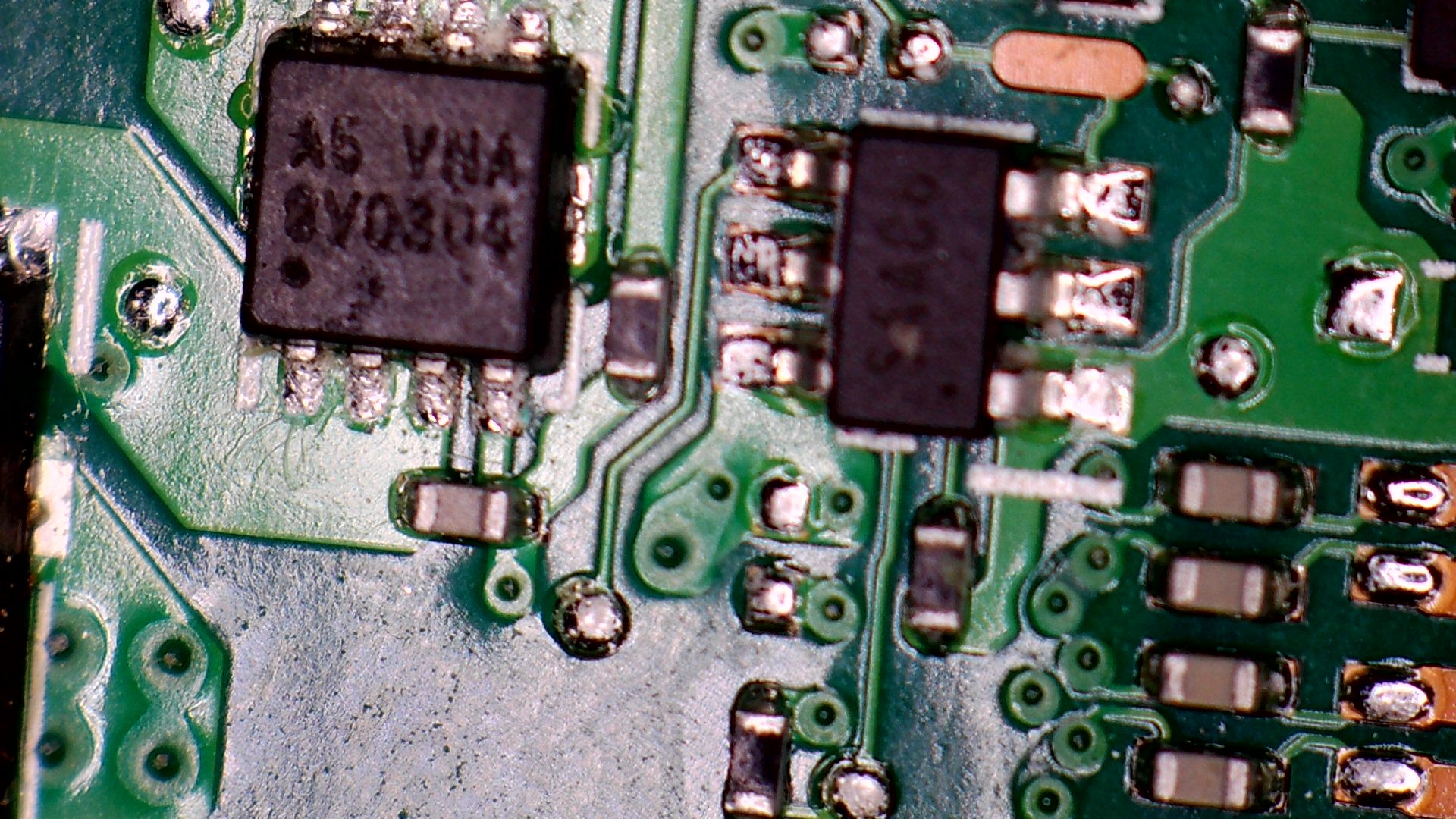

          Re: e4065a dead
          its the mosfet in details

            Re: e4065a dead
            It looks damaged, there appear to be a hole. Did you check if the mosfet is shorted?

              Re: e4065a dead
              just waiting new 861dw coming on saturdsay
              • lordgeny
                • Apr 2016
                • 223
                • Italia
                Re: e4065a dead
                i used the old baku to change with a AON7408 i get orange lighe , now i have to power on it.. it supposed its equivalent
                • Spider1211
                  • Oct 2019
                  • 532
                  • Mauritius
                  Re: e4065a dead
                  Is the laptop turning on now? Check the datasheet of the old mosfet and compare with the replacement to check if they are compatible.
                  • lordgeny
                    • Apr 2016
                    • 223
                    • Italia
                    Re: e4065a dead
                    yes its working FIXED.
