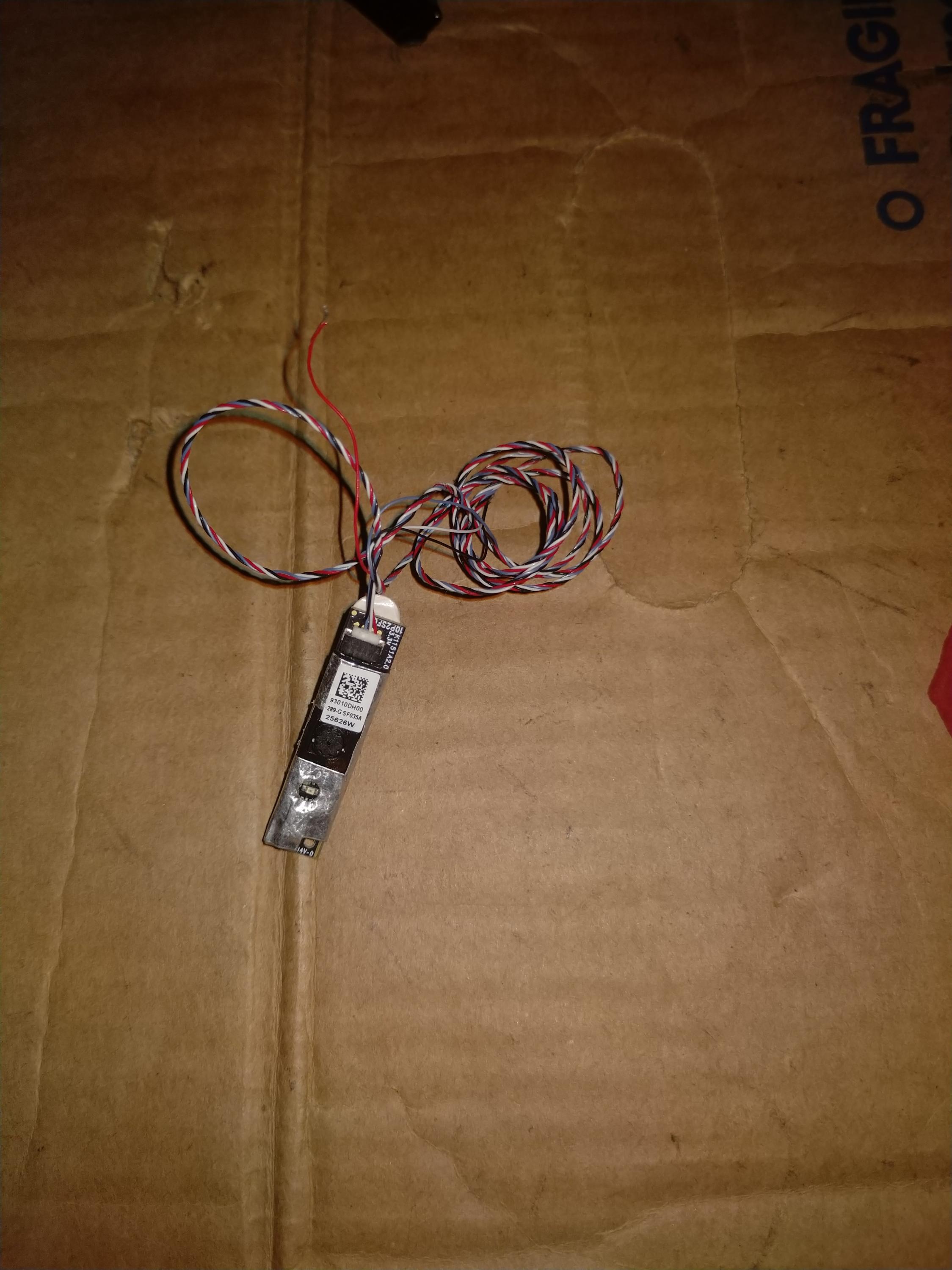

    Hello you all do you know how to adapt this DELL LATITUDE e 6530 camera module to a usb connector?
    Do you have any schematics?
    Thanks for the reply

    I apologize I forgot to specify the form code: 11P2SF117

      You can not connect that camera directly to USB, or you'll fry it rather quickly. It needs 3.3V to operate correctly, as it says on the silkscreen itself.
      If you don't want to get a voltage regulator, to minimize complexity I would recommend you use two diodes and a 100ish ohm resistor in series. But do never take this as a permanent fix for a permanent project.
      Hope you have the original loom that plugged into the motherboard. That way you can easily get the pinout from the following part of the schematic:
