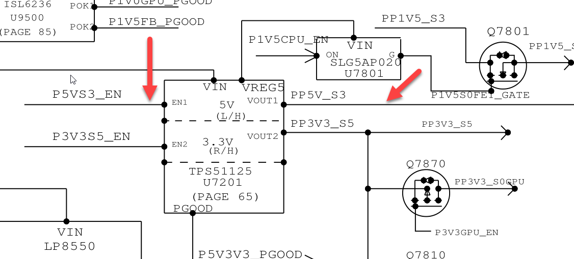

Macbook Pro A1286 GPU issue - Fan spin 2 seconds
  • simplylcd
    • Nov 2015
    • 13
    • United Kingdom
    820-2915 MacBook - No screen / no boot / no chime just fans spins for about 2/3 seconds
    I have already checked the following core voltages:
    ppbus_g3h=12.5v
    Dcin = 16v
    pp3v42_g3h =3.4v
    ppvrtc_g3h= 3.3v
    PP5V_S5=5v
    PP5V_SUS=5v
    PP5V_S3=0v
    When I short power on pads , fans spin then shuts down and pp5v_s3=5v for about 2 seconds then shutdown to 0v.
    I removed L2406 so I could program the g-mux but the same thing was happening - on , fan spin , off
    ppvcore_gpu diode = 0v
    ppvcore_gpu = 4.5 ohms
    Any tips would be useful.
  • mon2
    • Dec 2019
    • 13940

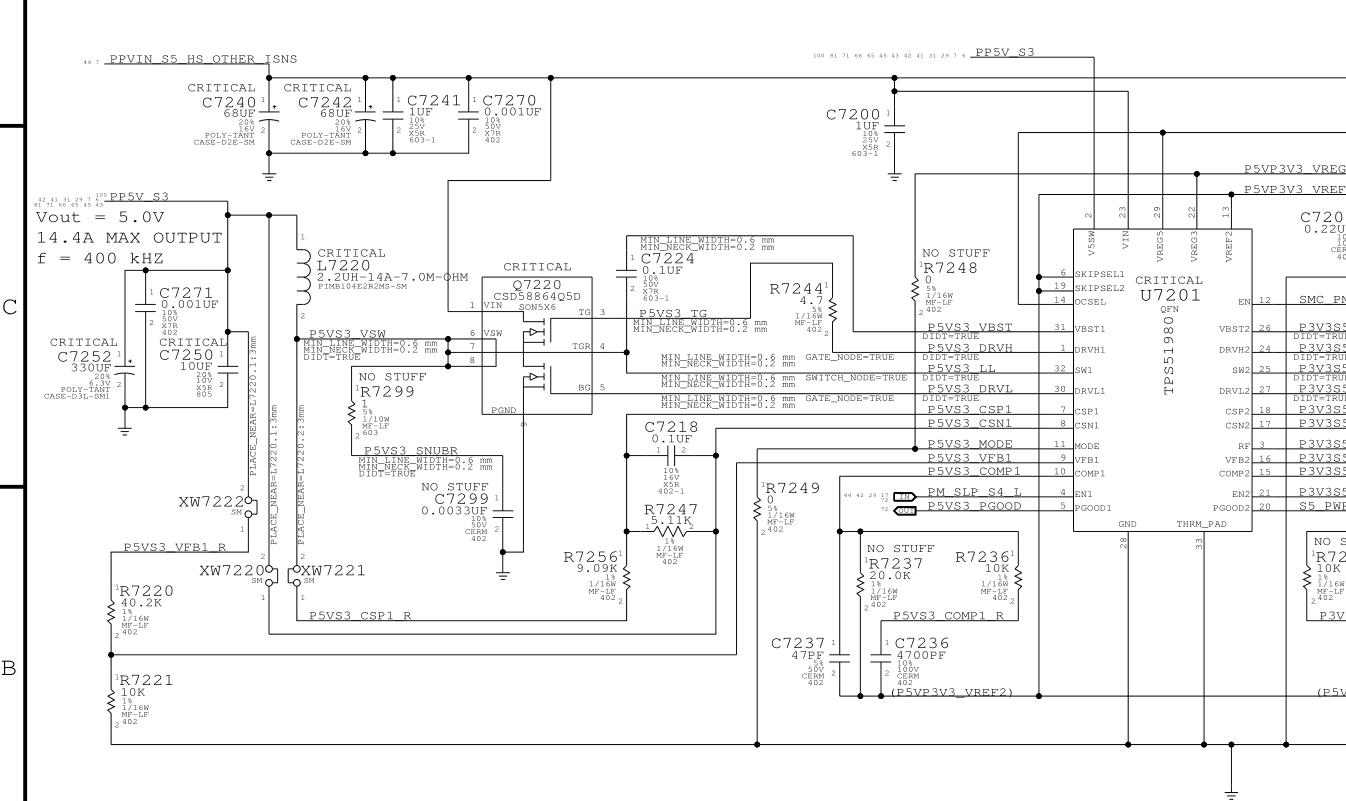

    Re: Macbook Pro A1286 GPU issue - Fan spin 2 seconds
    Check the ENABLE pin - what is voltage value?
    Check the output of this regulator -> what is the voltage value?
    You may have a shorted cap at the output of this voltage regulator.
    Respectively, power down (after checking the above); check the resistance on the output of this regulator / power rail to ground @ L7220 pin # 1.
    What is the resistance reading?
    See attached.
