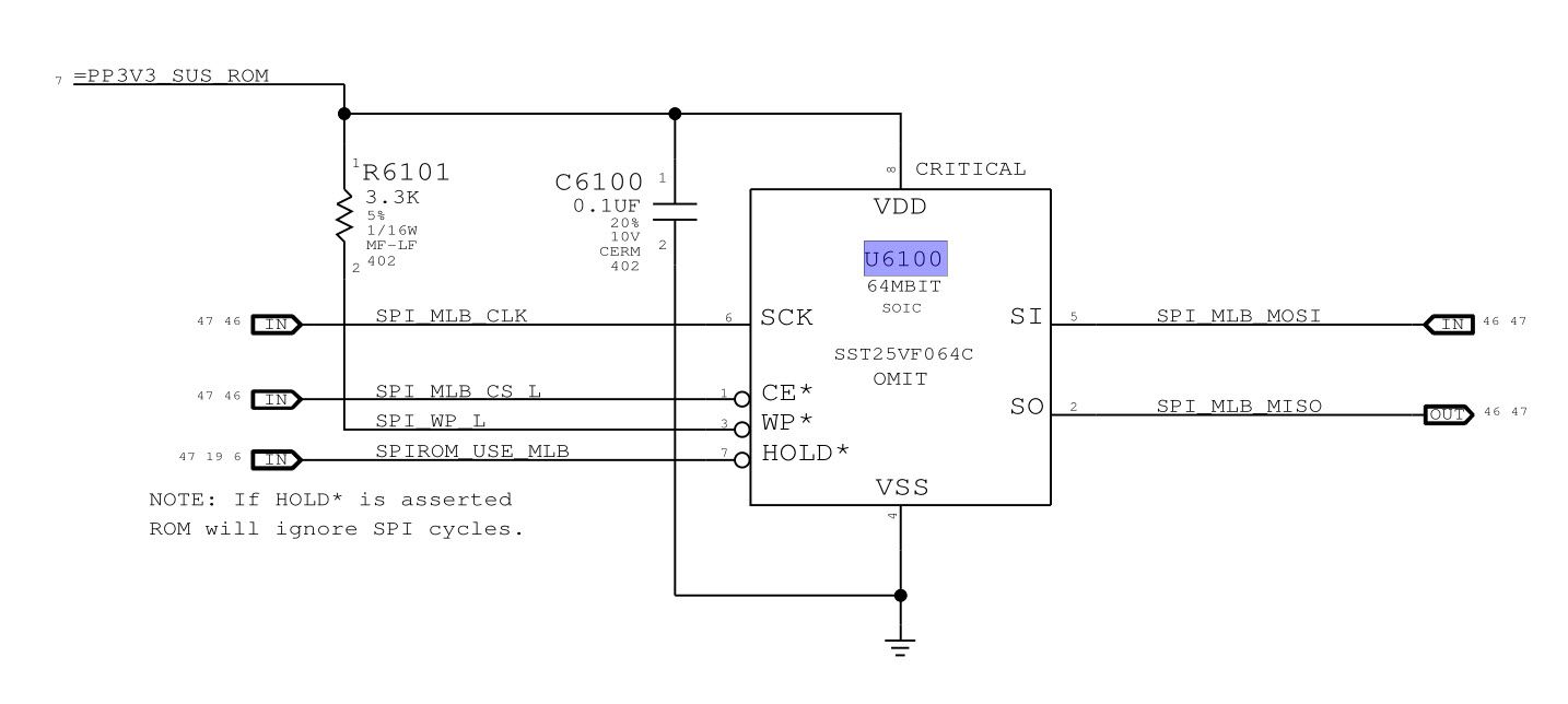

              The bios to review is @ U6100.
              Before we jump to reflashing, can you do the following ?
              Meter in DC volts scale (5 volts or higher is ok).
              Carefully check the voltage to ground of each pin on the U6100 BIOS. We want to be sure that the power rails are ok; the signal rails are actually reaching the BIOS chip.
              This is an 8 pin SOIC package so should be ok to probe with care while the unit is powered.

                    Re: MacBook Pro Mid 2012 turns on, fans spin for five seconds and turns off, repeats
                    Hi mon2,
                    Pin 1: 3.32V
                    Pin 2: 3.28V
                    Pin 3: 3.32V
                    Pin 4: GND
                    Pin 5: 0.00V
                    Pin 6: 0.00V
                    Pin 7: 3.02V
                    Pin 8: 3.32V
                    No liquid damage, machine looks very clean.

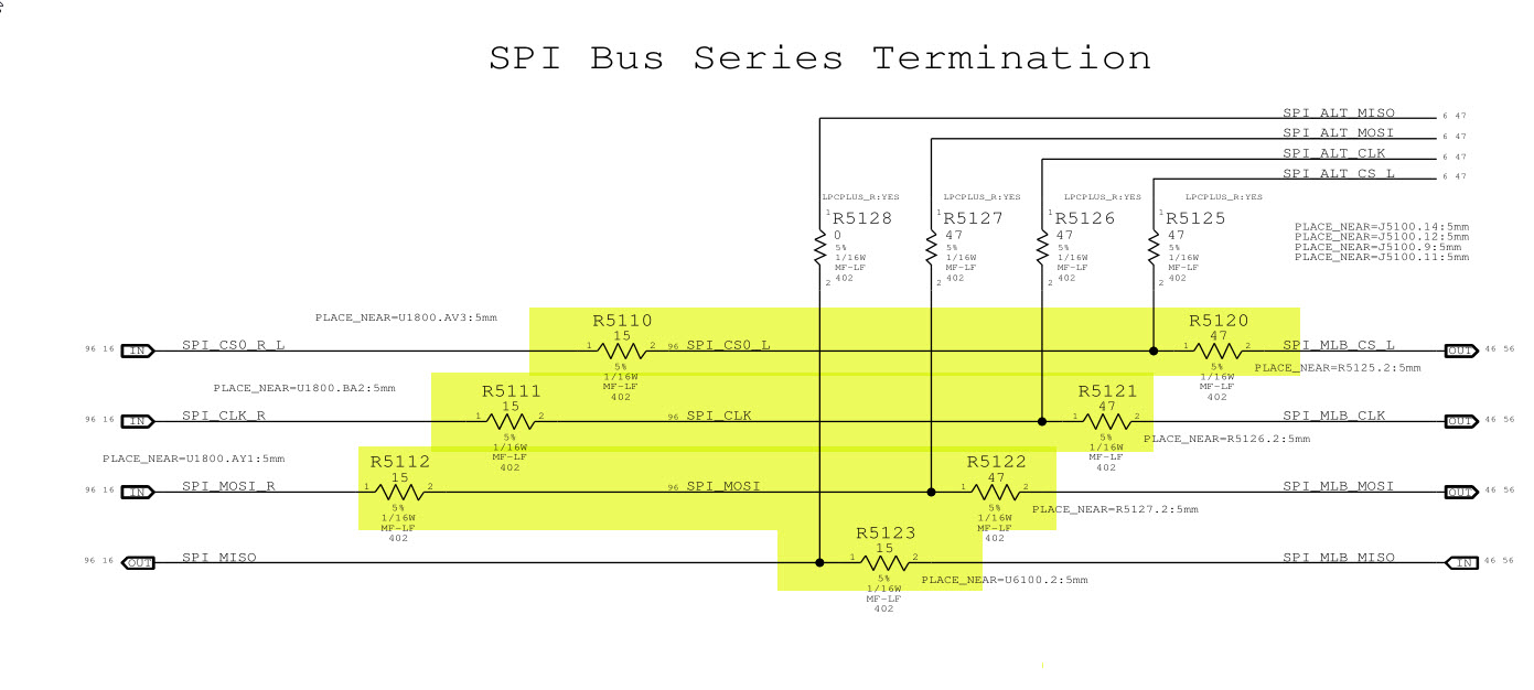

                      Confirm that the series resistors are present and not damaged.
                      You can measure the resistance from one side to the other - no power during resistance measurements.
                        R5110: 0.02
                        R5120: 0.06
                        R5111: 0.02
                        R5121: 0.06
                        R5112: 0.03
                        R5122: 0.06
                        R5123: 3.28
                        All measured on 20k mode
                            R5123: 3.28
                            this one does not look correct. Can you check it again ?
                            it should be ~0.02 if using 20k scale.
                            Better is you use the lowest ohms scale so that we can read as ~15 ohms.
                                R5123 measuring 14.8 on 200 mode @mon2.
                                • mon2
                                  • Dec 2019
                                  • 14612
                                  ~15 ohms is ok.

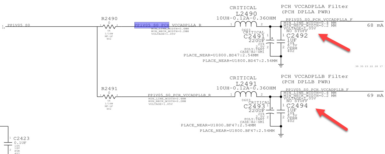

                                  Confirm the voltage on the attached power rails.
                                  Do they match the values in the schematic?
                                    C2492 is missing but at pin 1 is showing 1.04V.
                                    C2494 is missing, showing 0.95V when fan spinning, 0.2V when fan not spinning
                                    • Gigabit2
                                      • Apr 2022
                                      • 264
                                      • United Kingdom
                                      After re-test, C2494 is missing but at pin 1 showing 1.04V.
                                        Both caps are marked as NO STUFF so that is ok. Another tech on Logiwiki referenced that this caused the same fault as yours because he had a broken resistor @ R2491.
