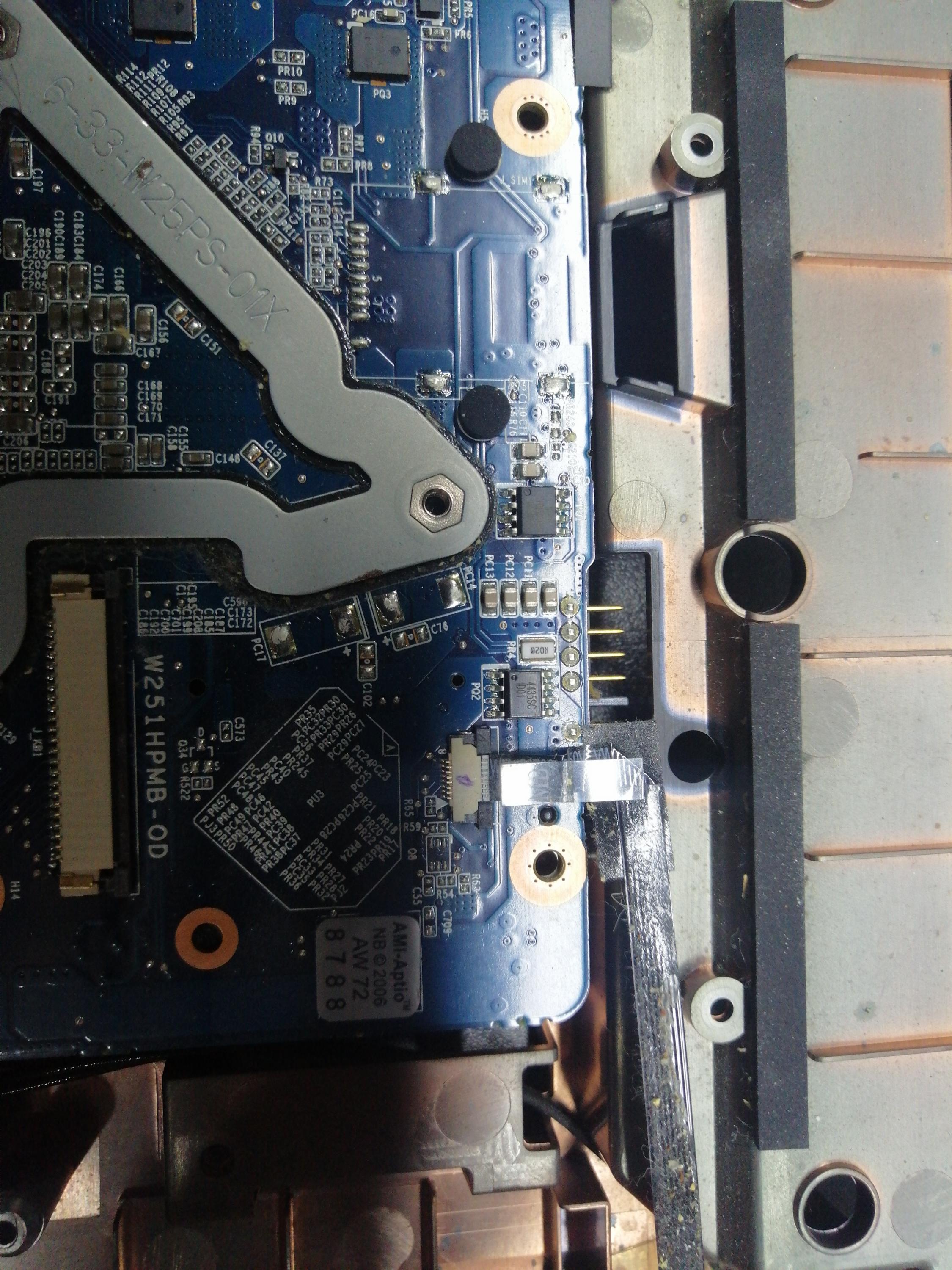

    Hello!
    I have a Dell Inspiron 15 5567 / with I5 processor / laptop, but unfortunately it doesn't charge and doesn't work from a charger either.
    Some circuit is maybe broken
    However, it runs on battery power until it is depleted.
    I was thinking of replacing the battery with an power adapter.
    Does anyone have any idea how to solve this?

    Usually there is a problem with the charge ic. did you measure it up while battery output pins are plugged in and out?

      Re: Dell Inspiron 5567 power replacment
      No.
      How and where can i measure it?
      I have just an simple multimeter.
      Battery is empty....

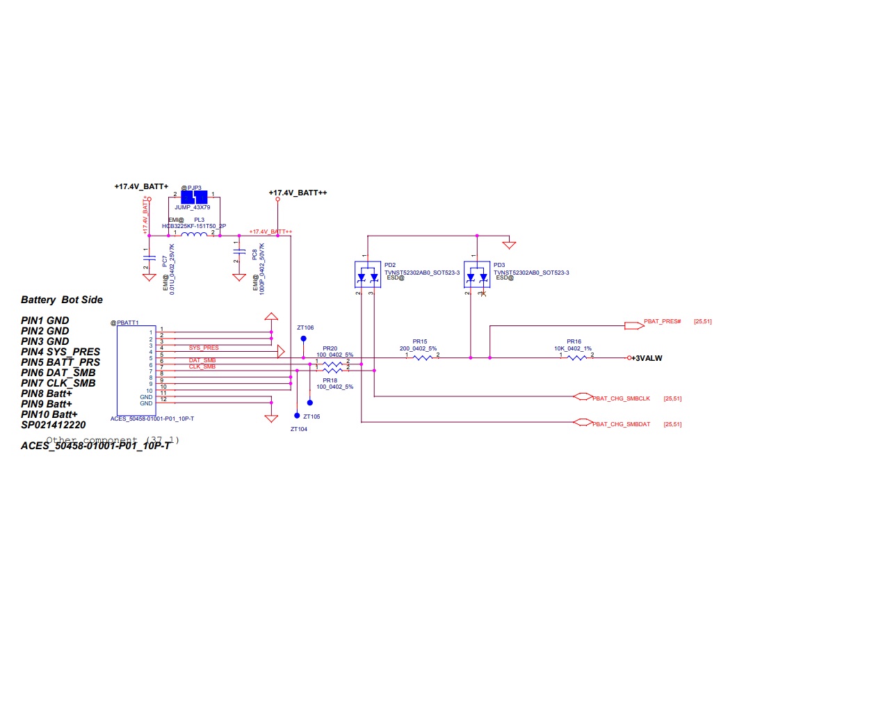

            First of we need to see output and input voltage from pins with batarry and without battery

              Pins 13, 1, 2, 3, 4 of the PU703 charge control chip must be checked. to detect the battery. and PJDC1 DC input socket 3 pins ADP_ID must be checked.
                Thank You guys for the answers, I'm glad for them!
                But sadly, i don't have any equipments for fix the board.
                Can anyone help to me pinout of the battery?
                Functions, polarity and the power/pins?
