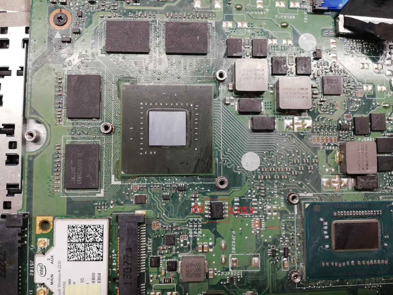

    Hello.
    I got a faulty Asus K56CB-XO488H laptop that did not turn on. The problem was the BIOS. On this forum I got a BIOS dump which I flashed to new chip.
    The laptop is working now. There is only one problem with it. The laptop has Intel HD 4000 and Nvidia GT740m. Only the Intel HD 4000 appears in Device Manager. There is no setting in the BIOS to disable it. I also tried updating the BIOS, it didn't help. The Nvidia Chip doesn't even heat up.
    Could it have to do with having a bios dump from the forum and not the original? Or need to look for the fault elsewhere?

                Could there be a similar problem? Lenovo U510 LA-8972P. Despite the display screen, the video card is not seen in the device management, PU801 GPU power control RT8813A chip no + 5v at 21 pin, 2.2 ohm protection resistor open circuit. The chip was replaced and the problem was resolved. Check the VGA_GPU voltages.

                  I'm still a beginner in these so I don't really know what to look for.
                  There is a mosfet (Nikos P1203BV) between the processor and the NVIDIA chip. I noticed that the Drain pin is 1.05V, but the Source and Gate pin are 0V. Could this be a problem?

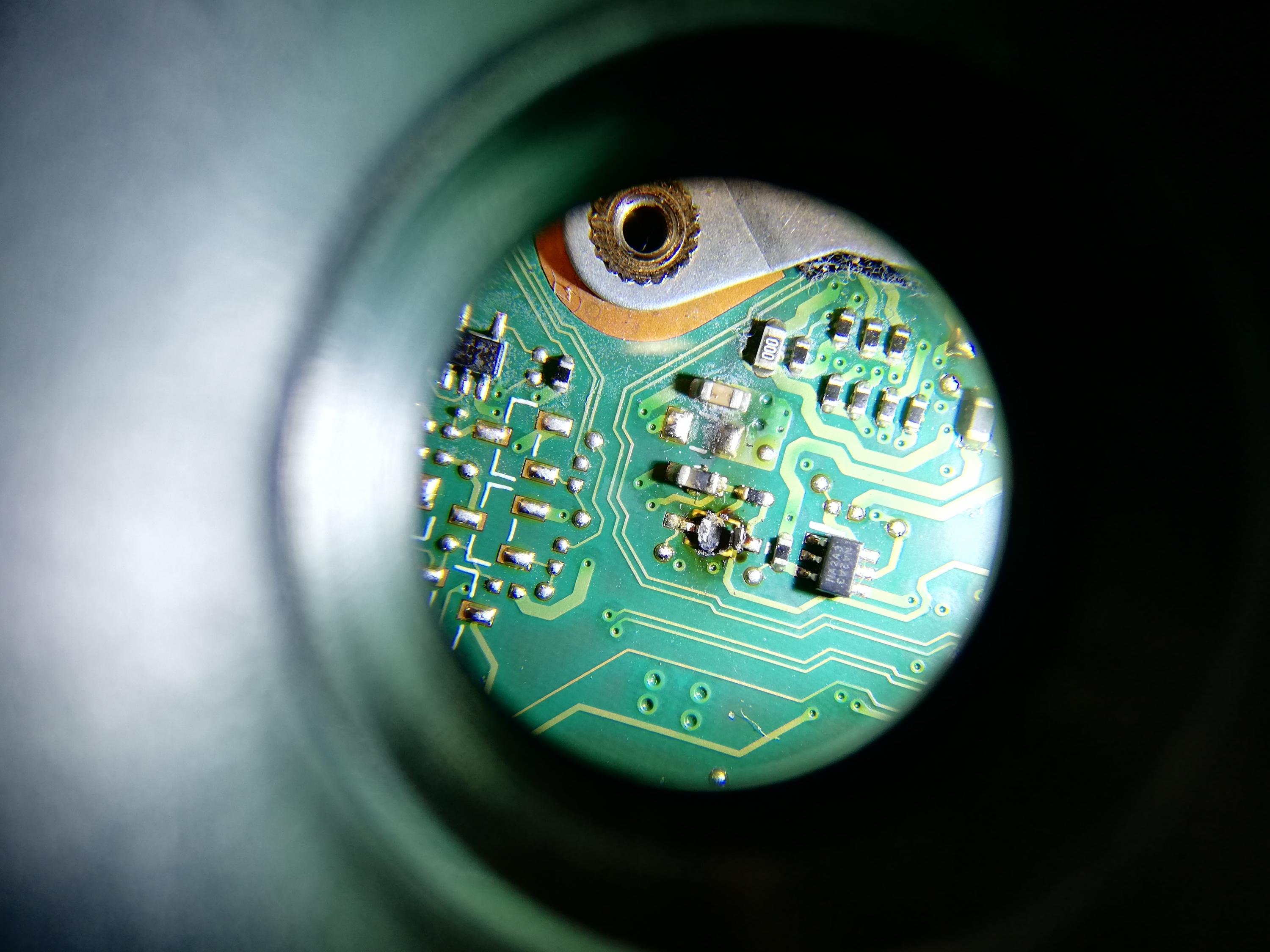

                    Re: Asus K56CB-XO488H not detect Nvidia GT740M
                    I just noticed that a capacitor and a diode(maybe) on the other side has burned.
