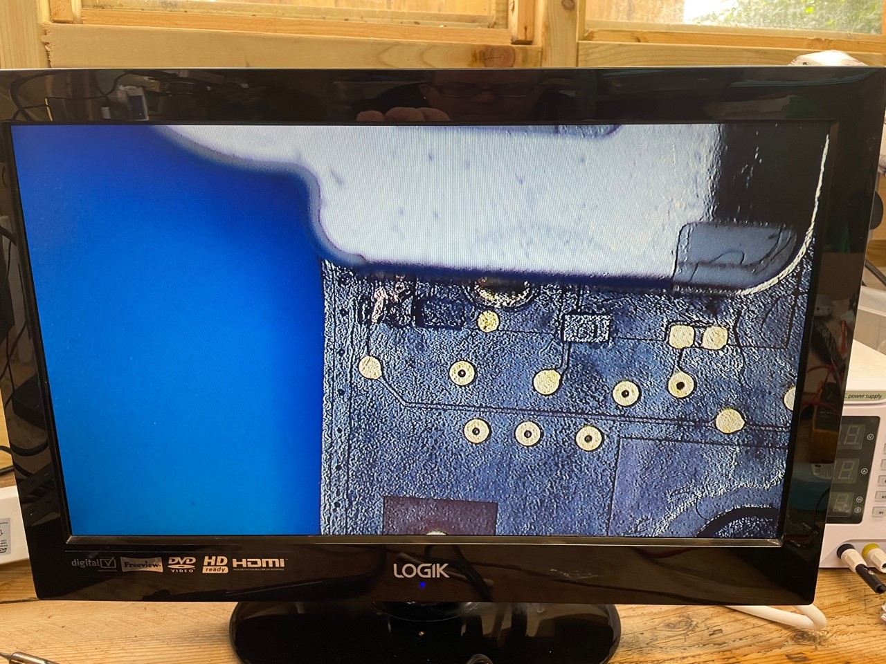

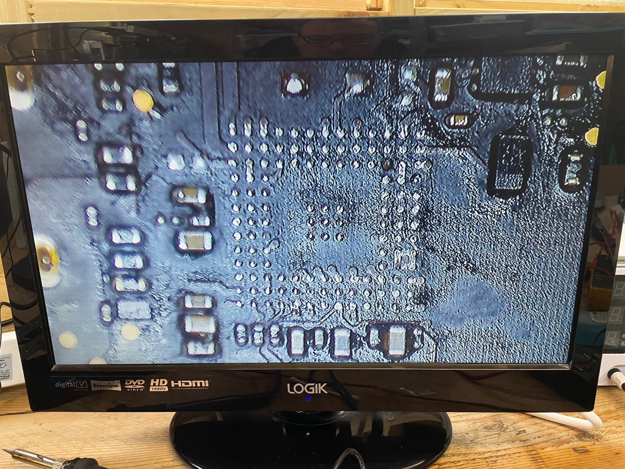

          Update. It looks like this board has been worked on before. U6201 is missing completely from the board, DZ6606 has blown, and burnt out the tracks close by.
          Looks like this one is a parts only board now.
          Thanks for your help.

            Upload photo, maybe its still fixable.

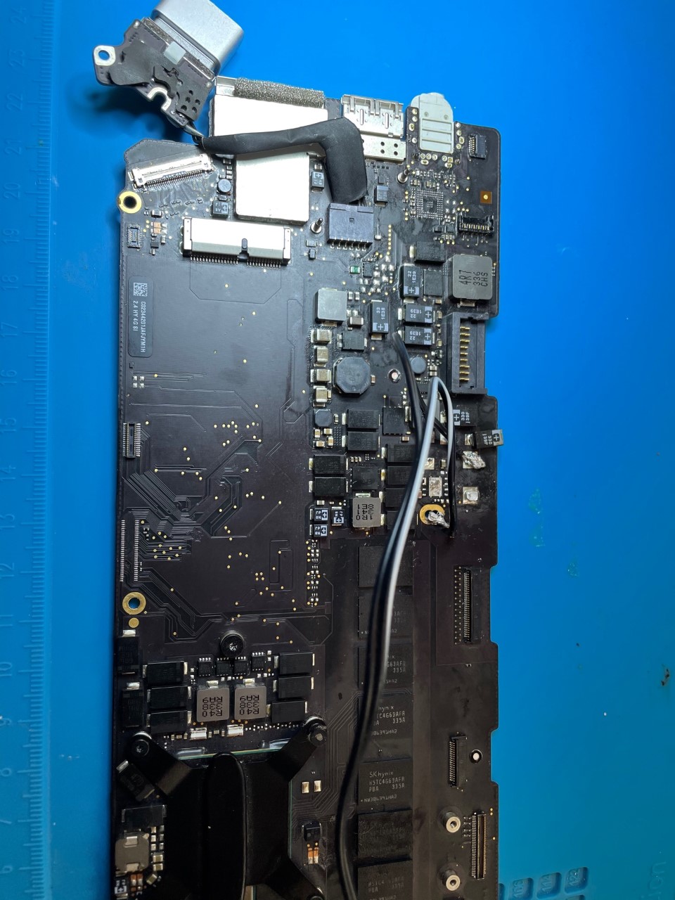

            • mrtutz
              • Jun 2020
              • 12
              • United Kingdom
              Re: Macbook 820-3536A Problem
              Hi zpi.
              See attached images. They're not the best but will hopefully be OK. I ordered a replacement logic board from Aliexpress, which should arrive in 20-40 days. I would still like to attempt to repair this board if its possible.

                Board can work without this chip, its sound card, those contacts near headphones also looks like they are for headphone jack. Try to find heating elements on board when injecting voltage to l7520.
                My bet is that U6201 was removed because it had hole in it, because it is driven by 5v_s4, you should find shorted cap while injecting voltage, and board will work
