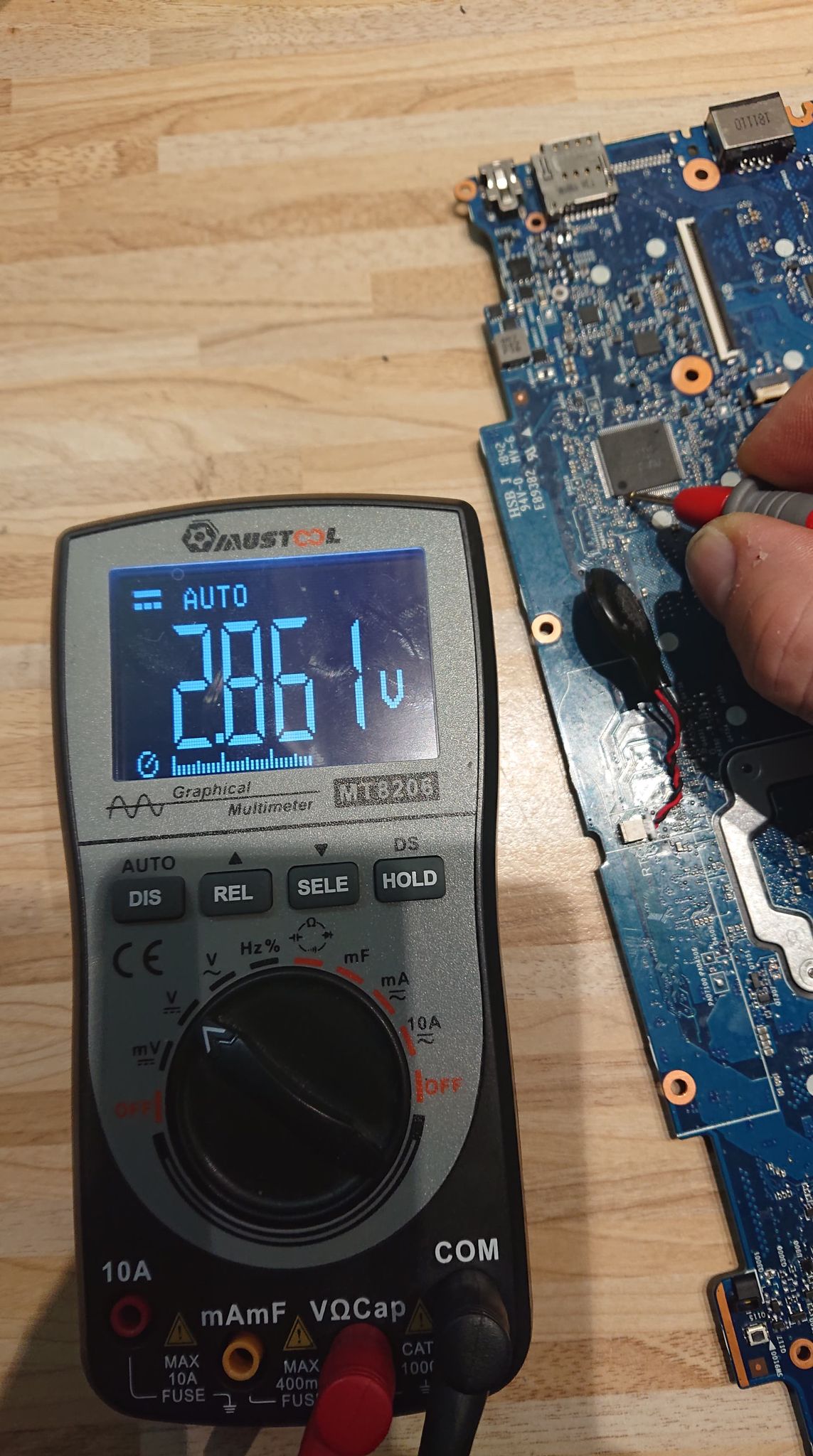

    Hi! Please help! Hp 820 g3 will not start. pressing the power button does not turn on. if the battery is removed and then reinserted, the machine will start automatically until it is switched off with the power button. bios is good, power button is good! rtc battery is good!
    has anyone encountered such an error? so: the machine only works if we unplug it and reinstall the battery, then it will turn on automatically, windows will load. if stopped, it will no longer start.

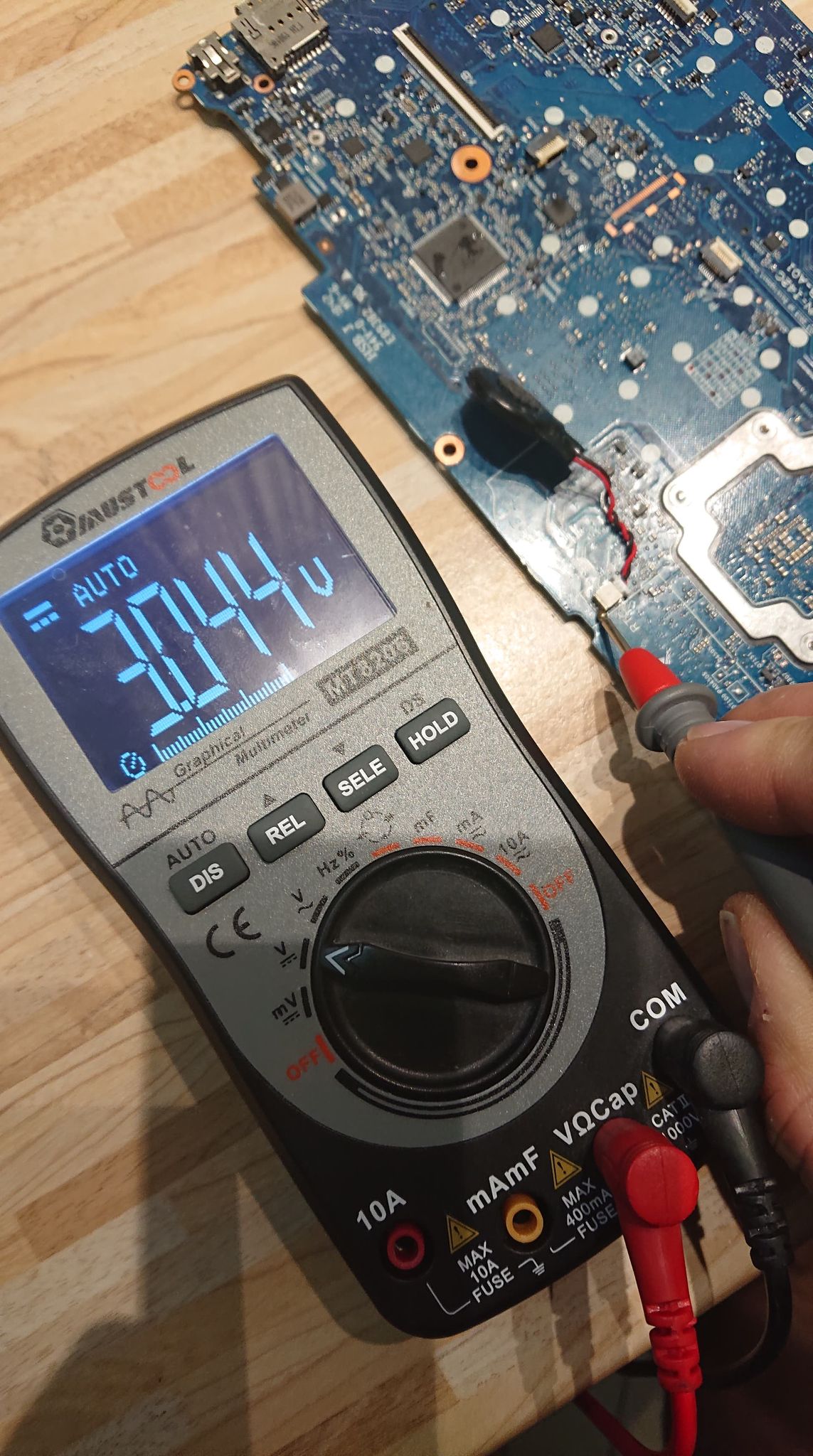

        Hi! does not start from the battery (full charge) and does not start from the charger. Even if it is unplugged and you either replace the battery or plug in a charger without a battery, it will start immediately without pressing the power button. there is a separate RTC element whose voltage reaches the nuvoton chip. mystery......
        mn in review, there is no corrosion oxidation ..... but maybe the fault has something to do with rtc. suspicious Nuvoton chip?

          Before we start processing on laptop motherboard it is in our benefit to check all possibilities of laptop condition gets normal without checking motherboard itself.
          1- Go in Bios settings and load default settings and change power settings in windows too.
          2-Try Hard Reset
          Remove all accessories , remove battery and RTC cell.
          ( check voltage on RTC cell using a multimeter it should be greater than 2.8 volts)
          wait for 30min
          after 30min ,insert Cmos cell again and Press power button for 30 second and release the button now start the laptop it will work.

            Having good voltage on RTC cell is not enough. You need to check RTC_RST# as well as SRTC_RST#. Look for a triangle shaped jumper near PCH. thats your RTC_RST# location.

              • O.Szilard
                • May 2019
                • 161
                • hungary
                Re: help! Hp 820 g3 will not start
                voltage is OK, it is difficult to find a fault in the absence of a circuit diagram
