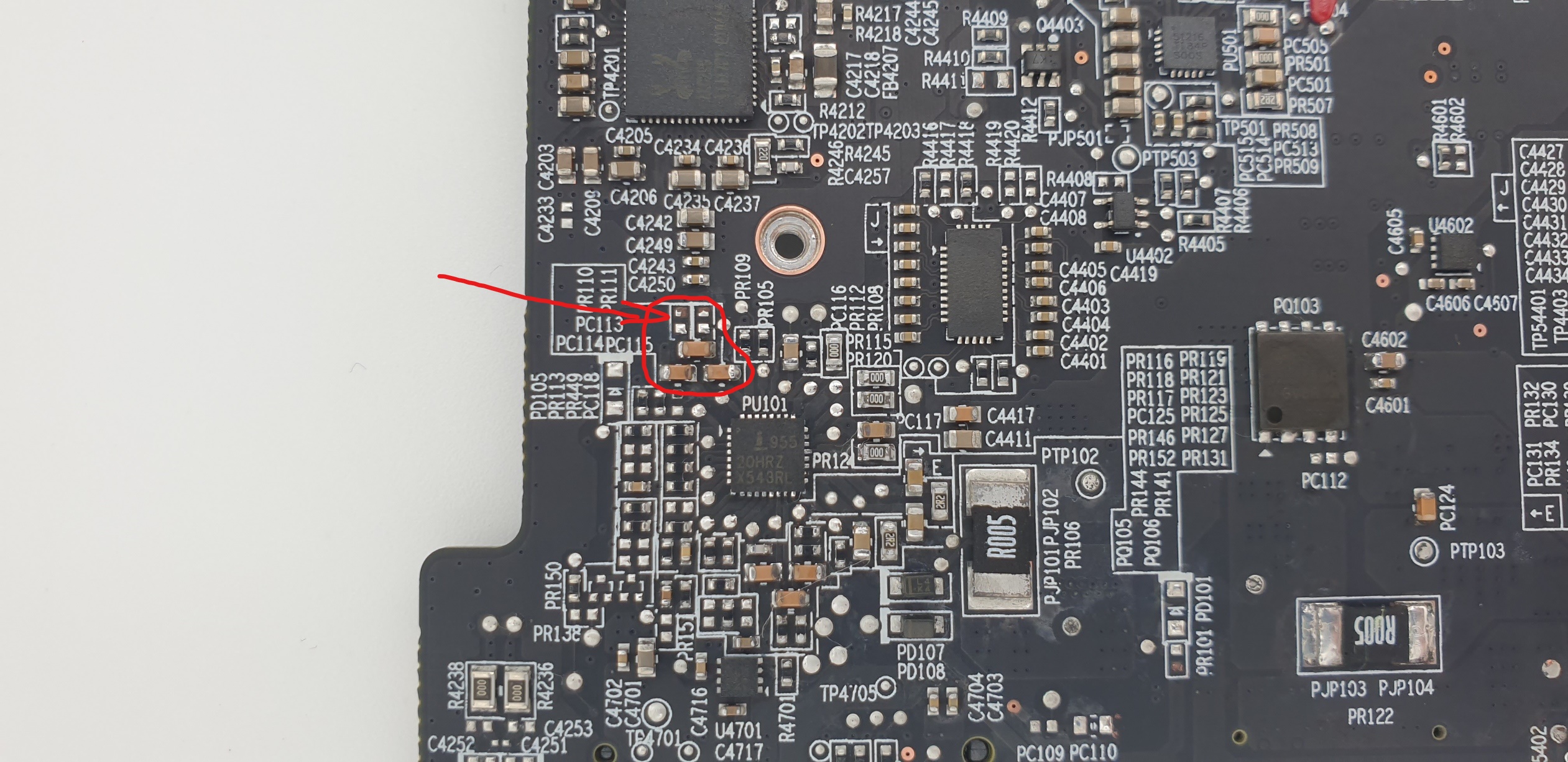

    Can someone help identify the missing resistors and any of the other damaged components if possible (check the attached image)
    The laptop is Razor Blade 15 RZ09-02385
    The 2 resistors are part of the ISL955 circuit, probably battery charging IC

    Missing resistor are PR110/111. You need to check on which pin of ISL95520 are they connected. Open up any other schematic which have isl95520 and findout the value of resistor according to pin number concerned. This way you will get 90% accurate vale of resistors though it may vary from platform to platform a bit.

      Any suggestions on which brand to look at?
      I have no idea what laptops use ISL955

          LA-D071P. Use this schematic. Its available on our forum.
