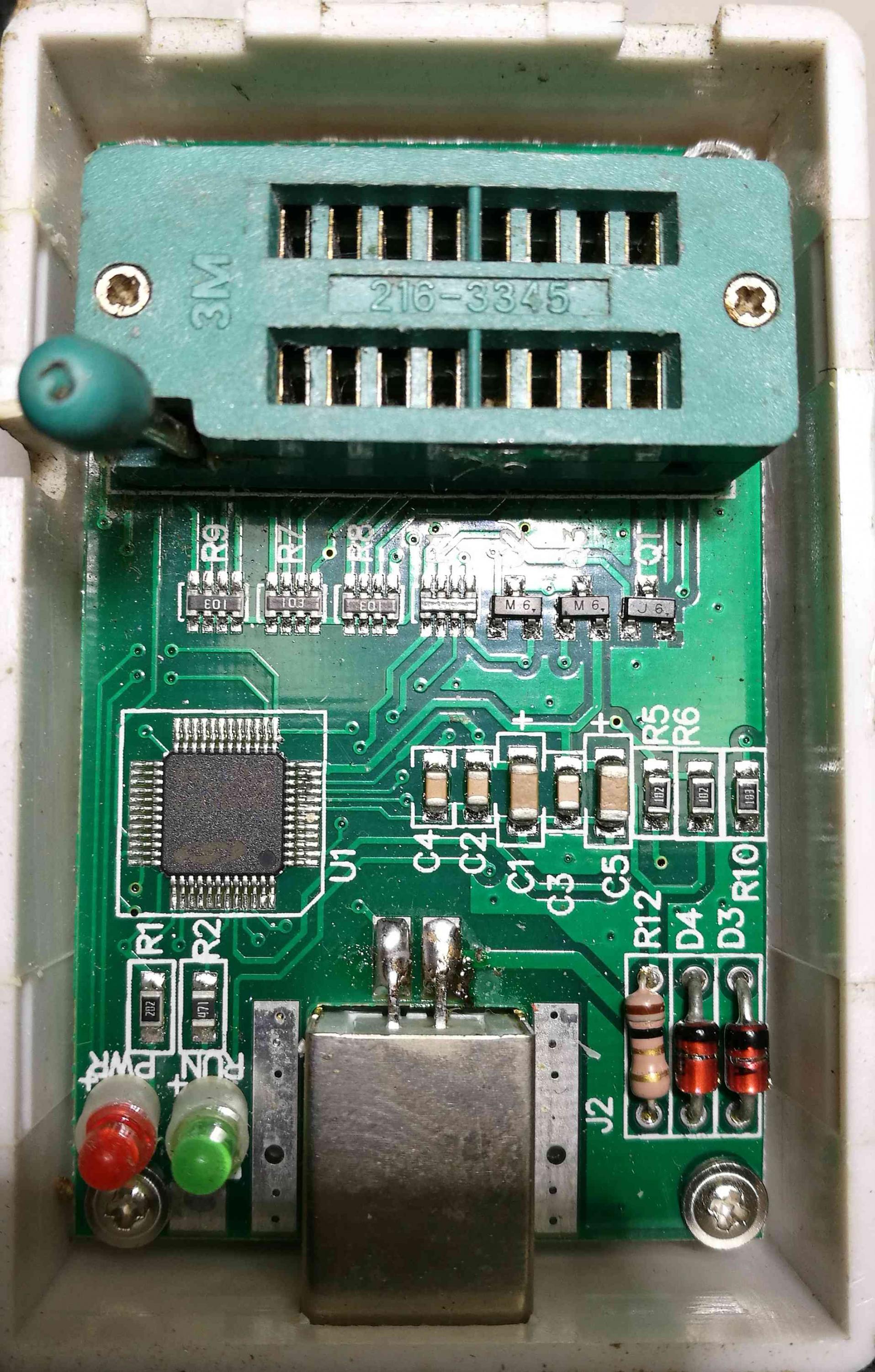

            Originally posted by jasko_jacker
            I use EZP2010, many say it is not recommended (I don't understand why).
            It boils down to quality and "best bang for the buck".
            Here's a quick snips of the internals (there are more equally crappy versions of this, but that's the only one I found):
            Basically, if you ignore that dubious "offline copy" feature, it doesn't do anything that you can't accomplish with a $2.50-$3.00 CH341 programmer.
            It doesn't have proper TTL control : only drops VCC/RST to a ballpark of 3.3V (whatever Vdrop on that diode and tranistors, basically), and the rest is handled by current-limiting resistors on data lines, which is not good...
            Basically it's the bottom of the barrel, but costs almost as much as a semi-decent serial programmer.
            I mean, if you already have it - you can make it work. For example, you can mod the 1.8V adapter to do all voltages w/ proper TTL conversion on I/O, disintegrate that questionable diode and replace it with an LDO etc.
            But as a new purchase ...
