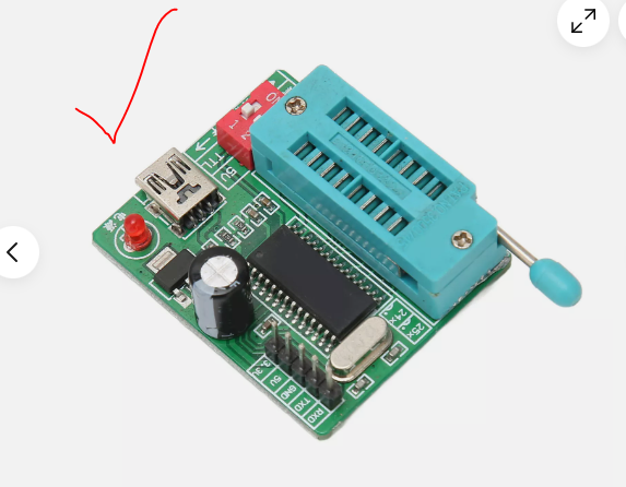

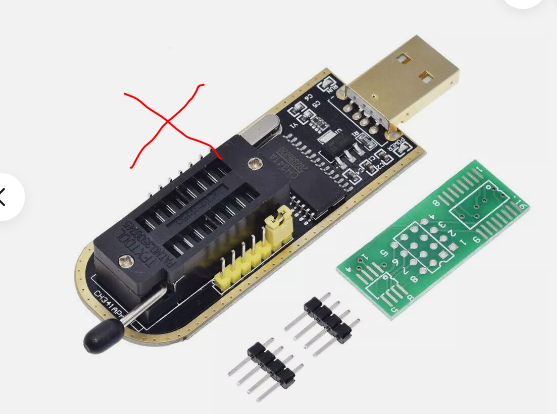

    Everyone is buying the wrong CH341A programmer, I have learned from my mistake. Don't buy the Black one or Green one.
    Buy this one in the photo. Most stable and all your common problems (reading but not writing/erasing, software hanging, disconnects after attaching chip, test cable connected but chip not found/ device disconnected) will be gone.
    Otherwise you'll have to solder capacitor from GND to VCC if you have those symptoms in your black or green miniprogrammer.

    if it uses a different chip and can program 1.8v parts then good, otherwise i wouldnt buy any of them.
    invest in a T48 or T56.
    i know the T48 is 10x the cost but it's an investment

      No you shouldnt buy any of them. Try to understand what I am trying to say. Chip is not the matter here. That big electrolytic capacitor in important.

          You will find the one I have recommended in ebay. Or if you face the symptoms I have mentioned you can solder a 10v 100uf or above cap(im using 10v 470uf) with it also you can solder a smd ceramic cap(1uf or above) parallally if you want. adding the electrolytic one will do the job just fine.

                The one I have mentioned has 3.3v and 5v switch(adjustable) only lacking is 1.8v .... I know about this green adjustable version from aliexpress too but doubt it someone is not having problem without a big cap using the test clip, disconnecting the moment clip touches the chip or reading but not erasing or writing software hanging sudden connection drop etc unstable situation. . I dont trust chinese SMD caps. May be it is because of chinese low quality SMD caps and voltage dropping too low. Anyway its fixable so yes get between these two but know the symptoms and how to fix it. A big cap is necessary sometimes for the test clip to work.

                    I second this one it's worth the cost if you are programming chips more than once a year. Even then it's worth it because you'll know if it doesn't work its the code you're programming or the chip itself and not the programmer not doing its job right. Fought the cheap ones for way to long before I upgraded and it was worth it on the first chip I programmed. The software with the T48/T56 is also just so much nicer than the stuff that comes with the CH341's.
                    This being said I do still use a modified CH341 like the usb on in the picture with an X in the original post. I modified it to be compatible with reading error logs on the ps5 and reading/editing the NOR on the PS5. Works great for that since console service tool is basically built around that. I guess the BWE software technically is to but I steer clear of BWE software when I can.
