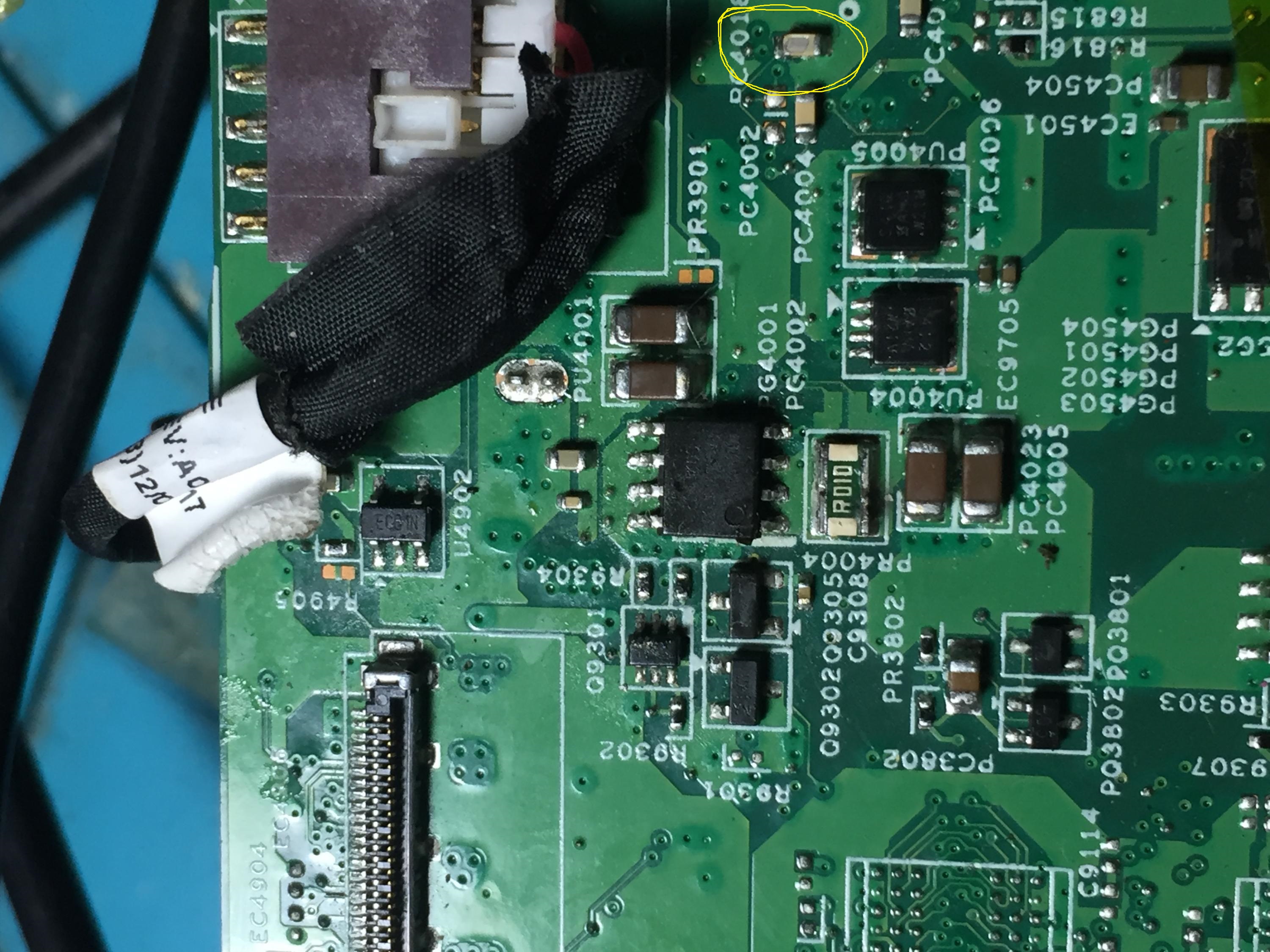

lenovo b470 turns on only on battery

      Re: lenovo b470 turns on only on battery
      does this pr4005 have problem because it reads only 10k
      • lapfix
        Use diode mode on multimeter to take the impedence on PR4004 and PR4005 (side1 ).

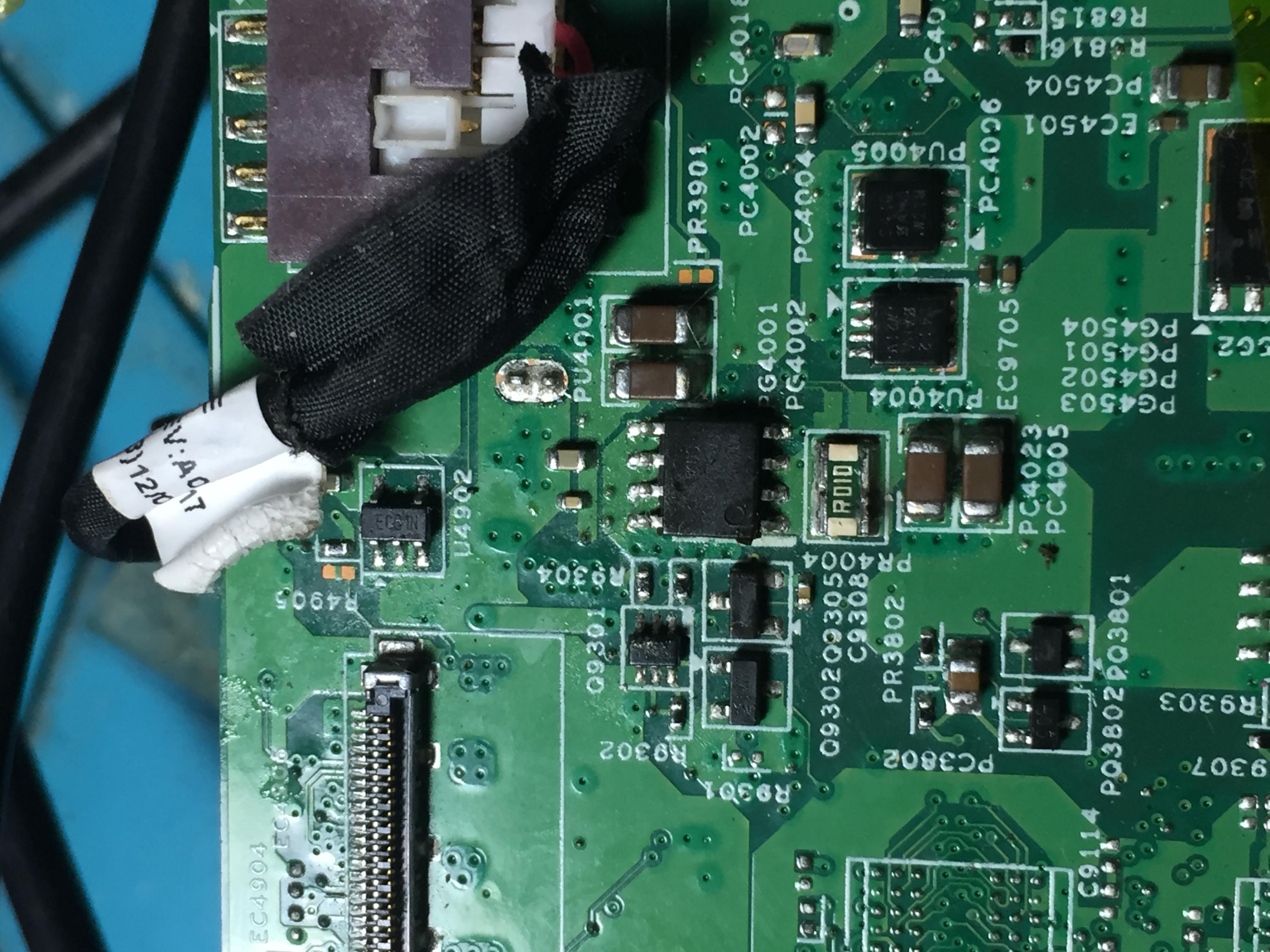

          replaced pr4005 nothing change on diode mode pr4005=0.500v but i cannot find here the pr4004 here is the pic could you please show where is pr4004 located

            #65
            THe big green one with R010 in your picture

              #66
              thanks it measure 2.411v with black probe on the ground and red on both sides and it measure 0.400v with red on the ground and black on both sides
                if i plugged in charger only both sides has 19v
                  plugged in both charger and battery both sides also have 19v
                      Replace PC4018
                        @smdflea replaced pc4018 still the same issue
                          just to get more information , volt and amp of your charger..
                          PU3801 voltage and impedance on all pins
                              i used bench lab pu3801 pin 1-3=19v pin4=6v pin5-8 19v
                                impedance of PU3801.
                                Can you try with an orginal charger
                                  sorry for the late reply on PU3801 PIN1-3= 0.455V PIN4=0L PIN 5 -8= 1.04V
                                    Things get more clear now..take out PU3801 and see if he's short ou no.
                                    without pu3801 see if ther's short to ground ( diode mode ) place of pin1
                                    and also how many voltage you got at pin 1 and pin 4
                                      with PU3801 removed pin 1 and pin 4 both have 0.600v and pin1=19v and pin4 = 6v
                                        [QUOTE=Mulong2019;963824]with PU3801 removed pin 1 and pin 4 both have 0.600v and pin1=19v and pin4 = 6v
                                        Please...again and in order
                                          i put back the PU3801 mosfet and measured again on diode mode with red probe to ground and black on pin 1-3 =0.594v and pin4= 0l pin 5-8= 0.900v
