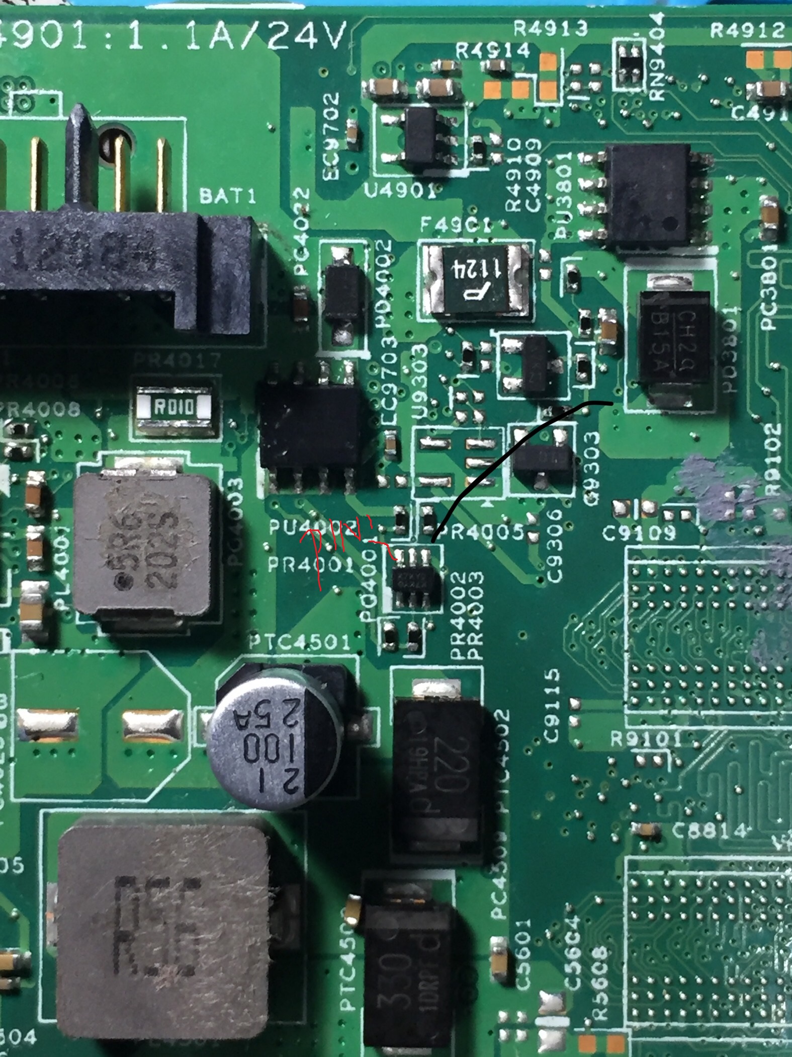

    pr4001=202.8kohms
    • String2016
      • Nov 2015
      • 2238
      • philippines
      #42
      Re: lenovo b470 turns on only on battery
      here is the photo i start measuring on the upper as pin 1
      • String2016
        • Nov 2015
        • 2238
        • philippines
        #43
        you are right as i checked on the schematic pin 6 has 19v and pin5 has 3.3v pin 4 is connected to the ground but pin 1-3 is beeping to the ground could it be shorted?

          #44
          Change pq4001
          or remove it and just jumper from pin 4 to pin 3
          • qayyum786
            • Aug 2018
            • 1959
            • INDIA
            #45
            Remove pq4001 and
            jumper as i have shown in image
            • qayyum786
              • Aug 2018
              • 1959
              • INDIA
              #46
              You get confused during counting the pin of pq4001
              now
              just let me know the voktage of pu4001 voltages of source - gate - drain
              pin 1,2,3 = ?
              Pin 4 = ?
              Pin 5,6,7,8 = ?
              Please don't make mistakes during measuring the voltages on pin

                #47
                Hi
                check PR4006 voltage before and after resistor
                its connect direct to your +Ad and your pin2 of bq
                • qayyum786
                  • Aug 2018
                  • 1959
                  • INDIA
                  #48
                  ACIN is 2.6 v
                  Please Check #8
                  That means PIN 2 ACIN volt is perfect for BQ24745

                    #49
                    @qayyum786 pu4001 here it is ive measured again
                    pin 1,2,3 = 19v
                    Pin 4 = 6.58v
                    Pin 5,6,7,8 =19v
                    • qayyum786
                      • Aug 2018
                      • 1959
                      • INDIA
                      #50
                      That means PQ4001 & PU4001 both are ok
                      Remove PU4002 and check with adapter only
                      Dose laptop power on with adapter after removing PU4002
                      • String2016
                        • Nov 2015
                        • 2238
                        • philippines
                        #51
                        removed PU4002 plugged in charger only laptop cannot power on
                        • String2016
                          • Nov 2015
                          • 2238
                          • philippines
                          #52
                          I noticed alson that no voltages on DRAIN of pu4002 and on pr4005 it has only 10kohms on the schematic supposed to have 470k
                          • qayyum786
                            • Aug 2018
                            • 1959
                            • INDIA
                            #53
                            When you masure VOLT ON DRAIN before removing PU4002
                            Or masure it after removing PU4002
                            • qayyum786
                              • Aug 2018
                              • 1959
                              • INDIA
                              #54
                              Change
                              pr4005
                              pu4002
                              pu4004
                              pu4005
                              • String2016
                                • Nov 2015
                                • 2238
                                • philippines
                                #55
                                when i measured the pu4002 with in the board and removing its the same measurement no drain voltages
                                • qayyum786
                                  • Aug 2018
                                  • 1959
                                  • INDIA
                                  #56
                                  Yes afcors if you check voltages WITHOUT BATTERY
                                  & iCHARGER PLUG IN you will not get any voltages on DRAIN
                                  DRAIN is connected to the BATTERY SIDE
                                  Do you know how to test MOSFET FOR SHORT
                                  If yes than REMOVE CHARGER & BATTERY BOTH and masure
                                  pu4002
                                  pu4004
                                  pu4005
                                  I guess 1 of them is shorted
                                  • String2016
                                    • Nov 2015
                                    • 2238
                                    • philippines
                                    #57
                                    check on diode mode on pu4004 black probe on source and red on drain it has 0.200v and on pu4005 it has 0.500v pu4002 0.465v
                                    • String2016
                                      • Nov 2015
                                      • 2238
                                      • philippines
                                      #58
                                      with charger plugged in pu4004 drain have voltage but source no voltage PU4005 both drain and source no voltage
                                      • qayyum786
                                        • Aug 2018
                                        • 1959
                                        • INDIA
                                        #59
                                        All 3 mosfet check out side of motherboard
                                        if all 3 fet is ok than bq ic is victim
                                        • String2016
                                          • Nov 2015
                                          • 2238
                                          • philippines
                                          #60
                                          you mean i pulled out the 3fets and check outside motherboard?
