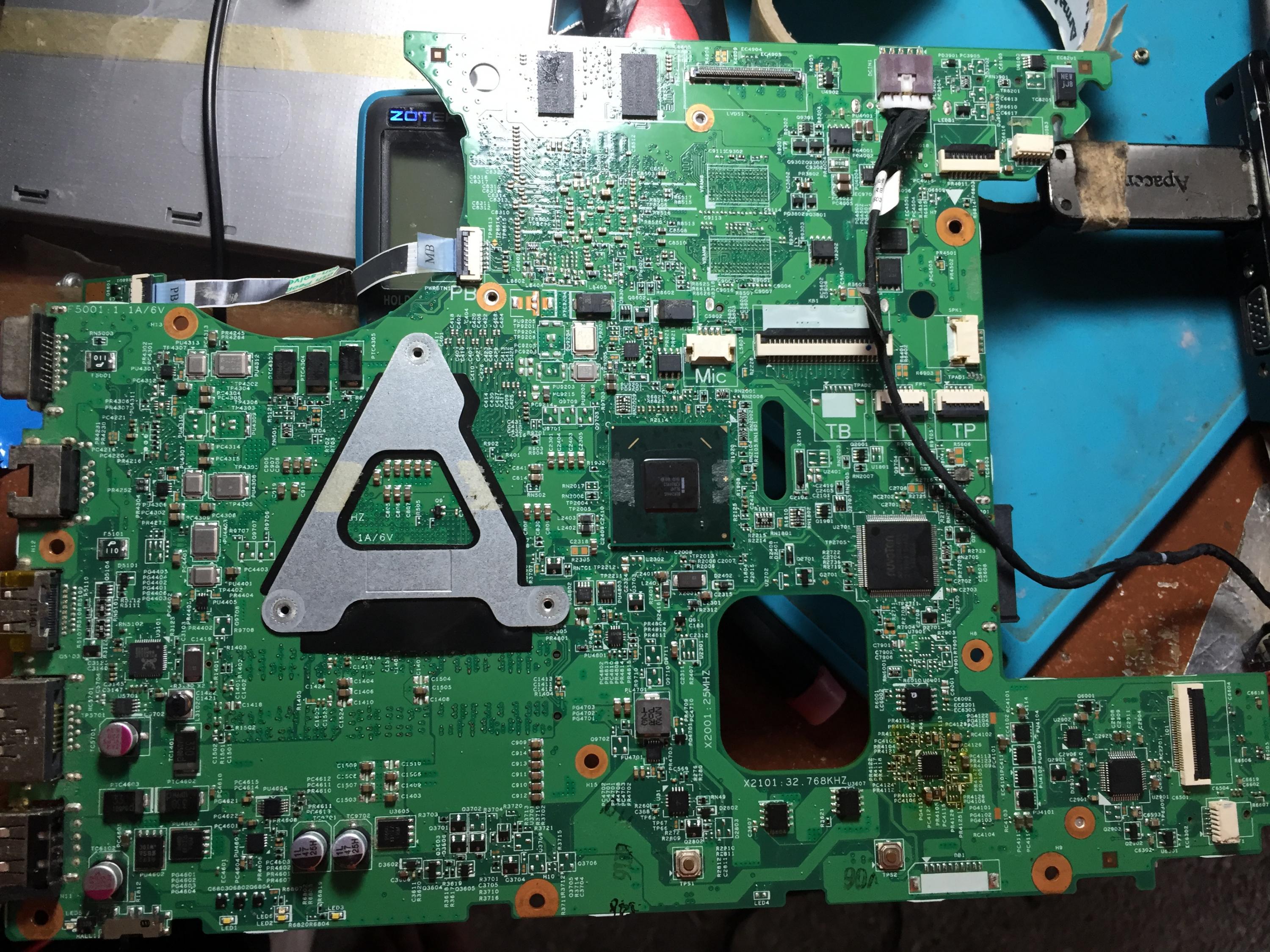

    I need helo on this lenovo b470 core i5 nvidia laptop, the problem is turns on only if battery only plugged in but if both battery and charger plugged in cannot turn on and also if charger only plugged in cannot turn on also. anyone can help on this please

    Re: lenovo b470 turns on only on battery
    Send schematic and voltage details of charging ic pins
      i cannot find a schematic on this model, but i made a measurement with charger only plugged in on the ic BQ24745 base on datasheet pin3 VREF=2.5V pin2 ACIN=19v pin13 ACOK =3.3v but pin21 LGATE = 0v
        write the name of the motherboard for the right schematic

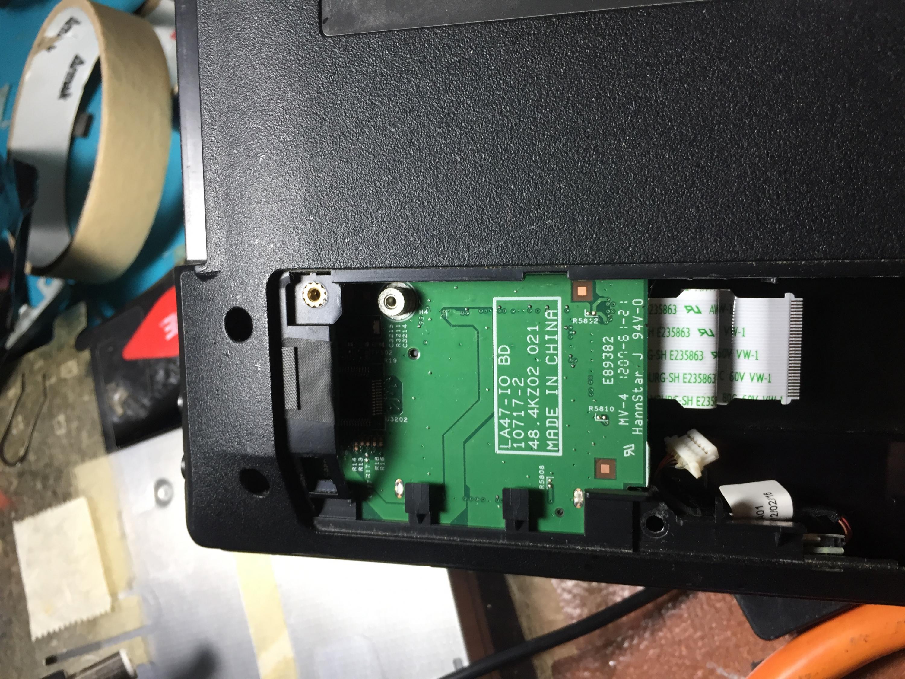

          on the main board i cannot find the markings of the board id but on the other board which connected to usb it has mark 48.4kz02.021. I have attached the photo
            I Have the schematic uploaded under Schematic-Forum search after B470
            Put only AC adapter and then messure at Pu4001 voltage
                @mielta sorry for the late response. here is the pu4001 all pins with charger only plugged in measurement
                pin1=0v
                pin2=2.6v
                pin3=3.3v
                pin4=0v
                pin5=0v
                pin6=0v
                pin7=0v
                pin8=0v
                pin9=3.3v
                pin10=3.3v
                pin11=3.3v
                pin12=0v
                pin13=3.3v
                pin14=0v
                pin15=0v
                pin16=0v
                pin17=0v
                pin18=0v
                pin19=0v
                pin20=0v
                pin21=0v
                pin22=19v
                pin23=0v
                pin24=0v
                pin25=0v
                pin26=3.3v
                pin27=0v
                pin28=19v

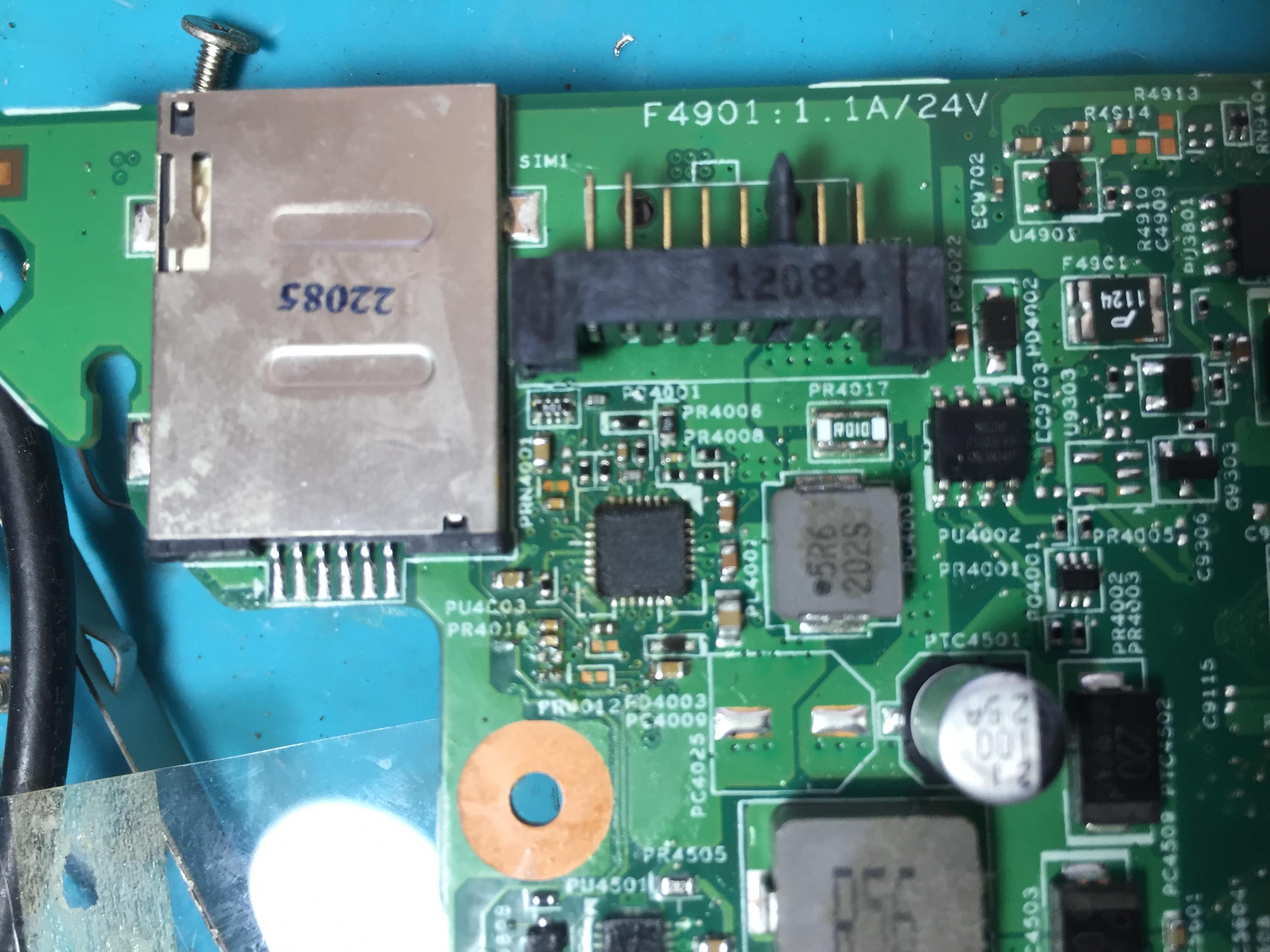

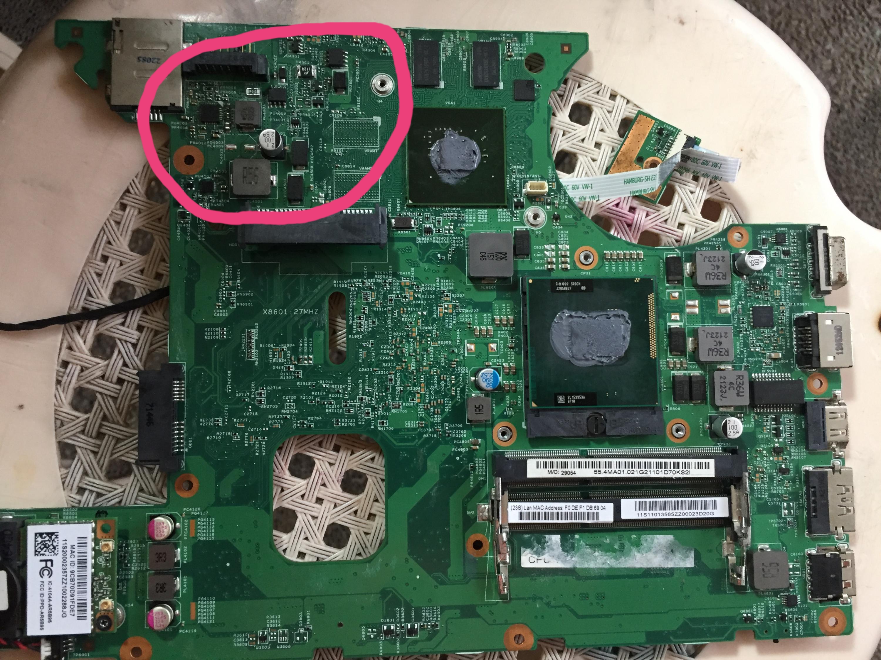

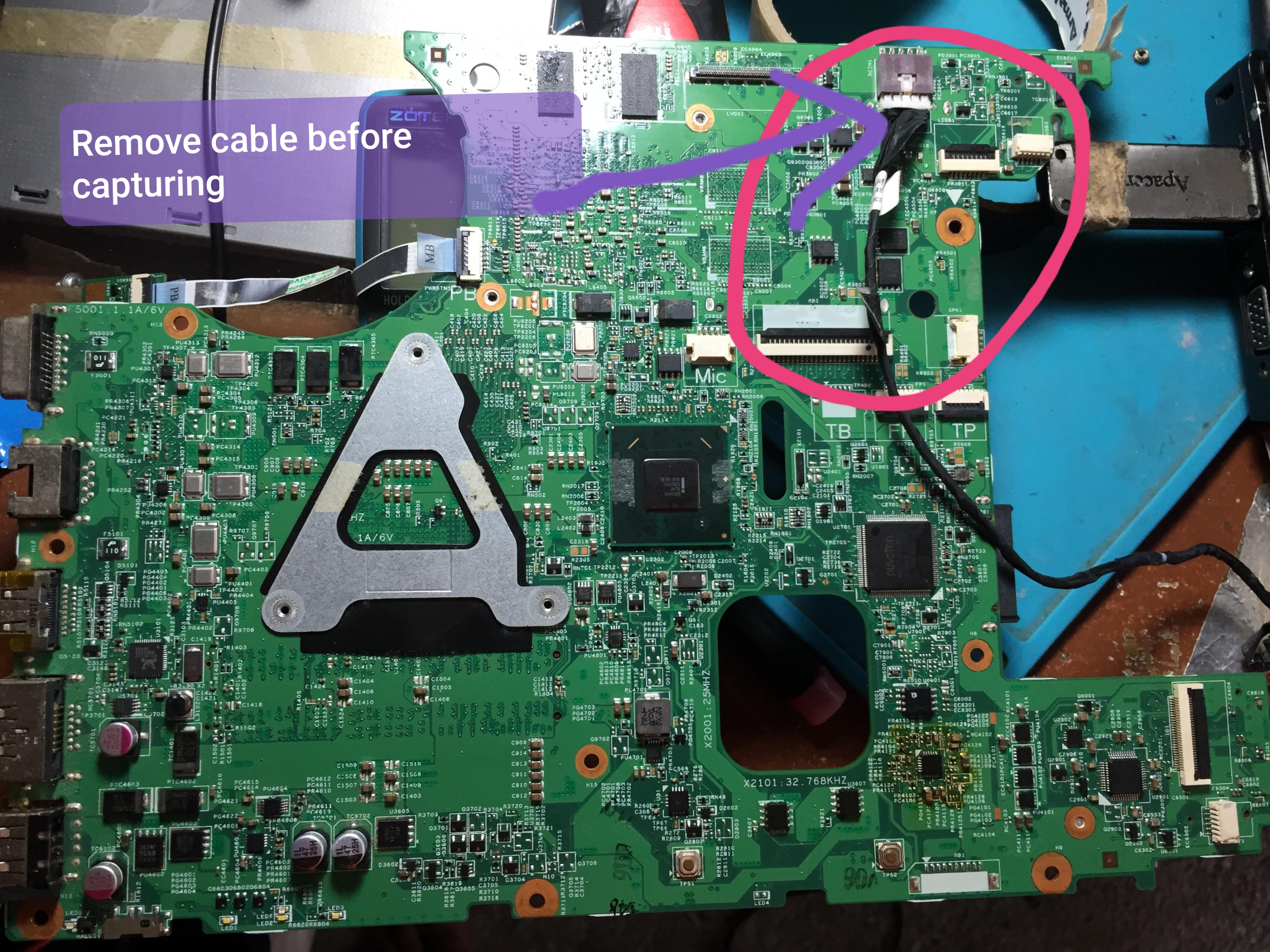

                    Send clear picture near charging i.c side (bq24745)
                    and dcin connector side
                    please remove the cable from dc jack

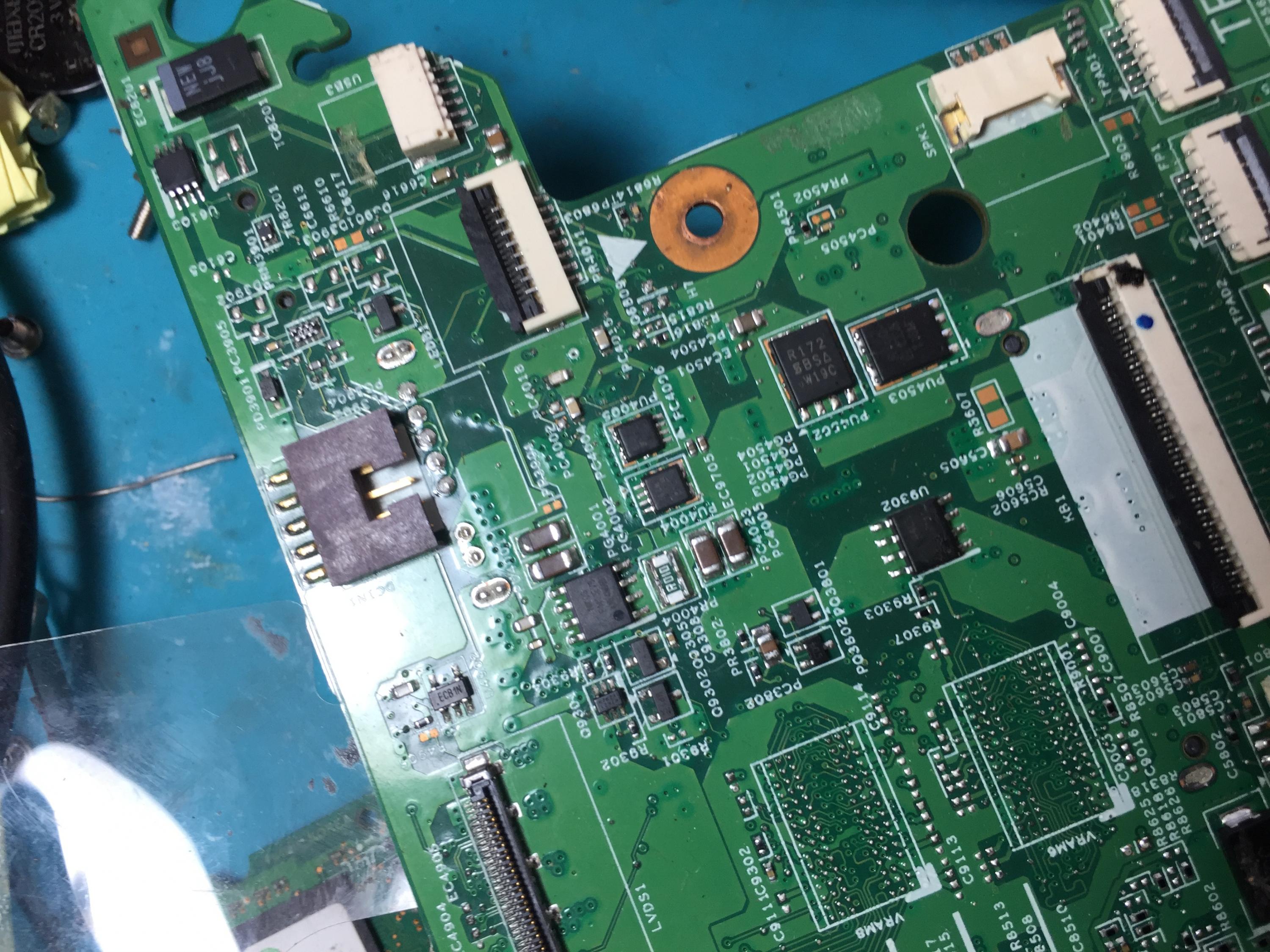

                      Upload clear image from marked area
                      parts number not so clear
                        @qayyum786 here it is the pic
                        • qayyum786
                          • Aug 2018
                          • 1959
                          • INDIA
                          Connect battery and chatger both
                          than check voltages On BQ24745
                                here is the measurement both battery and charger plugged in
                                pin1=0v
                                pin2=2.6v
                                pin3=3.3v
                                pin4=0v
                                pin5=0v
                                pin6=0v
                                pin7=0v
                                pin8=0v
                                pin9=3.2v
                                pin10=3.2v
                                pin11=3.3v
                                pin12=0v
                                pin13=3.3v
                                pin14=0v
                                pin15=11.08v
                                pin16=11v
                                pin17=11v
                                pin18=11v
                                pin19=0v
                                pin20=2.2v
                                pin21=6v
                                pin22=18.6v
                                pin23=12v
                                pin24=15.6v
                                pin25=18.6v
                                pin26=3.3v
                                pin27=19v
                                pin28=19v
                                  Did yiu replace the bq ic ?
                                  • qayyum786
                                    • Aug 2018
                                    • 1959
                                    • INDIA
                                    REMOVE PQ4002 and check for voltage
                                    On pin NO:- 7 = ?
                                      i did not replaced the ic i just reflowed the chip
