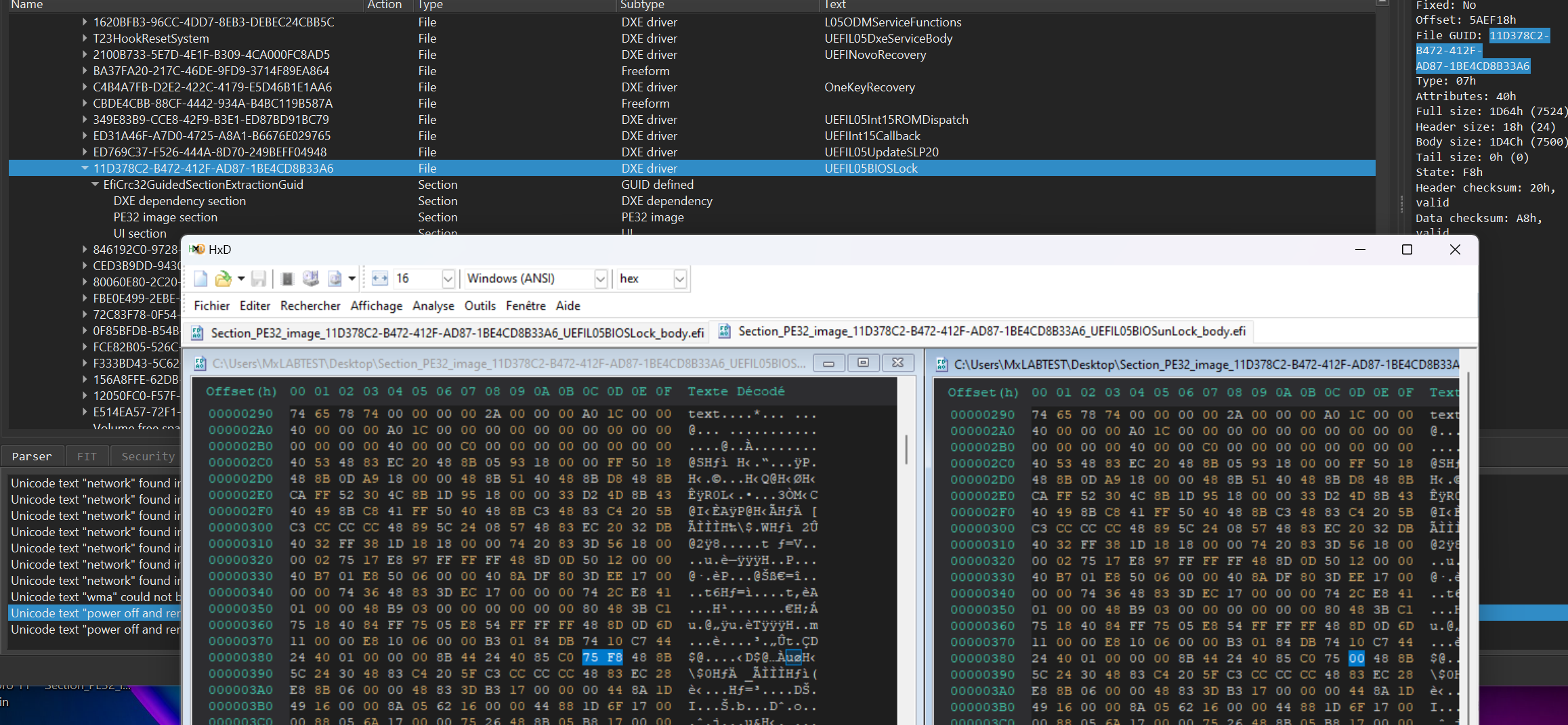

    lenovo B580 change wifi card after this error "unauthorized wireless network card is plugged in. power off and remove it"
    bios dump attached

            ​in UEFIL05BIOSLock (Guid: 11D378C2-B472-412F-AD87-1BE4CD8B33A6​)
            look for 75F8
            change to 7500​
