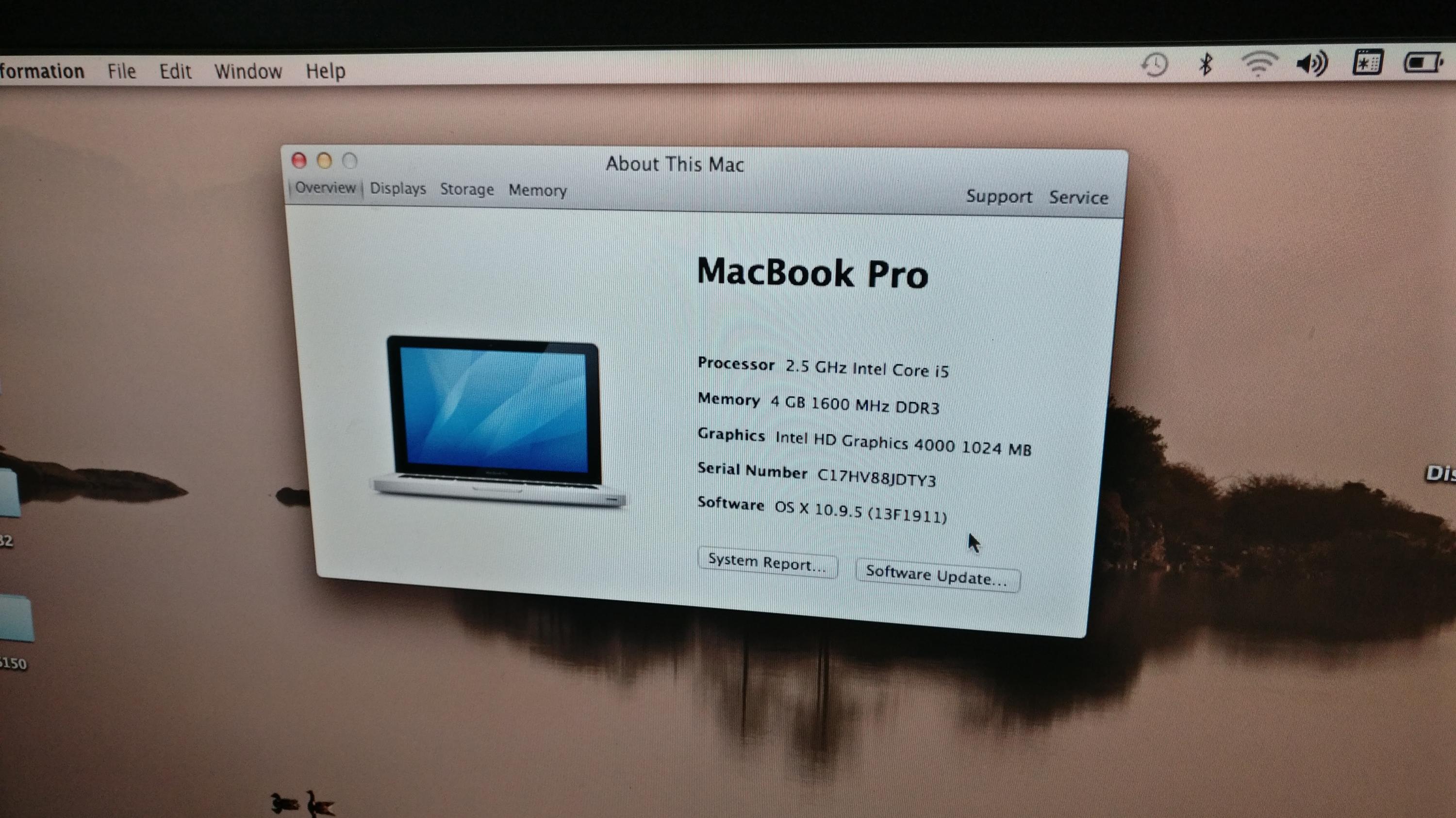

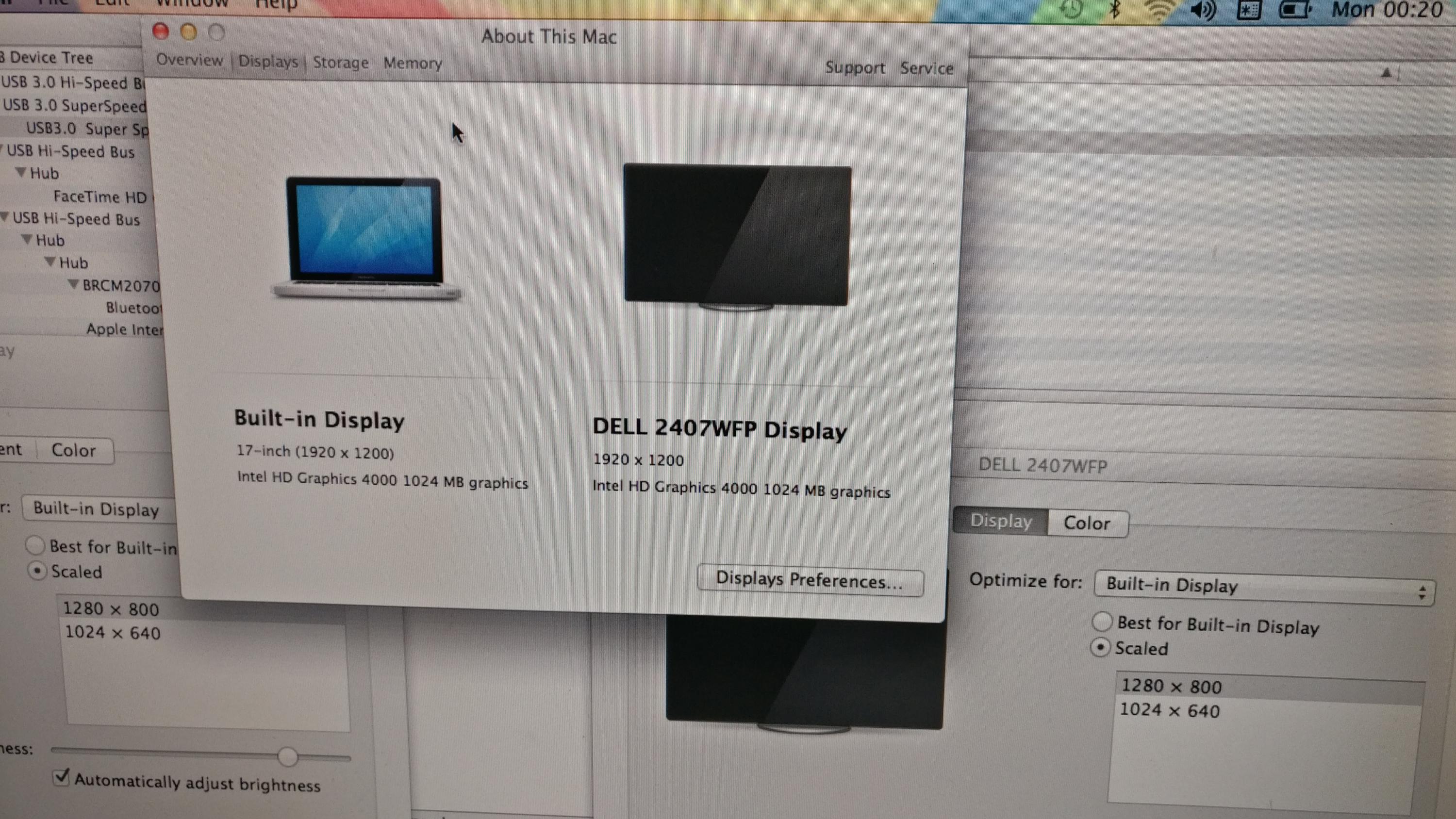

      Followed your instructons, initially I had no joy, although the screen did dim momenterally after a few seconds but nothing happed.
      So I tried again with a second display connected through the displayport and hey presto I got an image, the MB screen is still white.
      I turned the MB off insterted a HDD with Lion already installed and checked specs, sys info etc.
      1. When opening window about this mac it only states it's a Macbook Pro nothing about size or screen. I've included an image(1).
      2. Changing the resolution worked fine but the display tab on about this mac states it's a 17 inch. I've included an image(2).
      My MBP is a 13-Inch Mid 2012 Core-i5-3210M.
      Thanks again.

        I interpreted your issue as operating system not found. You mentioned the screen to be working, not showing a solid white background.
        If there is an issue related to LCD, first thing would be to try a known good LCD.

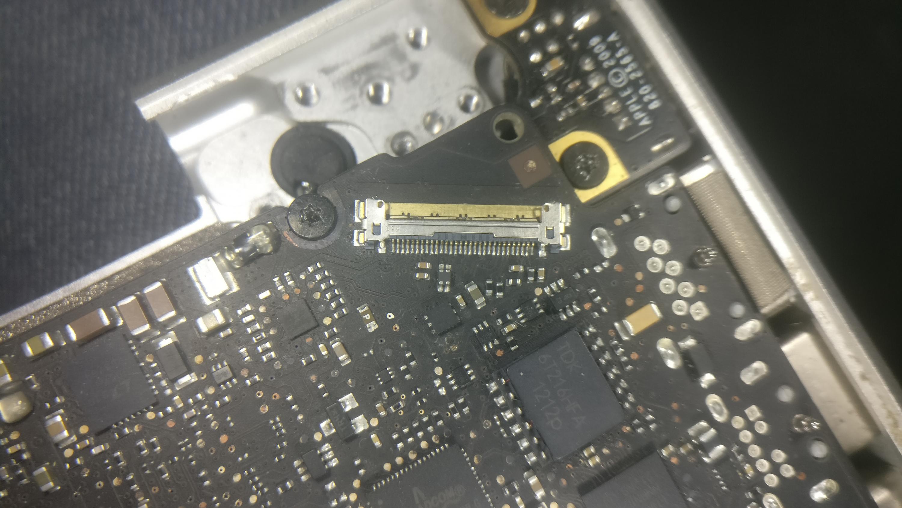

            I've disconected the screen and connected to a MBP mid-2011 where it works fine, I can see the OS on screen.
            So atleast we know the screen is fine.
            The LVDS connector looks fine on the MBP, but I've included an image.
            I guess it's a case of fault finding along the gpu to screen output? or am going in a totally wrong direction.
            Thanks again for the help.

              It's a 13" so GPU is indide CPU. Check voltage on pins 2/3 of J9000 and all pins of U9000

                Can you check diode mode on all 6 LVDS lines (pins 8-18) and voltage on pin 3 on J9000 (lcd connector) ?Is the board number 820-3115?

                  J9000:
                  Pin 1 0.26v
                  Pin 2 0.26v
                  U9000:
                  Pin 1 3.3v
                  Pin 2 0.24v
                  Pin 3 0.24v
                  Pin 4 0.26v
                  Pin 5 0.26v
                  Pin 6 Gnd
                  6 LVDS lines gave no shorts, with the following readings:
                  8 1768 ohms
                  9 1982 ohms
                  11 1758 ohms
                  12 1963 ohms
                  14 1746 ohms
                  15 1994 ohms
                  17 1839 ohms
                  18 1903 ohms
                  The board is 820-3115-B.
                  Thanks again for all the help.

                      U9000 pins 2/3 should have 3.3V, they are connected to PP3V3_S5 which must be present if the machine turns on. There is probably a break in the line.

                        J9000
                        pin2 0.26v
                        pin3 0.26v
                        Miss labelled the pins sorry

                          If I solder two small wires from Pin1 of C9009 to pins 2/3 on the U9000, this would fix the issue?
                            If there is voltage on c9009 pin 1 then yes otherwise you'll need to go further back

                              Soldered the wires as mention earlier and this solved the problem. My question mark folder has now been found.
