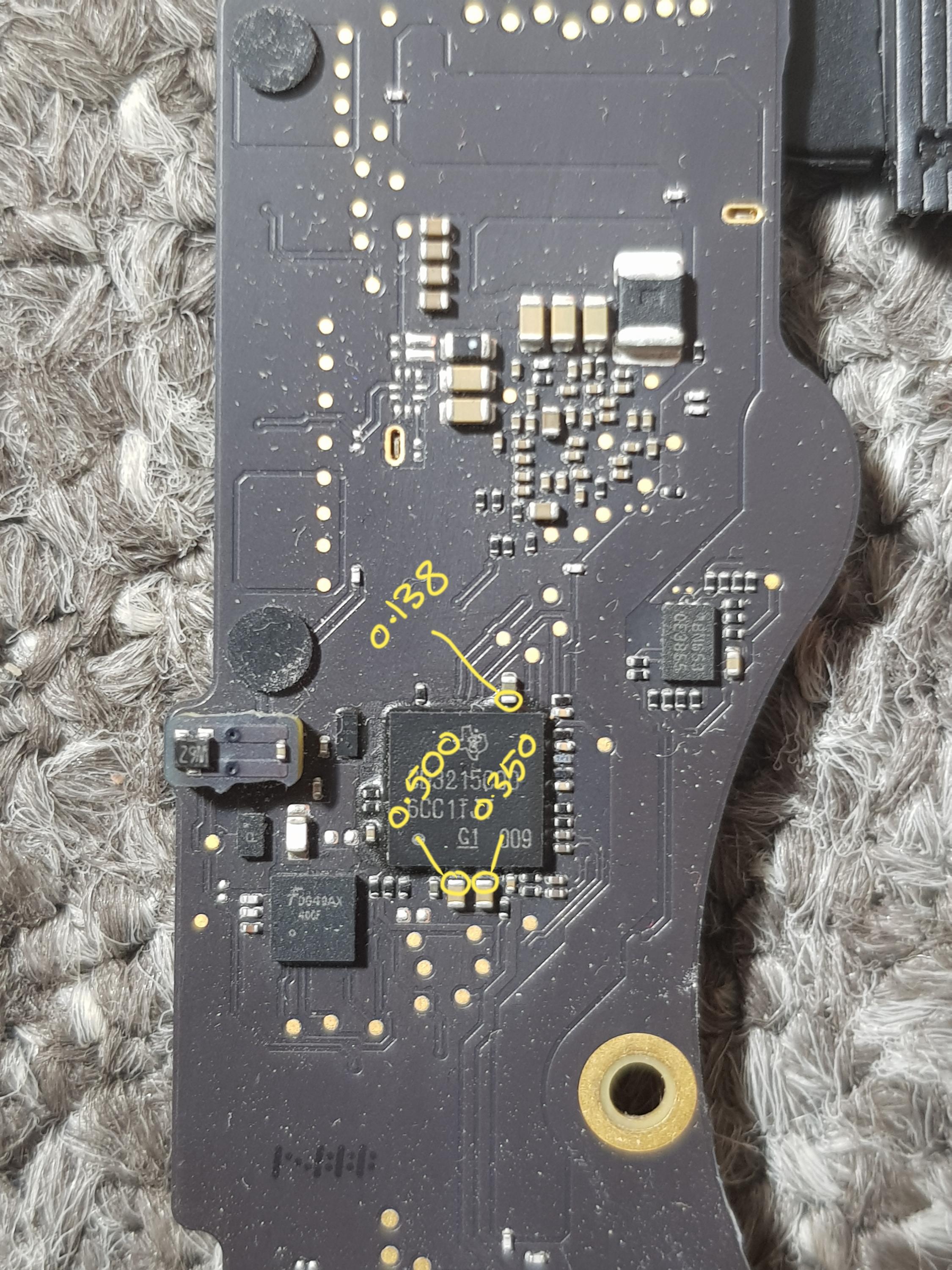

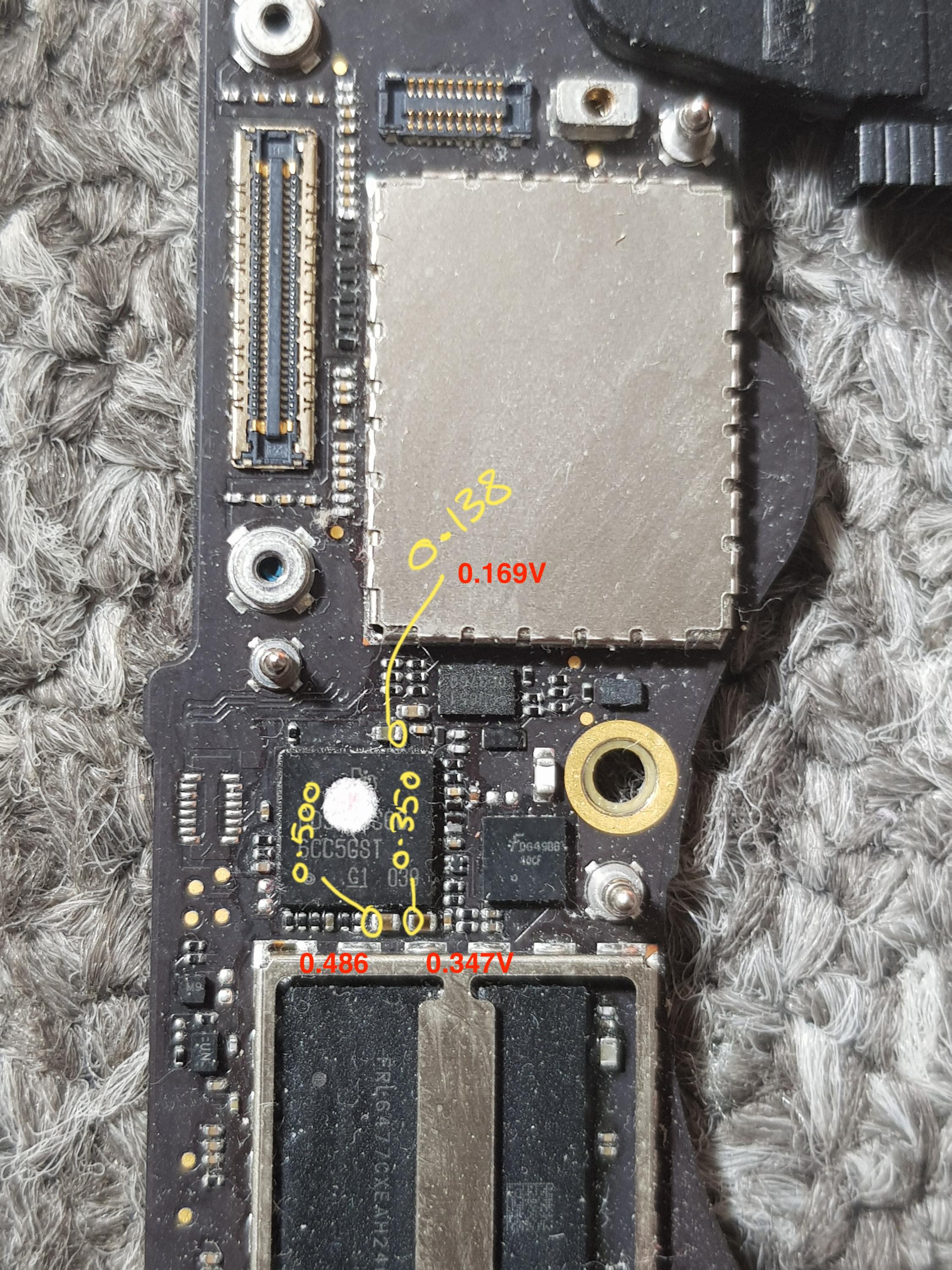

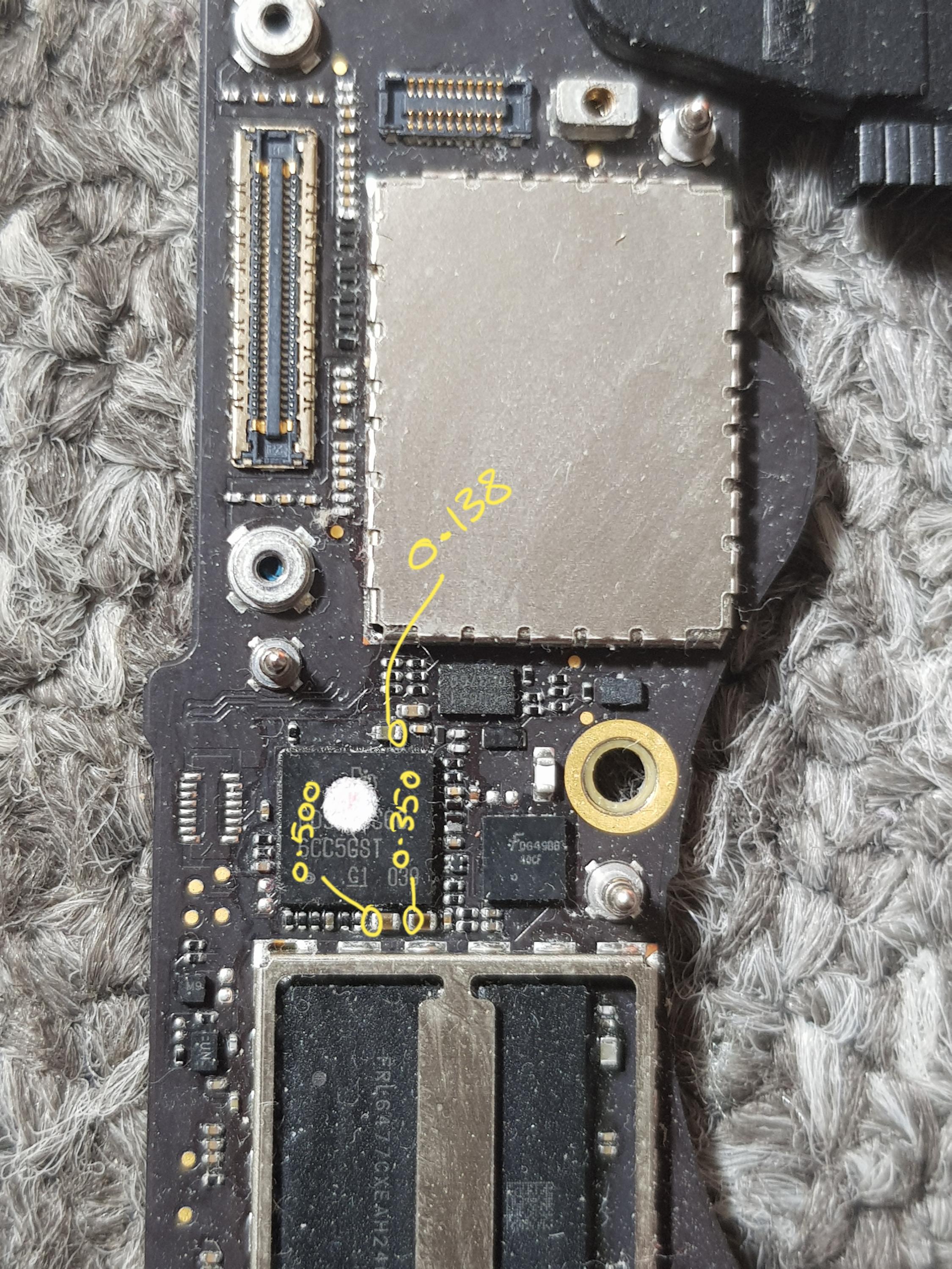

                I got an apple a1706 today. Different issue, but took these measures for you on the 20v line.
                  Re: Macbook Pro A1706 doesn't power on
                  Thanks, I will compare tomorrow and measure. Will let you know asap.
                    #29

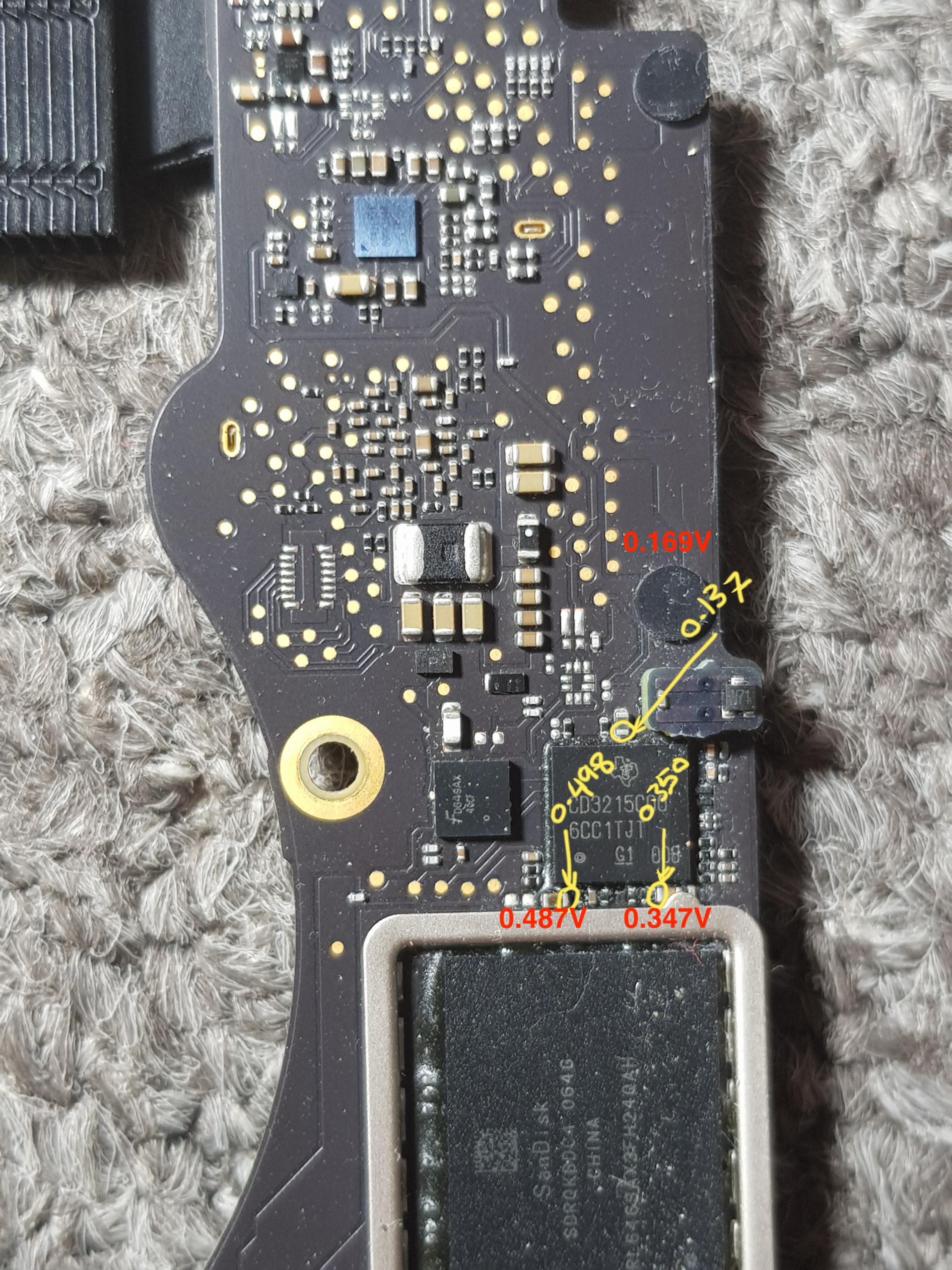

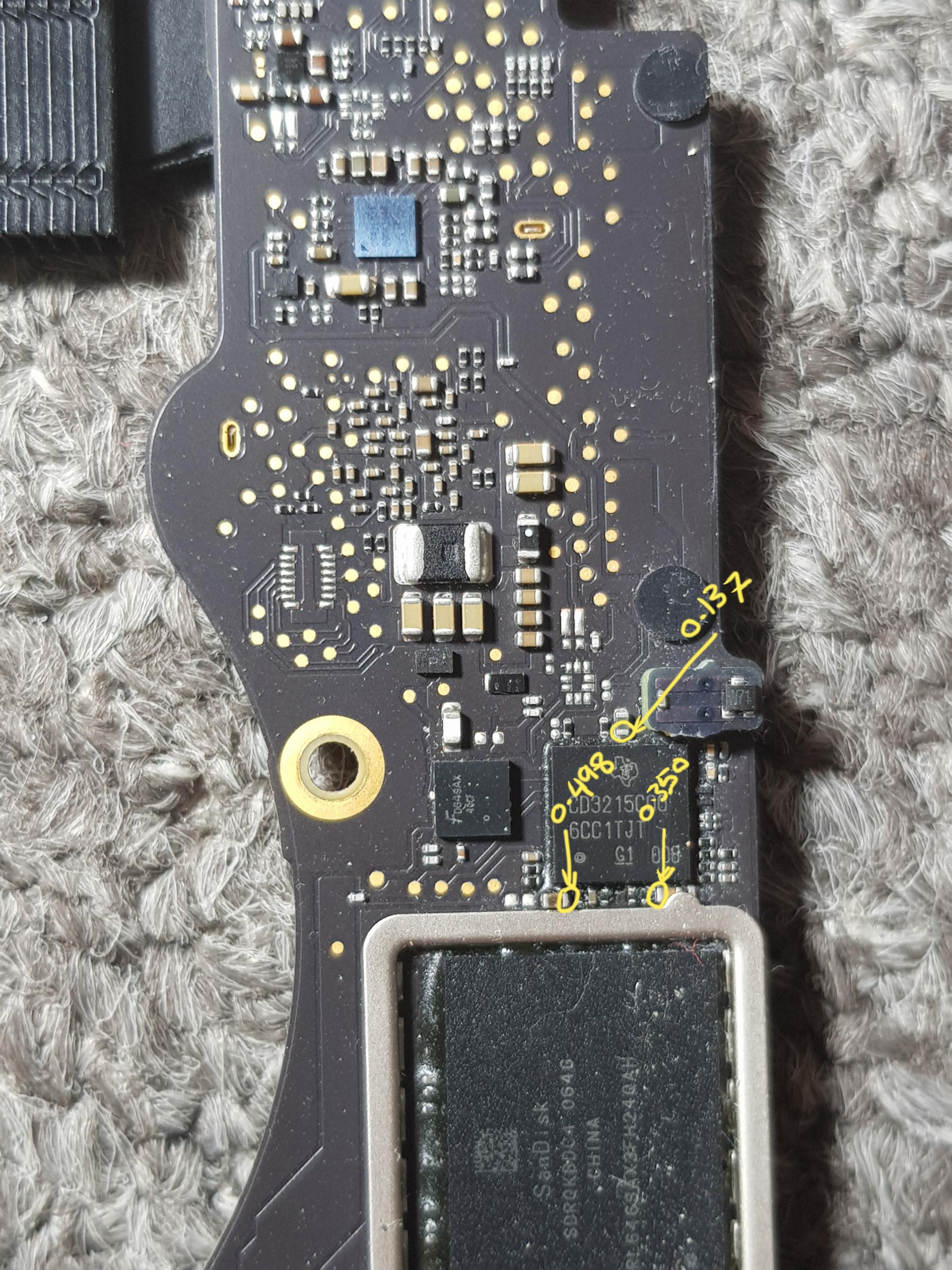

                    Just remembee. These are diode mode measures. Red probe on GND and black probe on component pin.
                      #30
                      So I did the diode meassurements and put my readings next to yours. Also checked those 4 20vc caps: CB301, CB401, C3101 and C3201. The 4 of them behave the same and it's like this:
                      - black probe on GND gives non stable readings, jumping from k to mOhms and can't get any stable data. Only once I was able to get about 4mOhs and rising on CB301. Not sure if there was a contact issue with my probes
                      - red probe on GND gives readings about 533Ohm on all of the caps
                      No sure, but I will get a better multimeter and check again.
