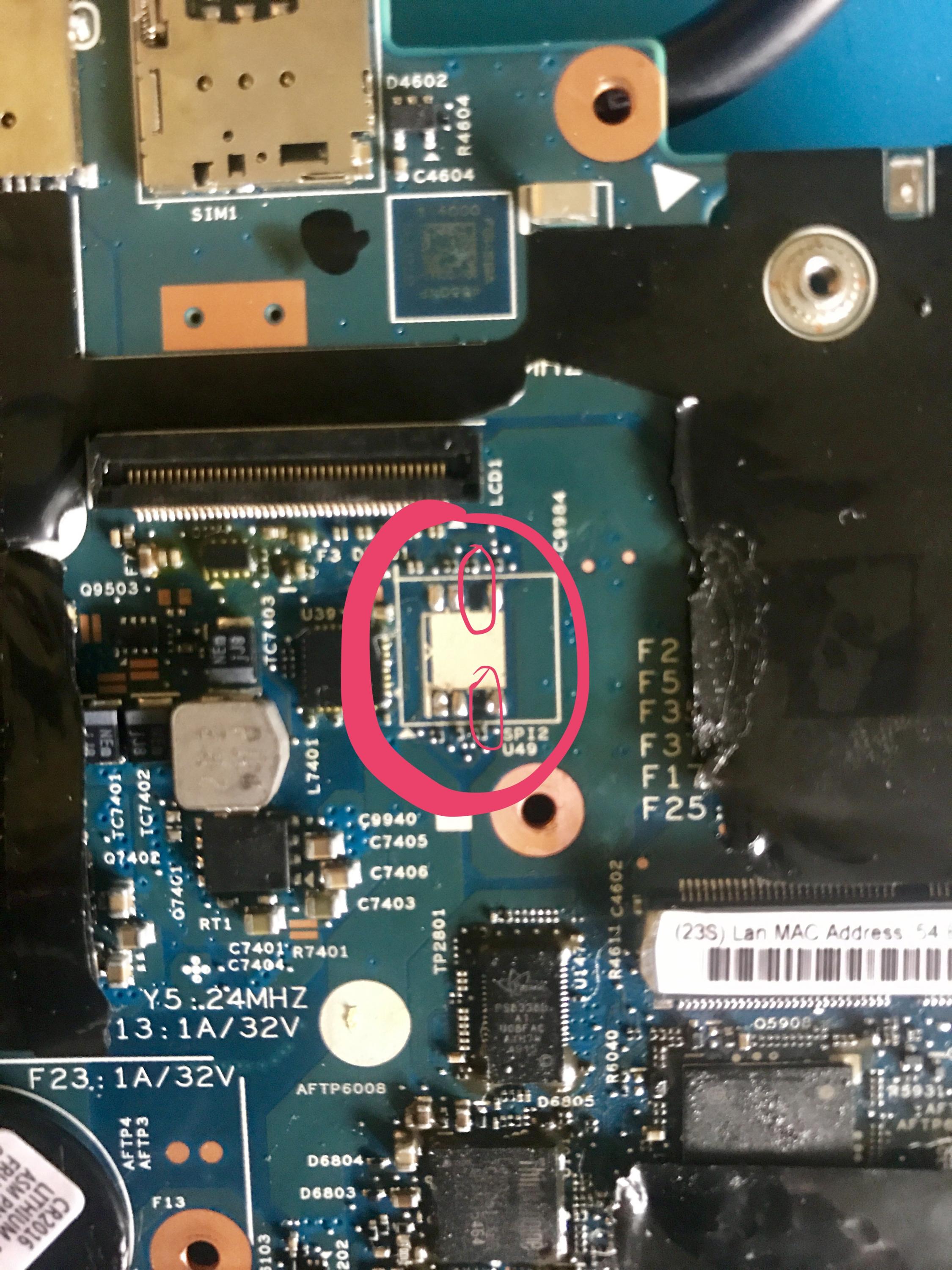

    While trying to desolder a bios chip from my lenovo x1 yoga fq20, I made a huge plunder and ripped the soldering pads off...Is there a way to replace the pads or did i just destroy my board? I provided a pic of the damage.

    Yep it’s still possible to bring back it alive but we need the Bord ID Schematic a close up pic with a loop try and find one of them or the Schematic

      Re: Ripped bios chip pad on board
      very bad foto. but u need to solder it back and connect pins with wire to traces or nearly components

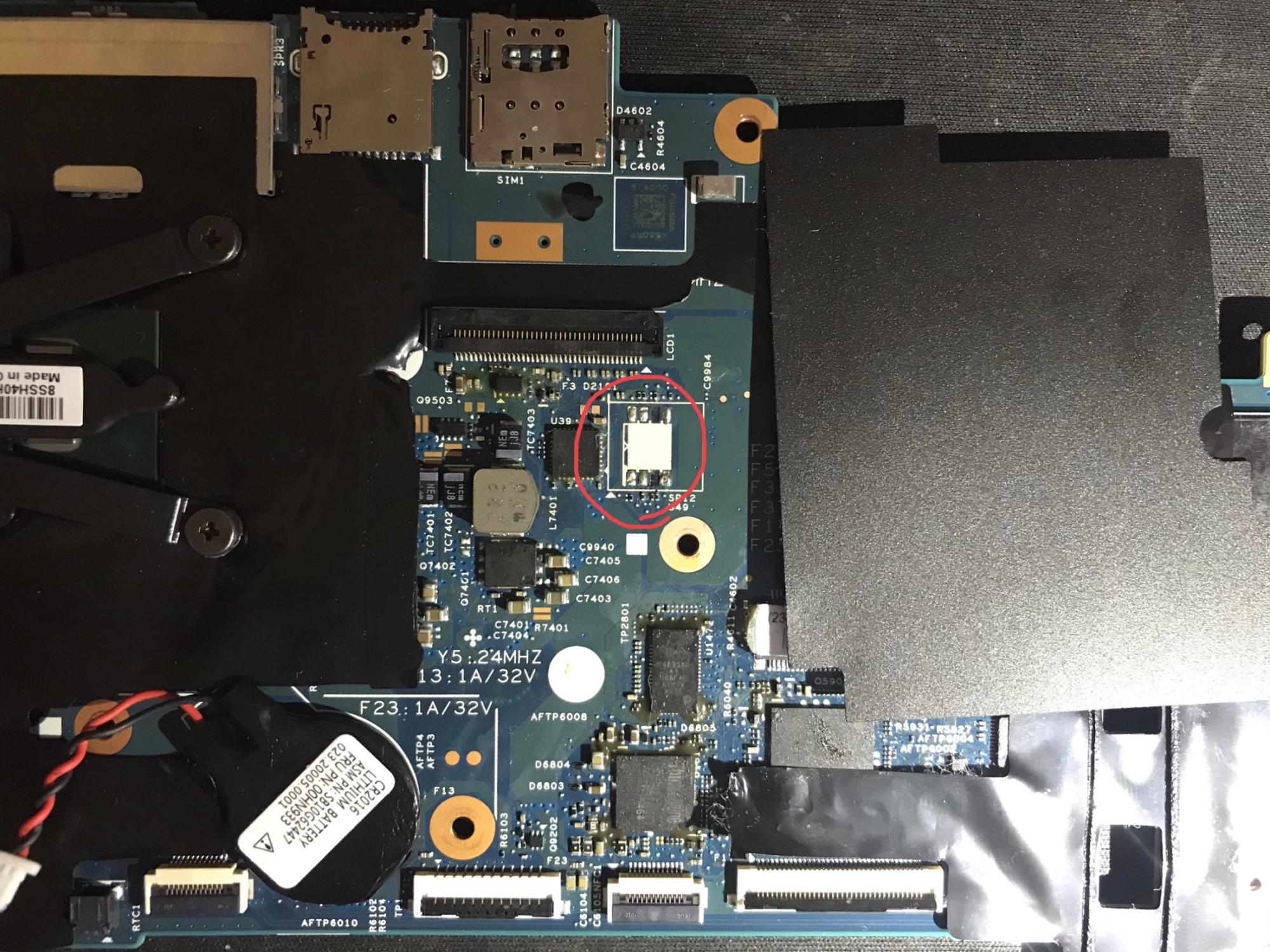

        Thanks for the reply guys I am posting a better pic. I will be looking for the schematic and will go from there.
          It looks like the board id is:
          14282-2M
          LRV1 448.04P15.002M
            what u need is microscope. even cheap to see the traces
            u dont need a schematic. just scrape mask of remaining traces and solder pins to it with wire
                https://www.badcaps.net/forum/showthread.php?t=83958
                schematic and board view for x1 yoga g1
