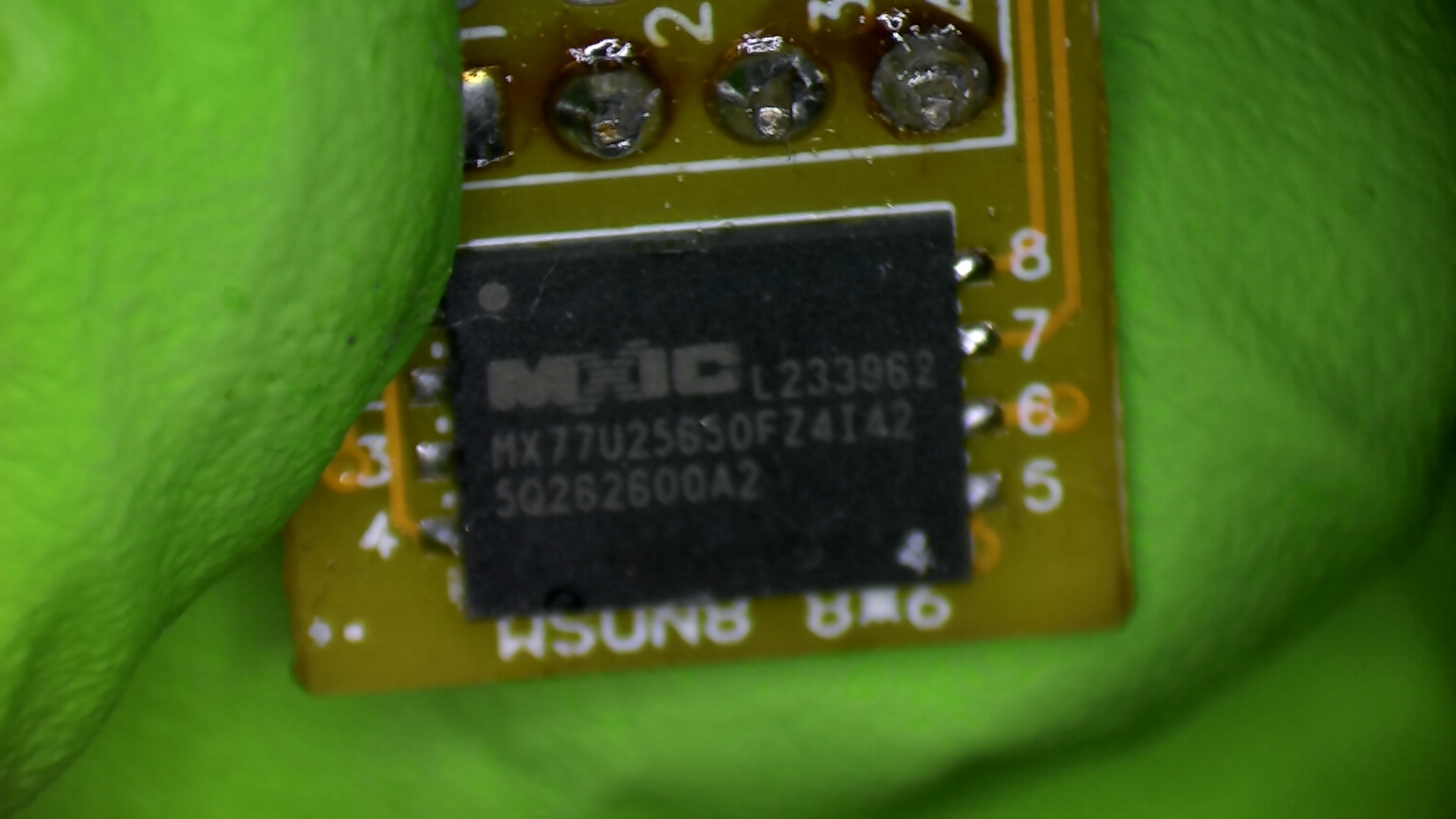

Looking for a way to read this bios chip. Lenovo Yoga 7 16arp8 bios chip.

    I'm working on a lenovo yoga 7 16arp8 that had a bad charge port. When I replaced the port the laptops charge light will come on and stay on now, but when I push the power button the power light will come on for a couple seconds and then go right back out. I'm suspecting a bad bios, but when I went to read the bios to start the process of getting a new one it I found that none of my programmers will read the IC. I mainly use a T48 with Xgpro. I also have a ch341 and it's software that I use for ps5 uart and bios's, and a EZP2019+ and it's software.
    The chip is labeled MXIC MX77u2565ofz4142
    None of the software or programmers I currently have will read this one. Does anyone know what I need to read it?

      info:
      https://www.elnec.com/en/device/Macr...ad%20I%2AO%29/
      U = 1.8V
      Make sure you have the latest software for the T48 , Select from the list MX25U25636F and untick "check ID"
      I doubt it`s got a bad bios after having a bad charge port. Did you check for shorts. Is it a USB-C port ? ,is the EC ok. Do you have a schematic to check the power sequence.

        before touching the bios needs to check all the dcdc conv.
