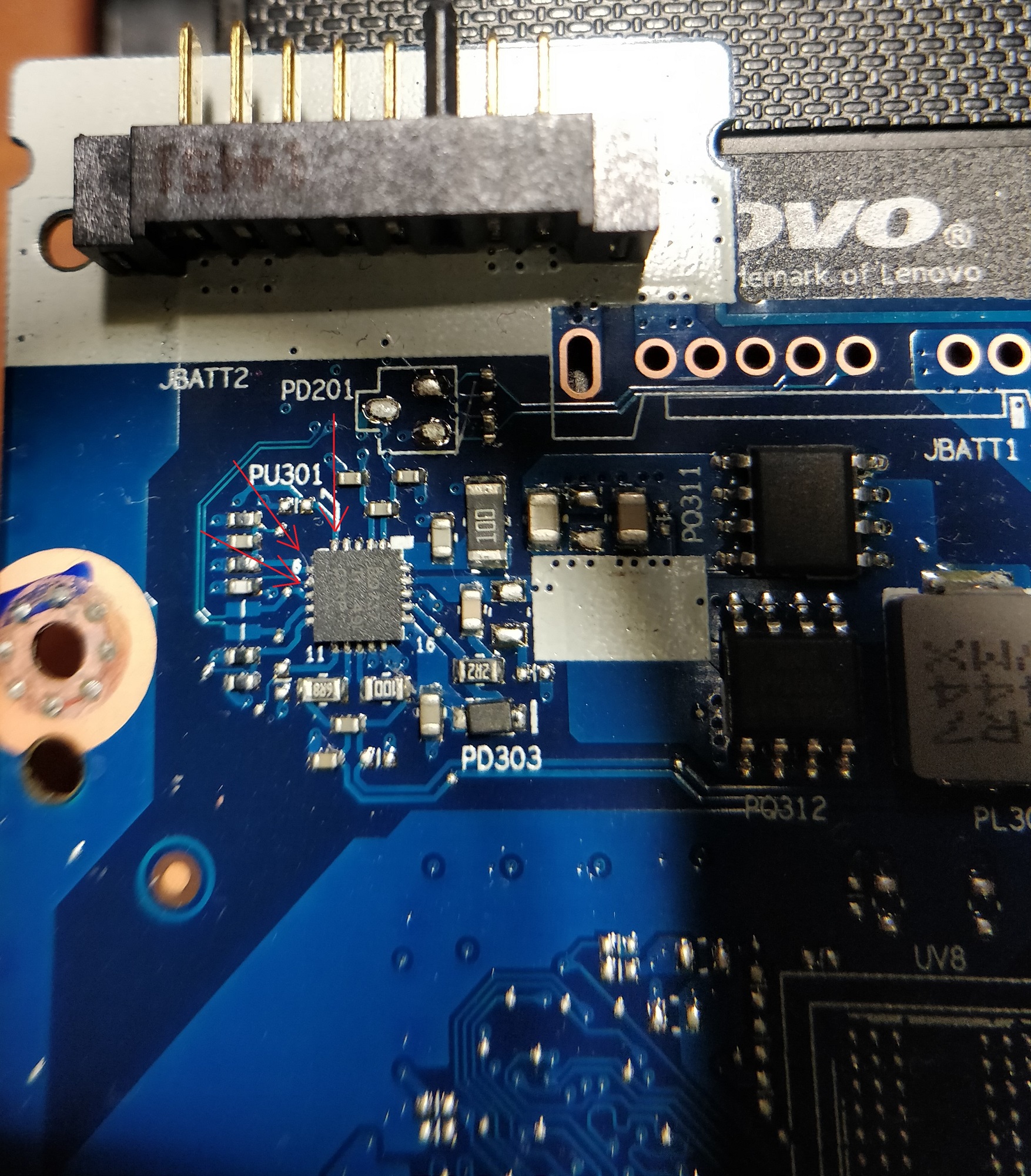

    Hi, I have a Lenovo motherboard that's not powering on. It's a Lenovo G40-30 ACLU9/ACLU0 NM-A311 Rev 1.0
    I didn't manage to find the schematics for this revision, but found one for Rev 0.2... and I'm attaching this even though it's already uploaded in this forum.
    Please note that I am quite a newbie in the sector, so I'm trying to trace the voltages component by component... starting with DCIN and moving forward.
    19V at DCIN is fine. It reached PQ301 mosfet. Then there is another mosfet (PQ302 on the schematics, and noticed that it outputs 1.045V. And at this stage I was lost, cause I can't understand why it would do this, and not even sure if it supposed to do this at all. This tells me that every other component from now onwards is getting this low 1.045V. Is my thinking correct? In fact, even the battery connector is getting such voltage.
    Would appreciate if you can guide me in the right direction to troubleshoot this Thank you

    what is the voltage measurement of the p-channel PQ302 ( source (pin1),gate (pin4), drain (pin 5) ), and PU301 :BQ24737RGRR, vcc(pin20), ACDET (pin6), ACOK (pin5).

      Hey So...
      PQ302
      S: 19V
      G: 19V
      D: 1.04V
      PU301
      This number on the IC is BQ737 TI. I am not sure if this is the same as the one in the schematic. The number 16 on the right hand side confused me even more, cause the datasheet shows 16 top right. So I hope I got the pinouts correctly!
      VCC: 0V
      ACDET: 2.57V
      ACOK: 0V
      Because I'm unsure, I'm attaching a photo. Thanks

        Re: Troubleshooting: Lenovo Motherboard
        Check PQ301 for short between drain/source/gate.
        As you can see on the picture, the chip is rotated 90° right. Pin 1 is top-right, with the dot on the chip and the white line on the board. Pins are counted counterclockwise. Numbers on the board in the corner of the chip gives you pin number at this position.

          Can I test PQ301 in circuit or do I have to remove from the board? Just to be sure, you are referring to PQ301 and not PQ302 right?
          Thanks for the explanation about the IC. I was following the schematics as shown thinking the pins match exactly how it's drawn!
          So these are the correct measurements for PU301:
          VCC: 19V
          ACDET: 2.57V
          ACOK: 0V
