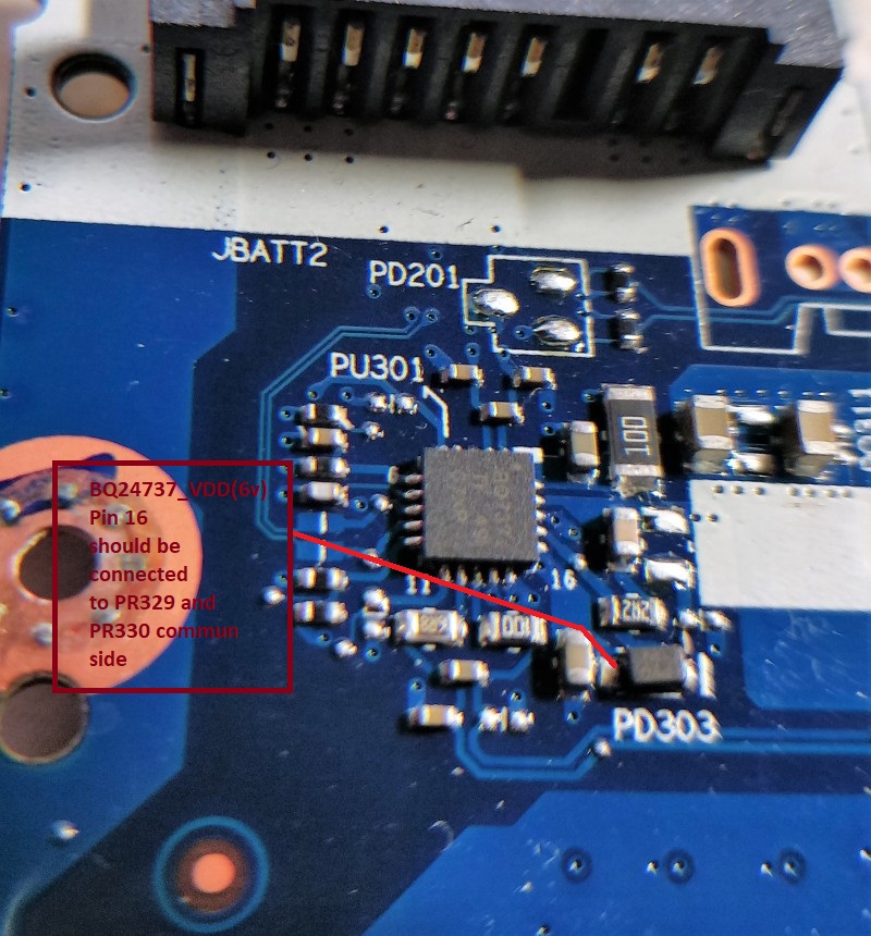

    Hmm, that is a possibility. It's also 10k. But that still has no continuity to PIN 16. An no continuity to QE2.
    p330 continuity to pin3 pq309 ( first or second side )and other side continuity to pin16 ,I suggest it's pr330 ,measure voltage in and out ? if one side is connected to pin3 pq309 so it's sure pr330( because the other one in last post with continuity to qe2 it's pr331) the other side should be connected to pin 16 ,if no continuity to BQ24737_VDD = pin16 ,so make a jumper .

      Lets refer them to old P330 and new P330 (old the one that is marked in the photo, new is the one you've asked about)
      Both have continuity to PIN 3 PQ309.
      None have continuity to PIN 16 BQ24737.
      None have voltage in/out.

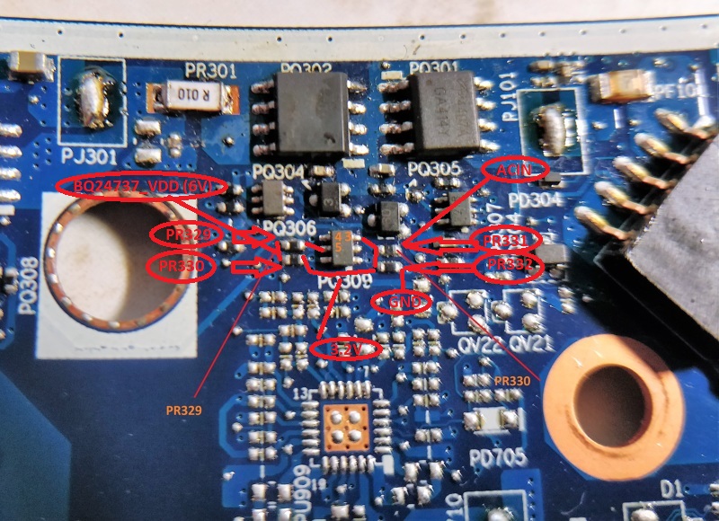

        i resume it with this picture ,

          no old no new pr330 just refer to the picture i have mensionned, it's correct

            I checked continuity from the PD303 (the pin you've highlighted) with DC in. And there was continuity almost everywhere on the board. PQ302 even, one one side only, and PR330, PR331, etc...
            I'll make a jumper. Can I use any wiring (i.e. from a desktop PSU)? Cause I don't have proper jumper wire (it's on delivery still)?

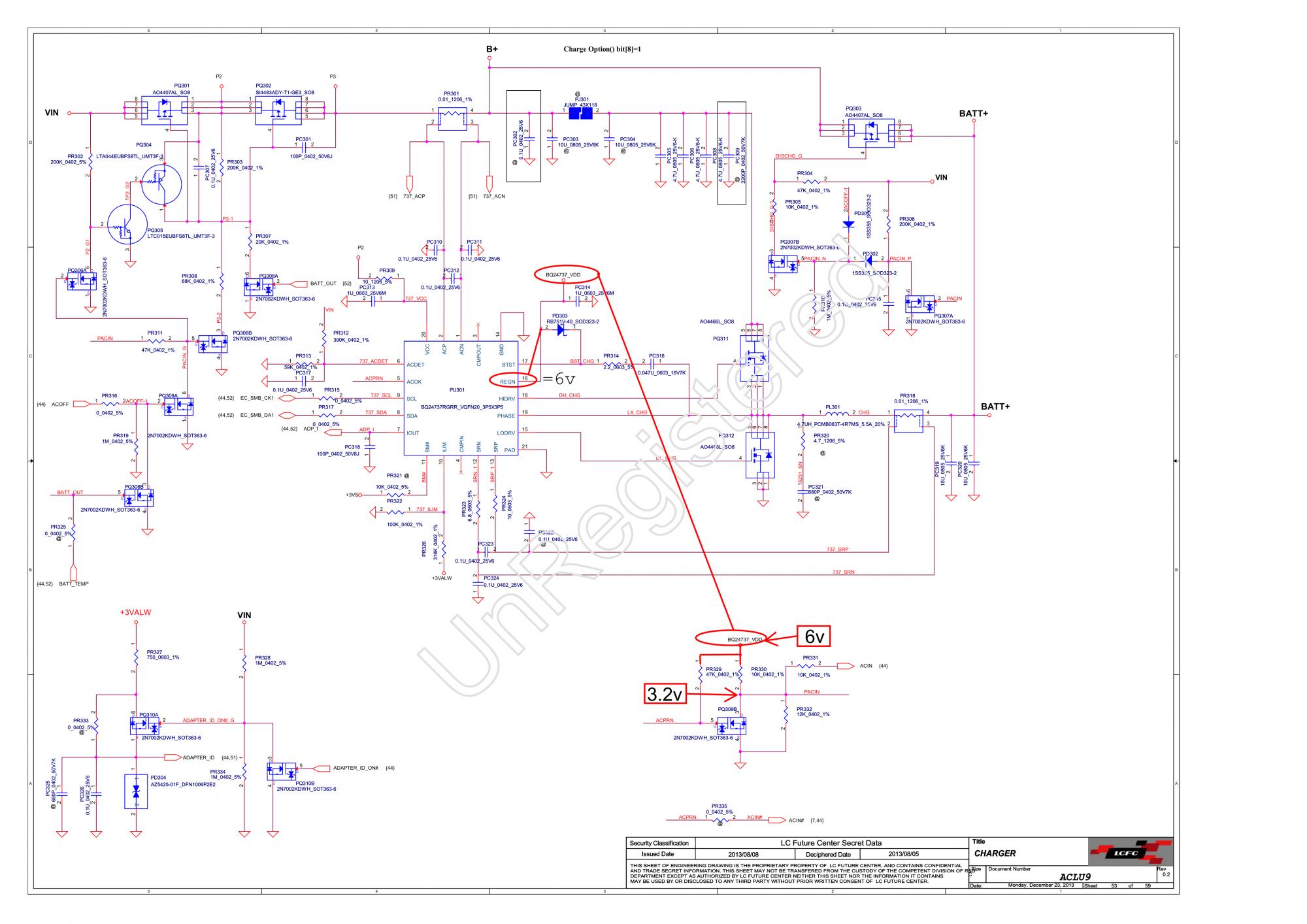

              voltage on pd303 pin 2 it's 6v (pin 16)not dc in , according to the schematic pin 16 should be connected also to the commun side of pr330 (10k) and pr329(47k),that mean you should find this 6v in the commun side of those resistor

                i hope that will make things clear .
