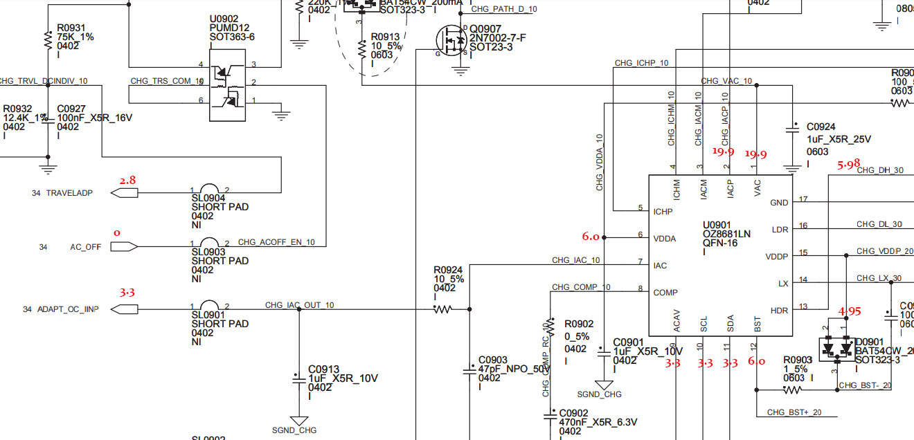

    You all have helped me in the past many times. So thank you
    I have this HP CQ43 motherboard which does not increase charge percentage at all. The status on windows it says"Plugged in charging" but the fact is it does not charge the battery. Upon investigation I found that the gate pin on the upper mostfect of the charging IC has only 6 Volt . I have changed the IC 0z8660ln with one from the donor board but the symptoms are still same. I believe the voltage should be around 12Volt for the battery to start charging the battery
    Also checked the signal AC_OFF to be low on only battery_only_mode and also in Adapater+Battery mode..
    I am having a hard time trying to figure out why I have only 6 volts on the gate of the charging mosfet [Q0901] .
    Please advise as it is kind of urgent.

        did u check voltages by that table on charger page ?

          Yes sir . Please see this attachment

                damn dude, u cannot read schematic?
                it issame as ac_off and AC_OFF u see in that table
                measure voltages on all pins of charger ic and wrote it to your image in battery+charger mode

                  Re: Please Help : Hp Cq43 Charging percentage does not increase
                  Here is the CHARGING IC DETAILS:
                  1. 19.42
                  2. 19.64
                  3. 19.68
                  4. 10.48
                  5. 10.39
                  6. 5.78
                  7. 0V
                  8. 5.71
                  9. 3.3
                  10. 3.3
                  11. 1.8
                  12. 10.75
                  13. 9.6
                  14. 9.2
                  15. 5.8
                  16. 0
                  OTHER Measurements :
                  AC_OFF = 0V
                  TRAVELADP = 2.8
                  ADAPT_OC_IINP = 0V
                  MEASUREMENT FOR u0902
                  1= 0V
                  2=0V
                  3= 8.8V
                  4=19.6
                  5=18.6
                  6=18.6
                  • Techtiger
                    • Oct 2014
                    • 1602
                    • france
                    Pin 11 DATA line Voltage is low this line pull down by 2.2K R123 3.3V trace it back first

                      Sorry PIN 11 is 3.3 . I must have typed it incorrectly.. Pin 7 is 0 volt .
                      • IamPritesh
                        • Aug 2017
                        • 356
                        • India
                        Its fixed now. It was a capacitor connected to the schotty Diode. THank you all of you
                            u mean C0905?
                            • IamPritesh
                              • Aug 2017
                              • 356
                              • India
                              It was C0909
