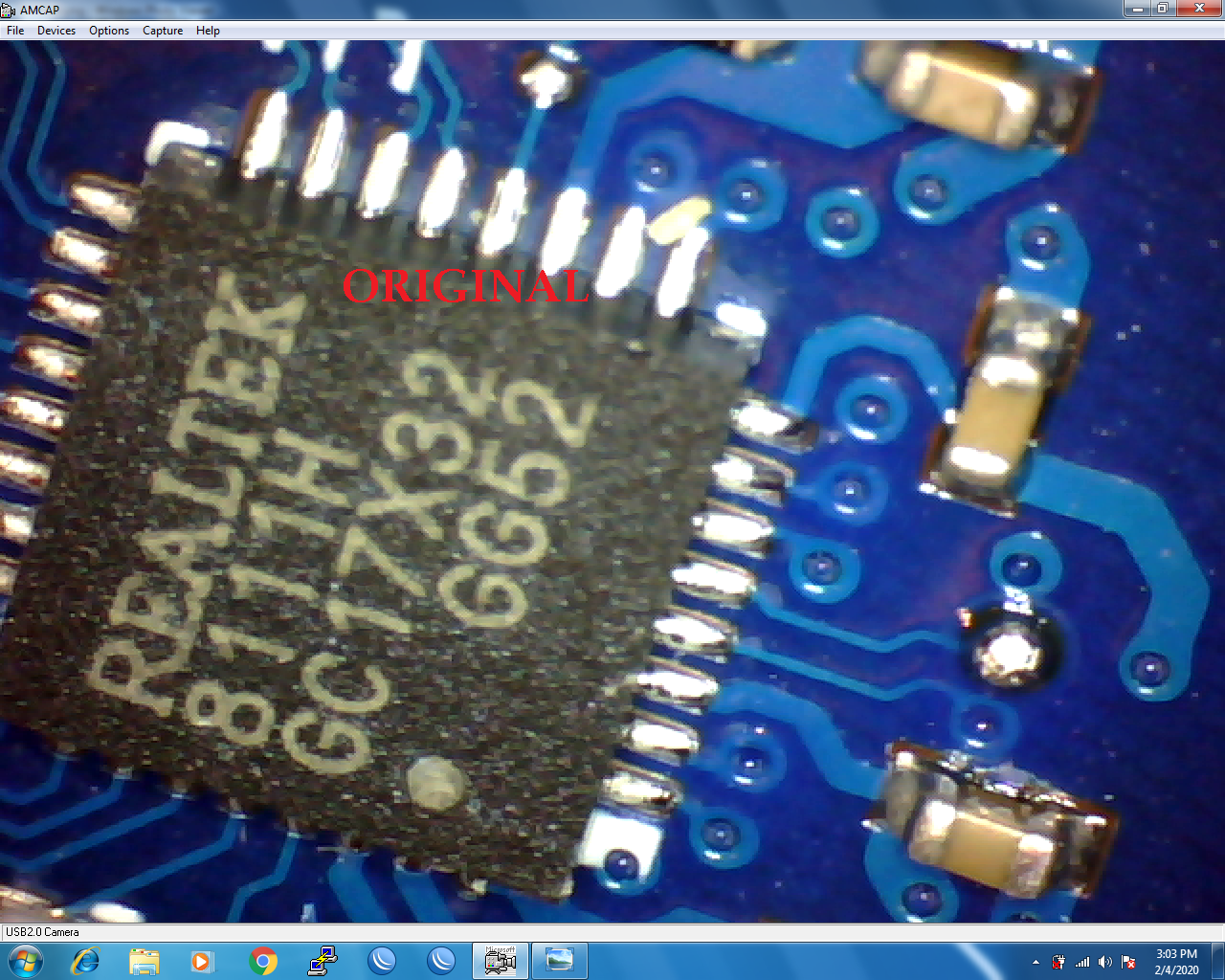

    Hello.
    Have this ACER ES1-531 that have not working usb. It have damagedUSB3.0 port that i replaced, but all USB not work. All have 5V. I removed EU3401 but no luck. How to test if U3501 is bad?
    what can be wrong and how to test it?

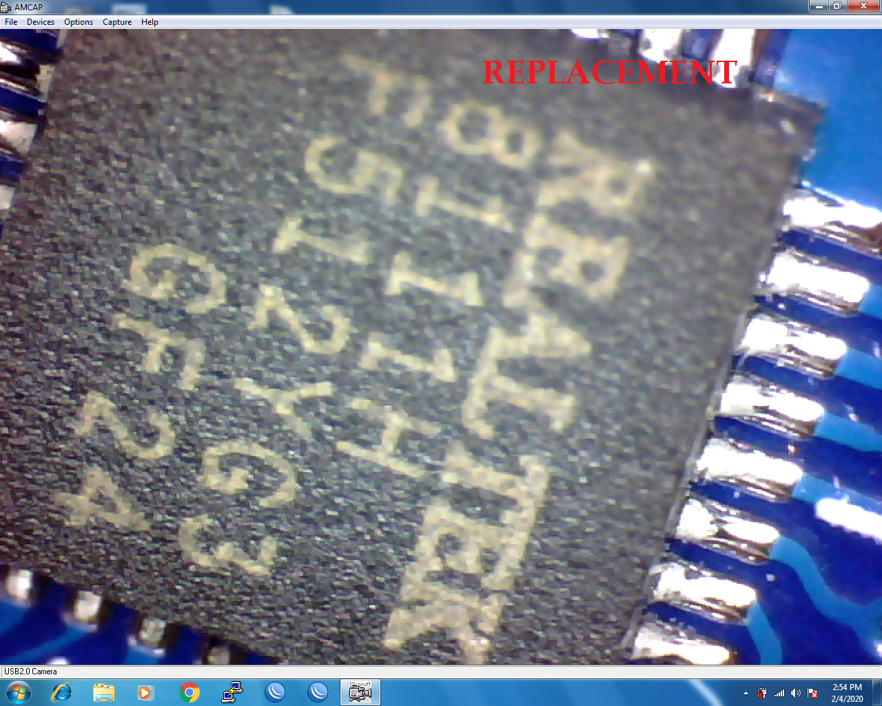

    i replace U3501 8111H with some other 8111H but no luck
    Windows shows error on xHCI USB controller

          do u think this two is compatible?
