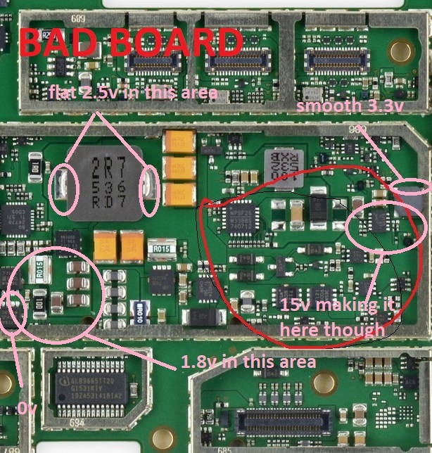

    Please ignore the red circle in the pics. I stole it from the internet.
    This board was pulled from a working unit and tested for a week before I sold it on ebay.
    It was returned saying that it "worked for 10 minutes and died"

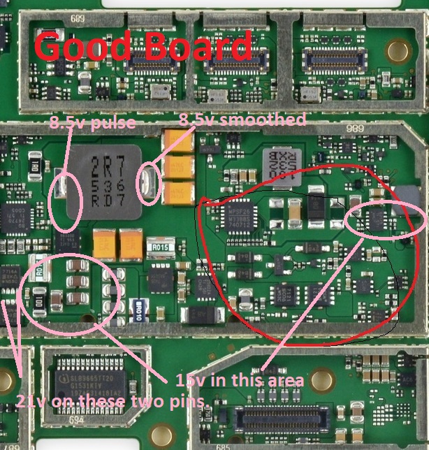

    I found the main 8.5v power rail to be 2.15v. Not shorted. Same diode mode reading as the good board.
    On the good board if you measure the coil with an Oscope you can see the 15v pulsation on one side of the coil and a flat 8.5v on the other side.
    On the bad board it is a flat 2.15v on both sides of coil, no pulsation. It seems like the full 15v is not making it to this area of the board for whatever reason and it's not even attempting to pulse the voltage.
    But right next to this area is the 3.3v standby rail area and it is working on both boards which also uses the 15v rail. I can see the 15v being chopped up into a smooth 3.3v, even on the bad board, so the 15v rail is present on the board but just not able to power the 8.5v rail.
    At least that's what my amateur brain is telling me.
    Not sure how to proceed since there are no schematics... Any idea of what could be happening?

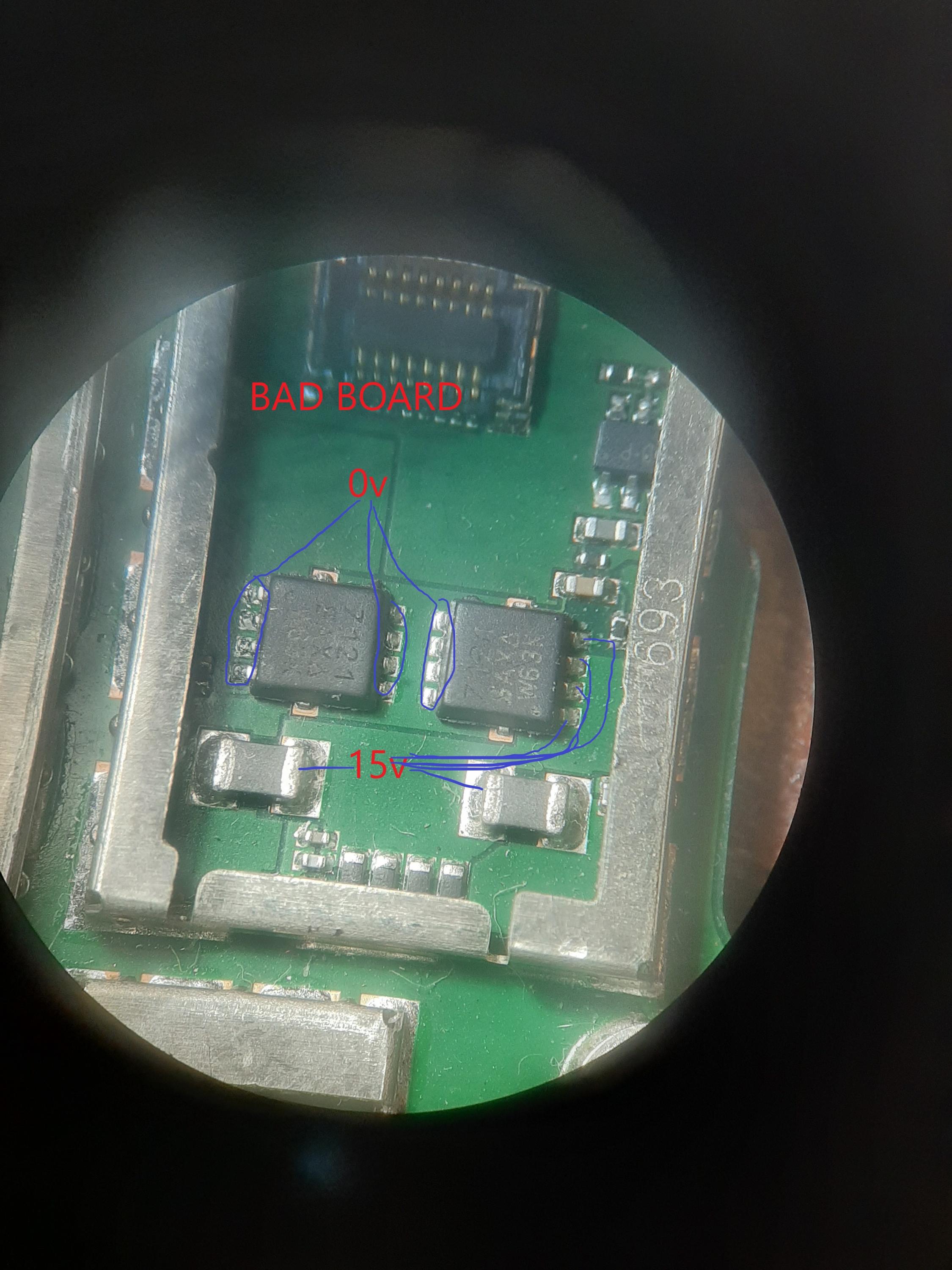

                Thanks for the PDF. I checked VCC and it's around 1.8v. Good board has 15v adapter voltage at VCC.
                This caused me to look elsewhere on the board to try to figure out why the 15v adapter voltage wasn't making it to the charger IC. I assume that they should almost be directly connected...
                So I found two more FETS that were under a shield that I had ignored earlier. These FETS appear to be the first stop between the charger and the rest of the board. I'm thinking this may be the root of my problem.
                On the good board, on the FET to the right, there is 15v on the source 5v on the gate and 15v on the drain.
                On the bad board there is 15v on the source but there is also 15v on the gate, and 0v on the drain. The FET to the left is all 0v.
                So I guess now I am trying to figure out why this FET isn't passing 15v. I assume because the gate is too high...

                  I see what's causing the 15v gate now.
                  The component labeled "DP" has something to do with controlling the gate.
                  The top center pin should have 3.3v. It is 0v on bad board.
                  If I inject 3.3v onto this pin, the gate drops to the normal 5v, and the FET opens. But still no main 8.5v power rail coming up.
                  So my guess is that 3.3v is missing elsewhere on the board too. I can measure 3.3v elsewhere on the board though, so the rail isn't completely down..

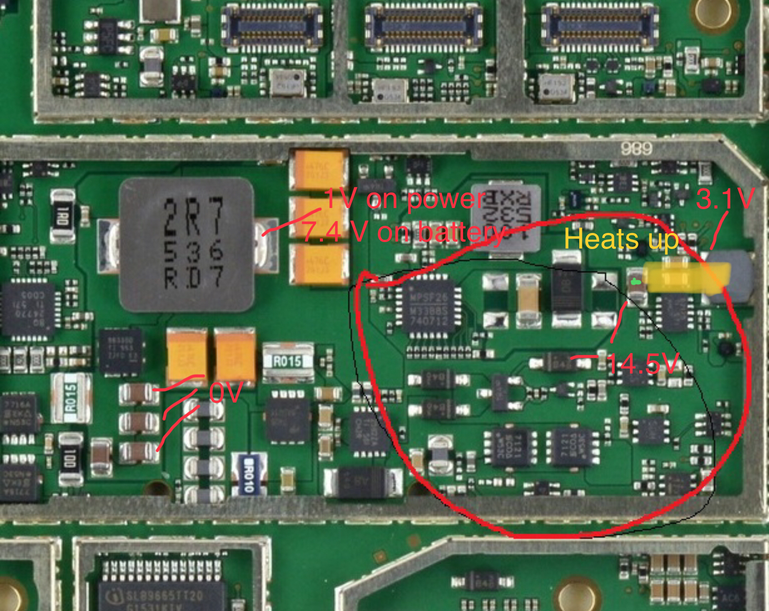

                          Very glad I found this thread. I got a surface pro 4 mainboard here with similar problems but know what caused it (me). I replaced the battery on this surface and got sent a faulty battery that didnt output any voltage. Trying to figure out why it wasnā€˜t working I probed around and accidentally shorted the taller capacitor (marked green) that is on the 15V rail. It smoked the diode close to it and possibly more.
                          I replaced the diode and now I am getting only 14.5V on the 15V rail when plugged in and the 3.3V rail shows around 3.1V which slowly drops. I am not getting anything around the FETs on the left or the capacitors.
                          The FETs on the charger input are in the same state as on mattpdā€˜s bad board. Also no voltage on the 3.3V pin of the ā€žDPā€œ component.
                          What I noticed is that in the area of the shorted cap the board starts to heat up when its plugged in to the charger. I marked it in the pictures.
                          Any suggestions are very welcome! Unfortunately I donā€˜t have good board to compare.

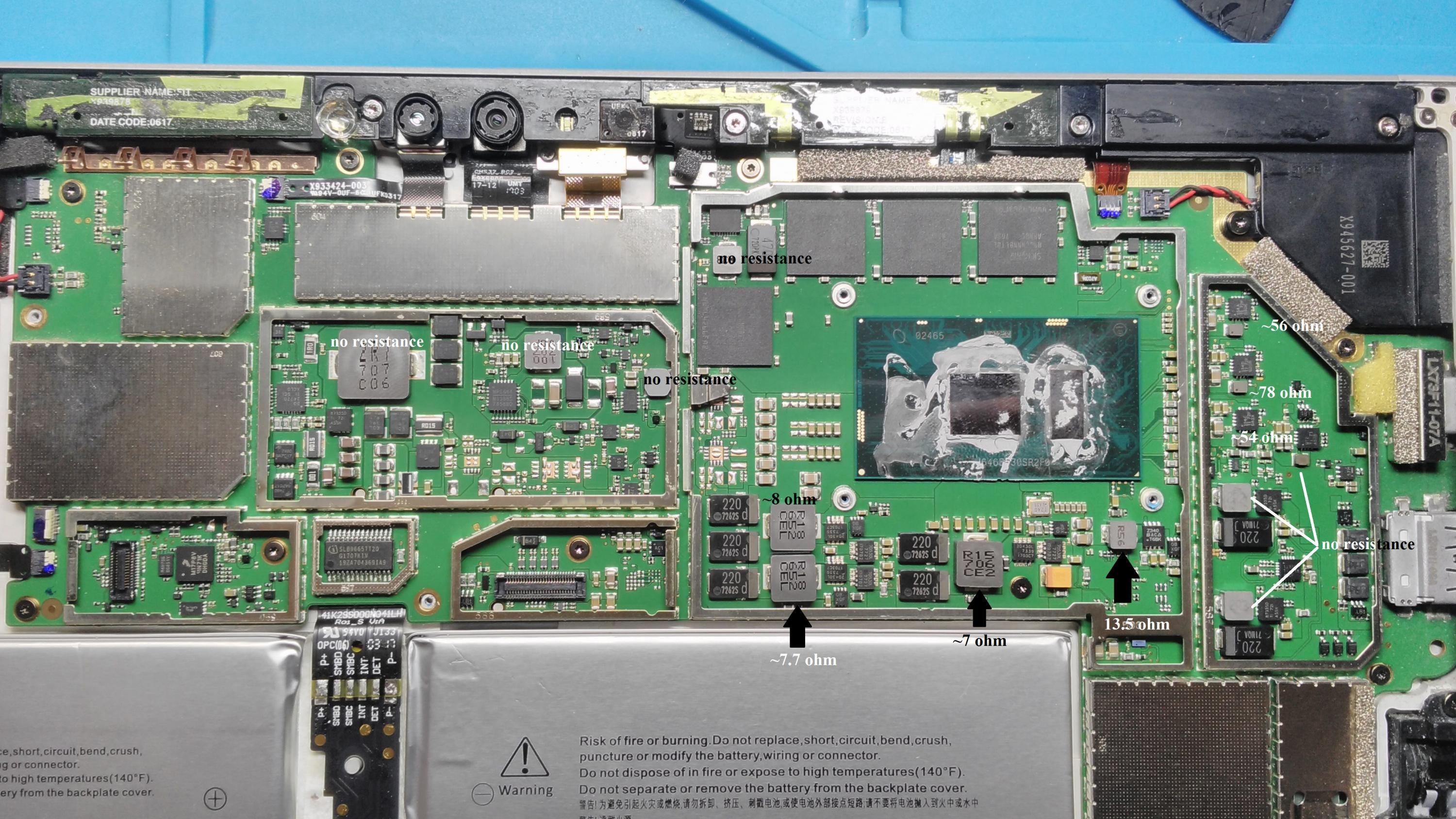

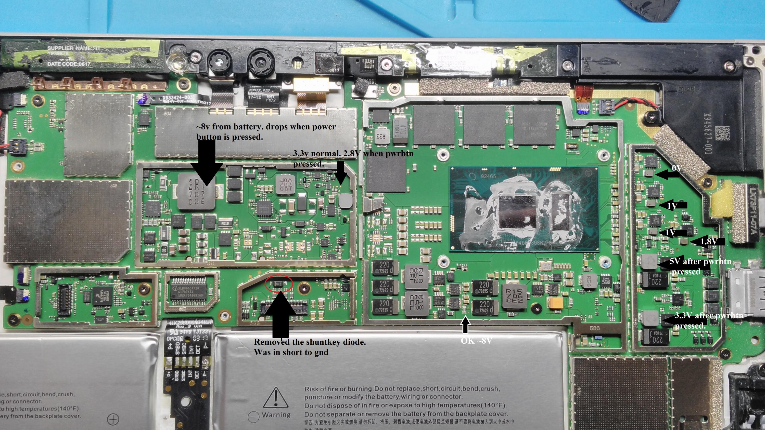

                                  Hello. I have one of these and I have ~8V from battery, I press the power button and 3.3V and 5V appears as in the photo below. But the main 3.3V becomes 2.7V. PCH is heating and other voltages aren't appearing. Ideas ?
                                  Also I have marked some of my measurements on photo.

                                      Re: Surface Pro 4 dead - Main 8.5v power rail is 2v - Have good board to compare
                                      Measured and attached a photo.
                                      Also I have removed the diode from below (near lcd connector) and I still have shord to ground and diode is good.
