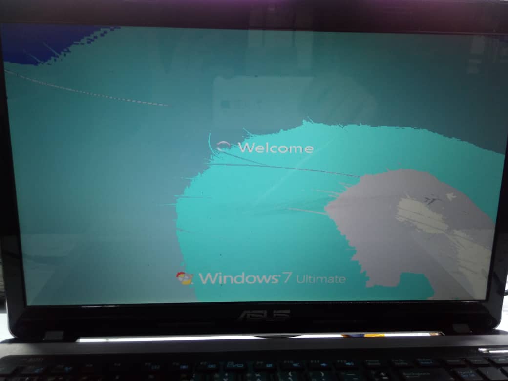

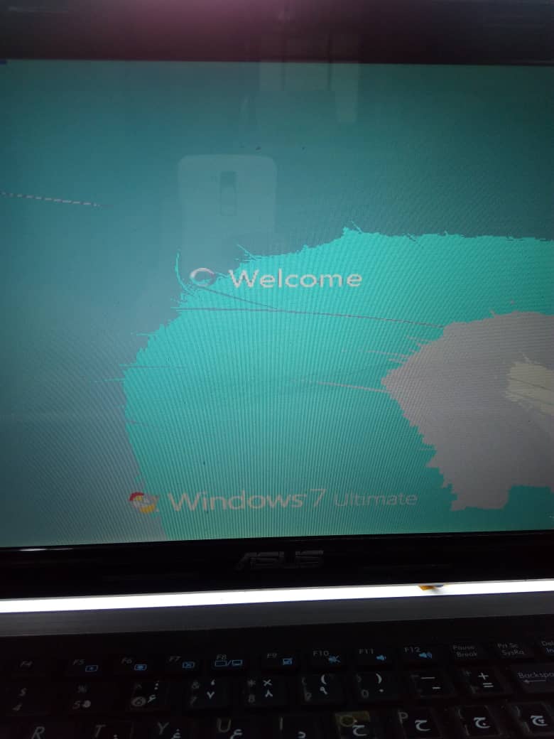

    Hi all.
    thanks to all of you guys this forum helped me alot (just by searching through the theards)
    i have this weird problem the screen looks distorted like in the pictures so i thought its the gpu, i replaced it with a new one and still the same. i get this problem on both internal display and vga (only vga and hdd and usb keyboard connected) in the device manager on intel hd i have a yellow exclamation mark but not on nvidia. any thoughts?

    Re: Asus K53sv Screen Problem
    Reinstall both NVidia/Intel GPU drivers. If it doesn't work, try another Windows installation. If still nothing, update the BIOS with the correct model.
      it has already happened to me, surely a wrong bios has been programmed, I advise you to look for a dump of the correct bios and reprogram it
        thanks for responding,
        i will try to update the bios tomorrow and share the result
          you were right i tried multiple bios files and finally i tried rev3.1 dump on this board and now everything is working... thank you
