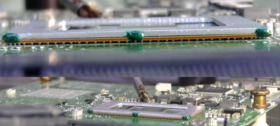

              Without knowing which cpu`s you exchanged how can we check if there were
              any incompatibilities between the "more or less same specs". The hypothetical SR170 and SR16Z shouldn`t have any problems exchanging,maybe apart from microcode changes to bios as KvnTM pointed out. The SR170 and SR16Z have the same ME firmware,pinout,ID,graphics (GT2).
              Changing the microcode can also be done with UEFITool, phoenixtool and hex editor with some bios
              EDIT: i don`t do reballing myself but i`ve seen some on some russian repair forums they`re using an aluminium frame to kep the SOC straight

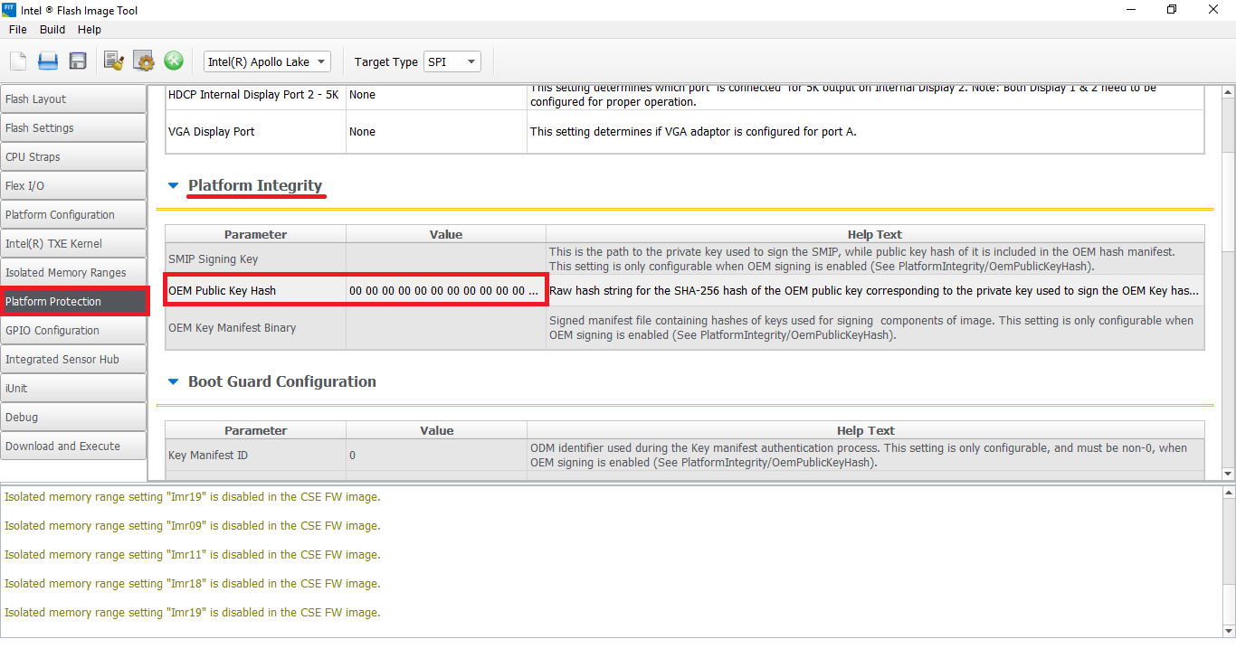

                        I also don't know how to identify a SOC has boot guard fused in or not but i think inspecting the BIOS with FITC tool may help in such cases. Load the BIOS dump in FITC tool and Go to "Platform Protection" and check if "Platform Integrity" section is present. If "Platform Integrity" section is present, check whether "OEM Public Key Hash" is non zero (populated). If non zero, then the firmware is signed by the OEM and their OEM Public Key Hash is stored permanently in the Chipset hardware. In such cases, SOC must be replaced from same donor board. Also the BIOS guard with signed OEM key prevents the BIOS from tampering. That is you can't hex edit the BIOS, update or replace modules etc. Doing so will invalidate the hash and the system may refuse to work.
                        Since new chip worked in your case, that Acer board probably won't have signed BIOS guard. I think this feature is not used in most of the low cost consumer grade devices. We may probably find this on business class models. Anyway since you do BGA work, may find this info useful someday.
