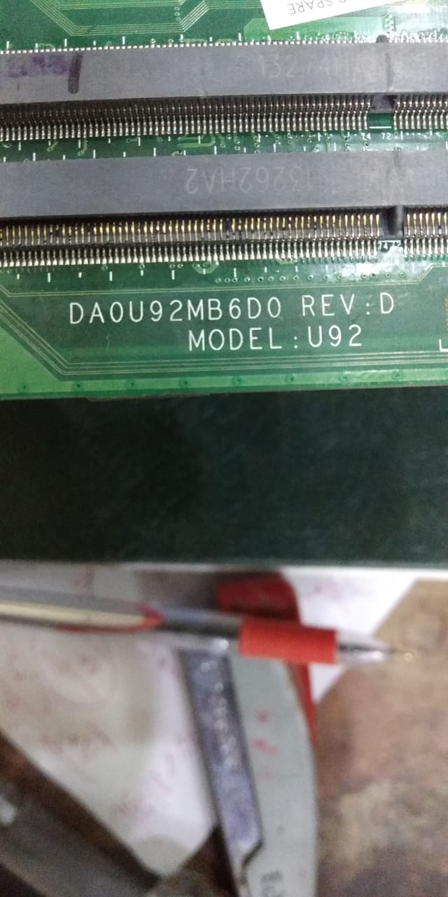

    i get HP Pavilion 15 with this board model DAOU92MB6DO REV: D
    it have abios password. and a kbc with number IT8528E.
    i programmed the only bios chip on this board with the correct file with no changes
    i found the ite file on the internet but HOW IS THAT POSSIBLE ?
    this ite (IT8528E ) is not programmable.

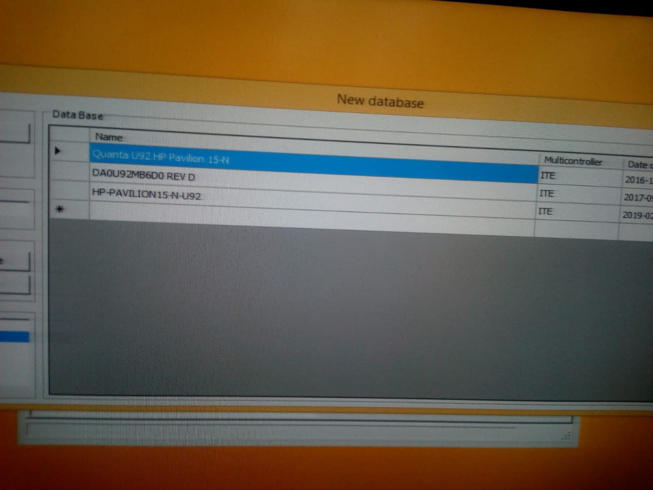

    and The most surprising.this platform and it,s controller have Support from svod team .
    the question now HOW IS THAT POSSIBLE ?
    and where the password store in this board.
    i will attach a photo from svod ver 1 online database.

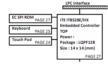

      Find the other spi chip also:
          there is only one bios chip on this platform

                Re: I am confused by IT8528E
                i leave it for a day after bios programming and the password disappeared
                thank you.
