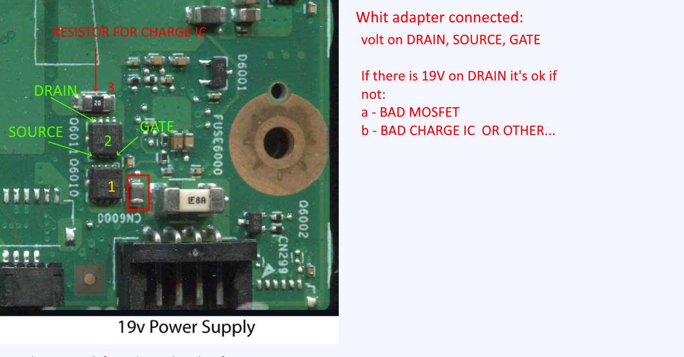

    I need help identifying a component.
    I am working on a Toshiba C70D-B-10N
    Motherboard is AR10AN-6050A2632101
    and the component is missing
    Fortunately, I found a picture of the board.
    Please have a look at the picture attached. Can anyone tell me what the component highlighted in red is?
    It is between the power supply fuse and two n-channel mosfets
    Thanks in advance

    Re: Please help me identify a component
    its the coil. smaller version of big grey cubes
          its just coil. winded wire, to filter. u can just jump it if it dont have 0ohm between pads. replacements is in every laptop board
                        There is 19V on Q6011 ?
                        • vtfe
                          • Sep 2017
                          • 35
                          • france
                          Ciao jasko,
                          Q6011 reads 3,62V
                          Q6010 reads 19V
                          The little component between the two mosfets reads 19V on one side and 3,62V on the other side.
                          See picture below.
                          What should I test now?
                          • mcplslg123
                            • Jun 2015
                            • 7262
                            • india
                            remove that resistor after Q6011 and then apply power, recheck mosfet readings for Q6010/11
                              Hello mcplslg123,
                              Sorry to be a complete noob, but I need to clarify.
                              I would have assumed that it is the component between the two mosfets that was to be tested next - marked "2" in picture below.
                              But from what you say, the "resistor after Q6011" seems to be the component marked "1" in the picture below.
                              Which should I remove for tests: 1 or 2?
                                mcplslg123 mean to remove the resistor (number 3 in my pics) to isolate the two mosfet but before to remove it try to measure the voltages as I explain in pic
                                    Here are the values in volts with power adapter plugged in:
                                    Mosfet Q6010: Drain 19.15 / Source 3.62 / Gate 3.62
                                    Mosfet Q6011: Drain 3.62 / Source 3.62 / Gate 3.62
                                    FYI, the mosfets on my actual mobo are "E070BN"
                                      except for the Drain of Q6010 (obviusly) the other voltages are bad, at this point usually I remove and test the mosfet or remove the connection from the charge ic to gates .
                                      It's possible to test mosfet with simple but inaccurate method:
                                      Multimeter on Diode, for every mosfet :
                                      Q6010 -> probe + on drain and probe - on source -> write result
                                      - on drain and + on source
                                      Q6011 -> probe + on drain and probe - on source -> write result
                                      - on drain and + on surce
                                      (this method works only if the mosfet are in short and not in on state)
                                      I don't think that there is a short on resistor 3 but you can check it
